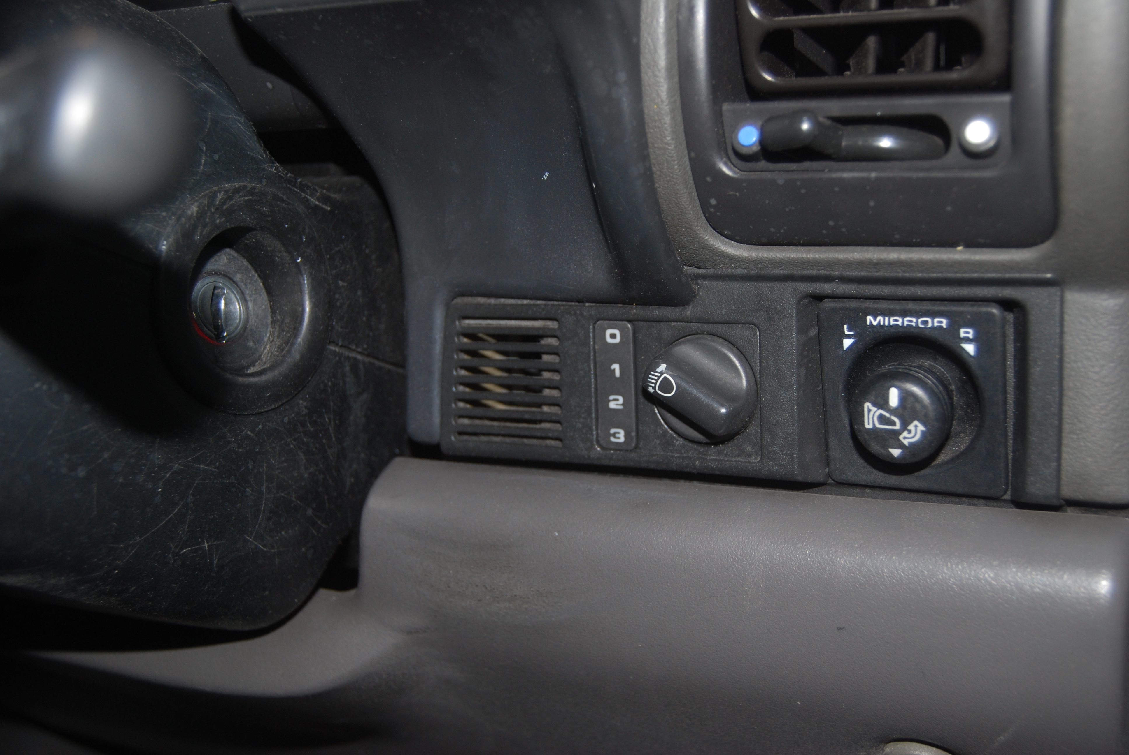

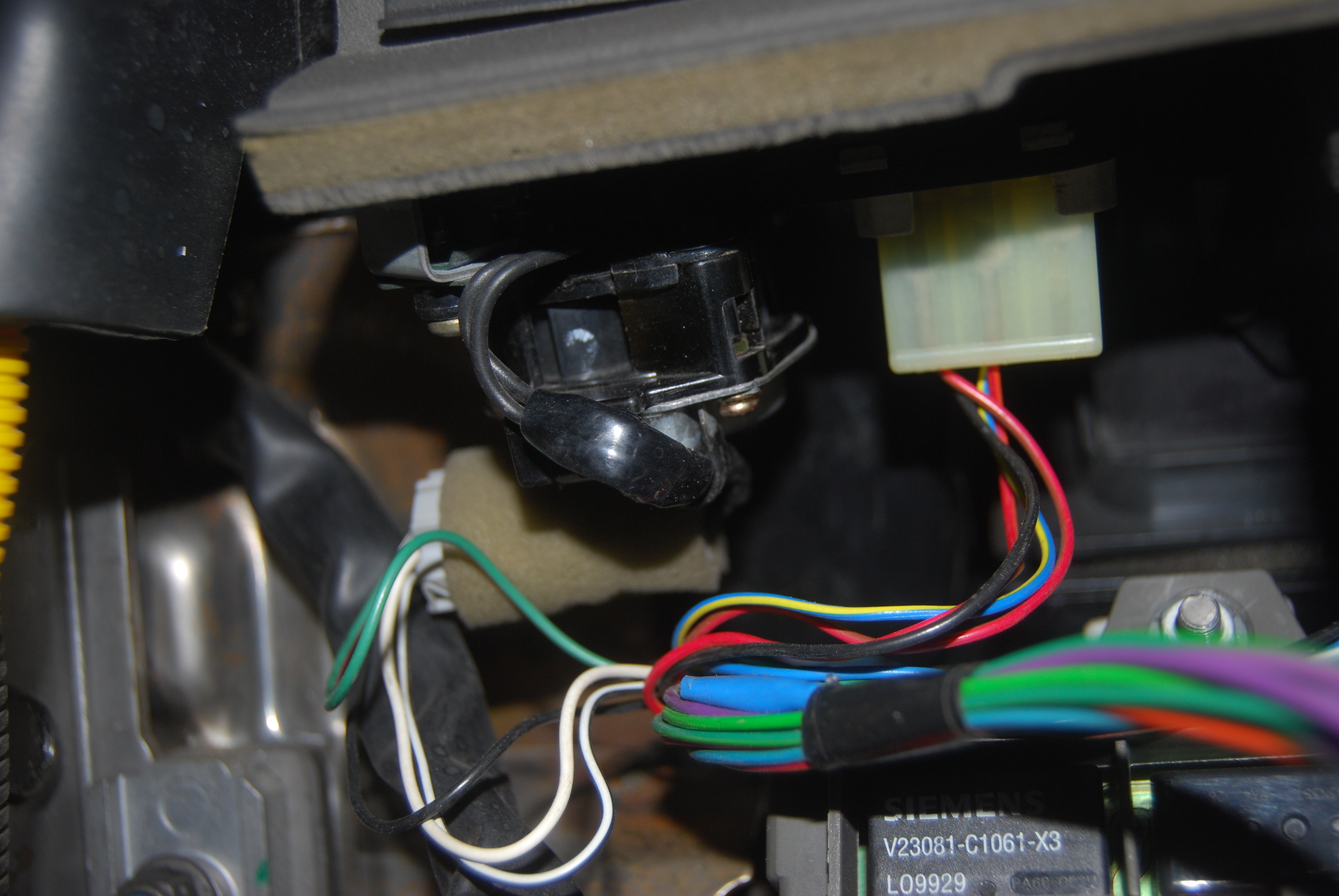

Over time a number of members have asked about the whirring sound coming from behind the dash to the right (In RHD cars will be from left for LHDs) of the steering wheel below binical, here to be exact.
Photo 1.
Behind the grill this fan is fitted
Photo 2.
While it will never be absolutely quiet you can help by giving it a clean. this will also make it operate better as the temp sensor will be more effective if clean.

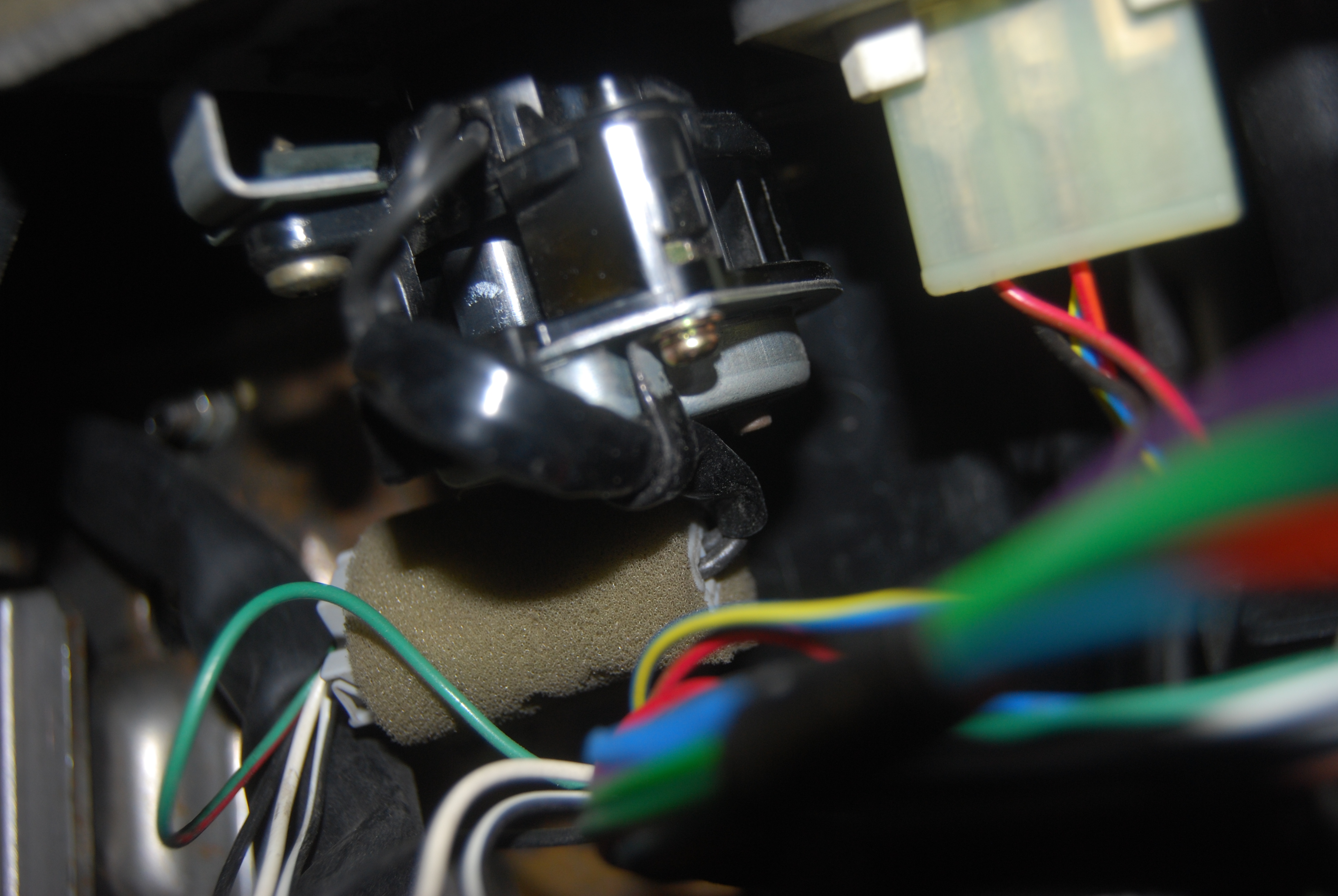

1. Open the fuse access panel below the steering wheel and you will be able to see the fan unit. (bear in mind that yours will be the opposite hand as mine is RHD)
Photo 3.

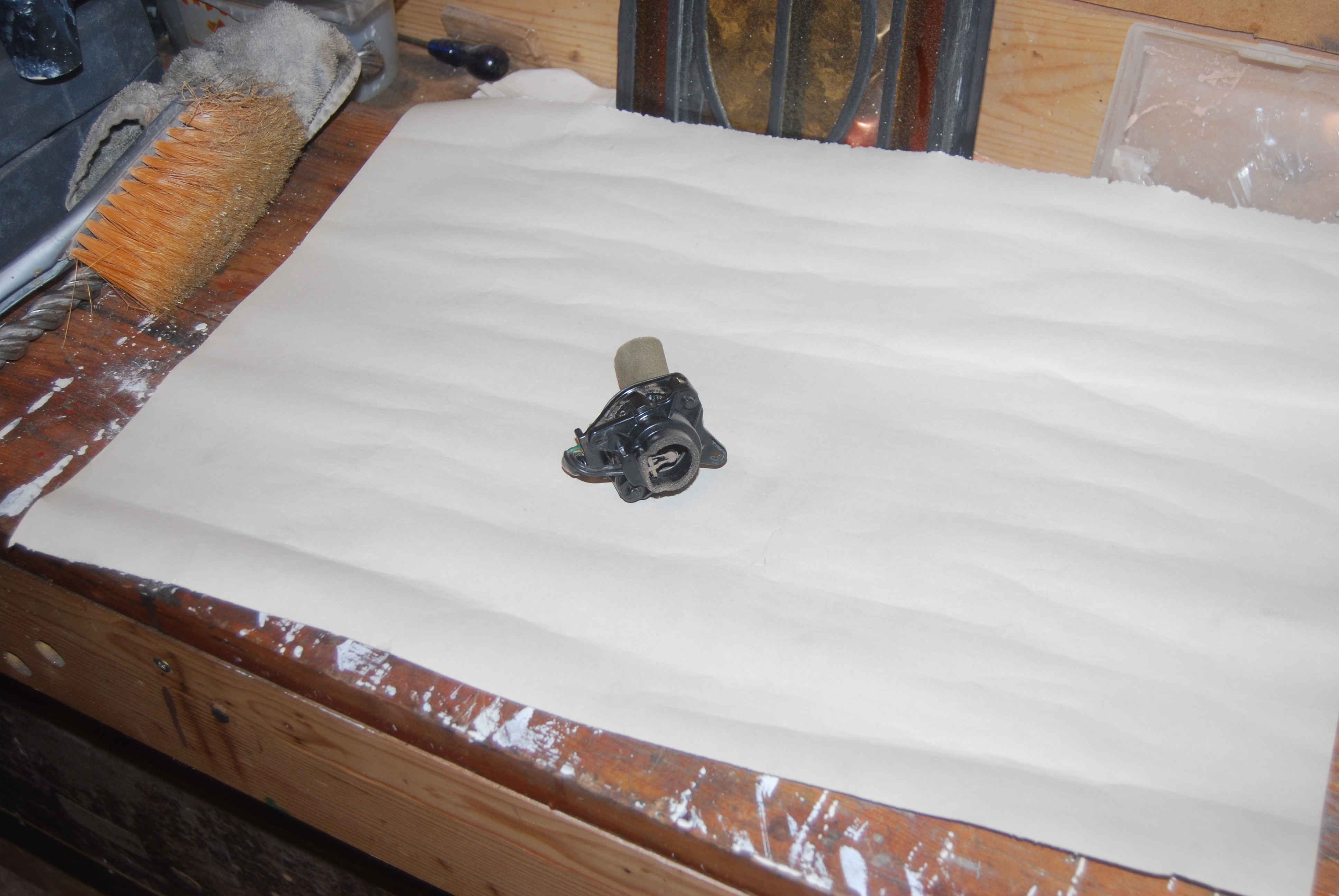

2.Remove the unit by taking out two screws, one show above. Not the one in focus, but the other to the left.
Photo 4.

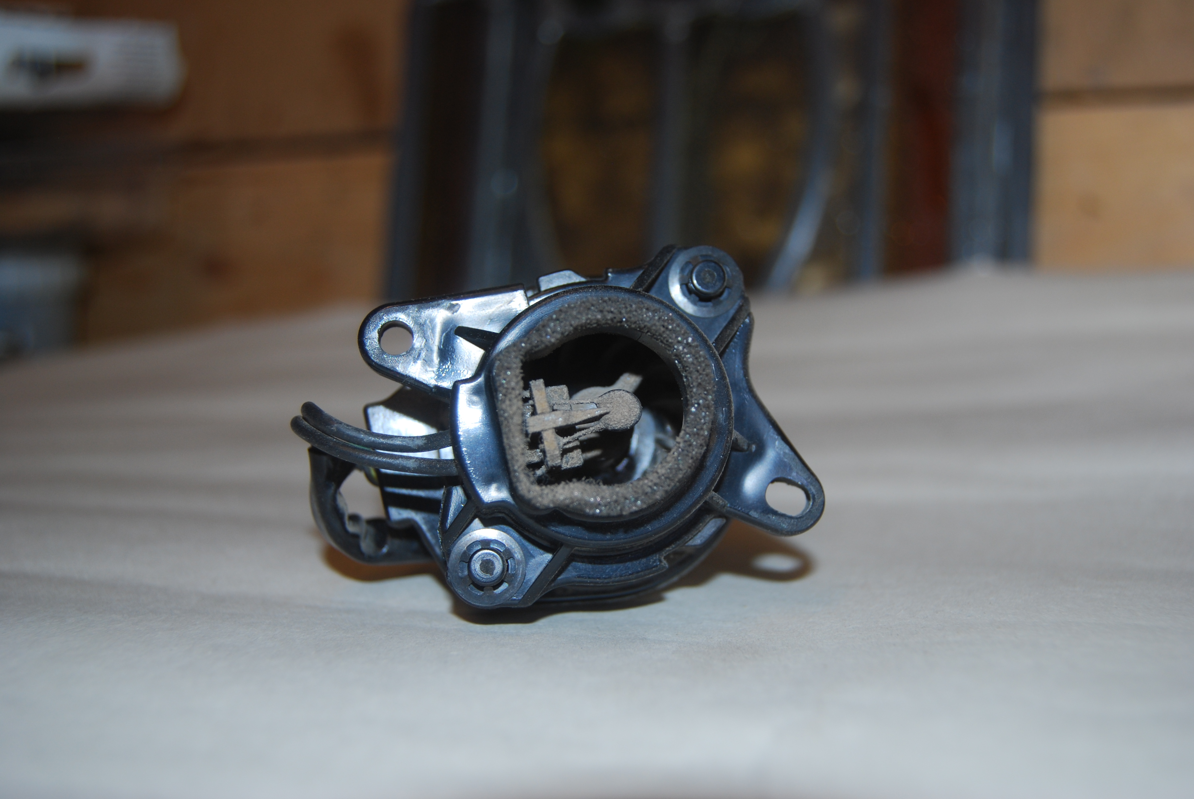

Now the extent of dust contamination can be seen. This is mildly dirty, I've seen others that were completely clogged with dirt.
Photo 5.

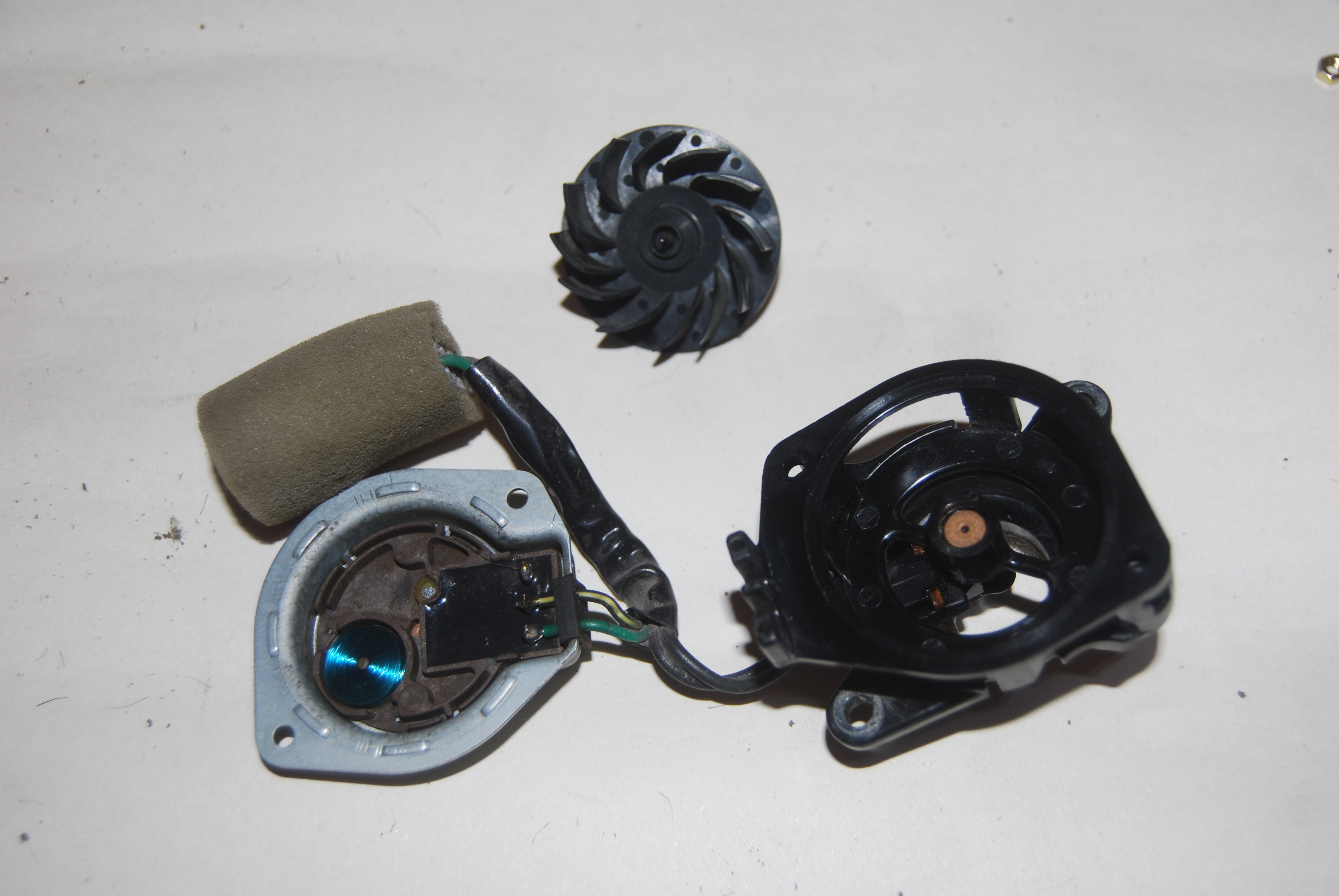

3. The unit can be opened and dismantled by removing the remaining two screws and the components cleaned
Photo 6.

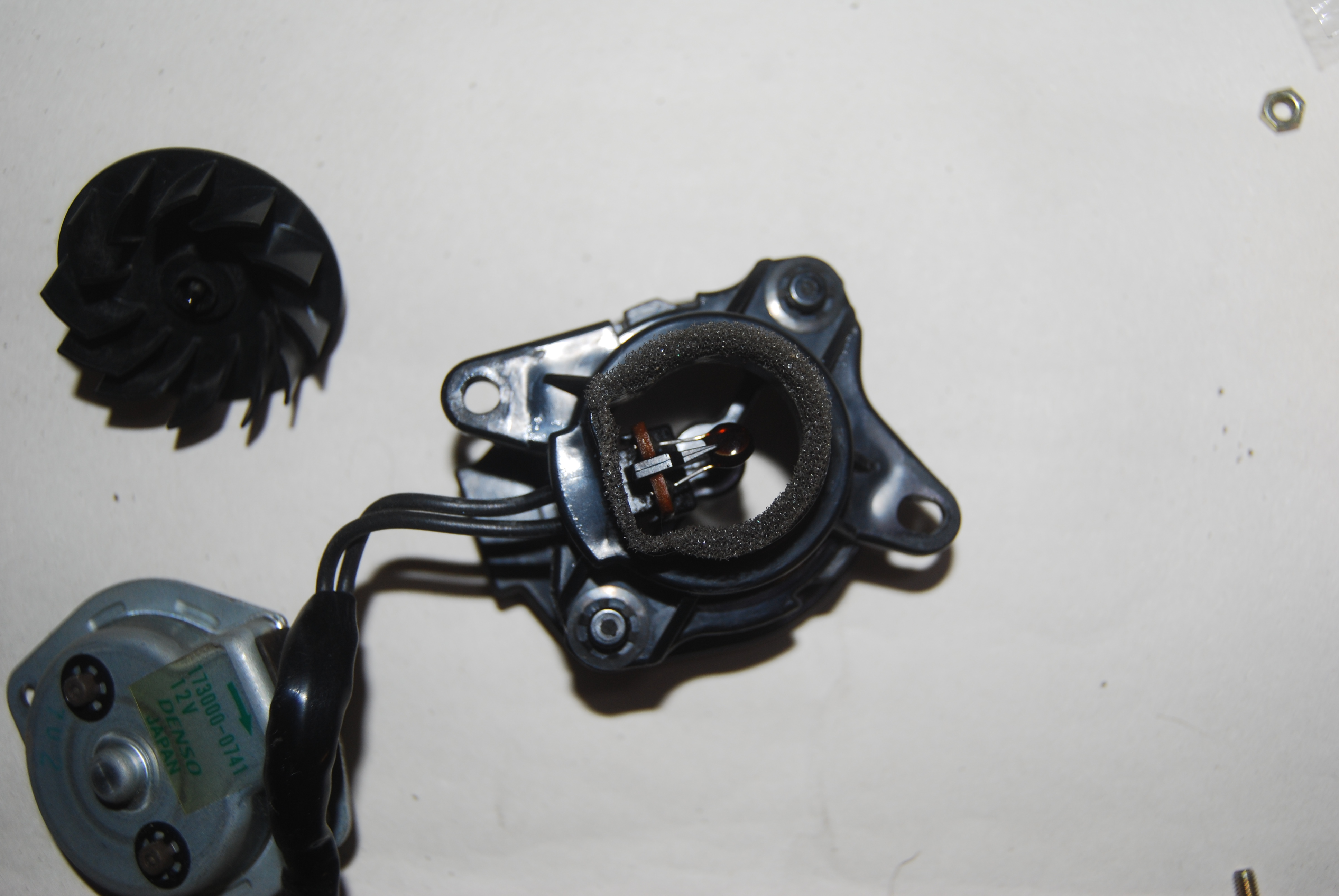

4. Nice and clean ready to reassemble and refit.
Photo 7.

Thanks for the write up there @Alphamale - hoping to pop it out today and take a look. will post back the results...
Old Jan 17, 2016 | 12:34 PM
Alphamale's Avatar
Posts: 256
Likes: 51
From: Belfast, N. Ireland
You're welcome, hope you have small dexterous hands, otherwise it's a pig to get at the top screw.
