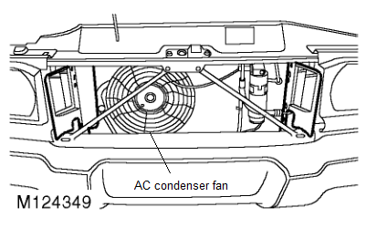

AC Condenser Fan aka "Aux Fan" / 'Auxiliary Fan': Troubleshooting, Removal, Repair
2004 Land Rover Discovery SE
Newbs: fan location = front most of truck, directly behind the front grille. It cools the air conditioning (AC) condenser (the front most 'radiator' looking thing). There are two fans. This is not the 'clutch fan' which is run by the serpentine belt at the front of the engine which cools the engine coolant radiator, located just behind the front most AC condenser unit. The AC condenser fan, the aka 'aux' fan, is bolted to the front of the AC condenser.

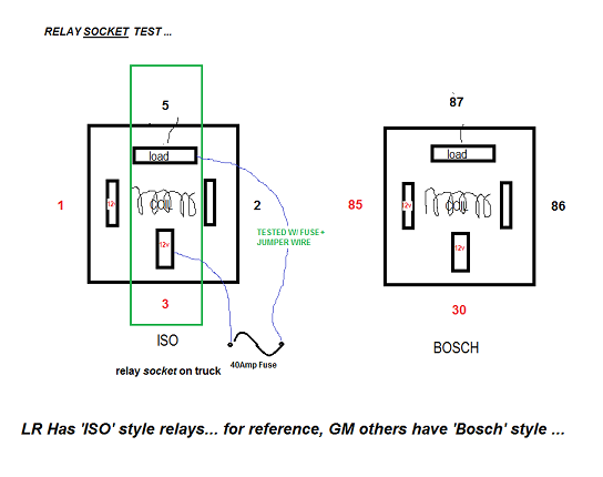

II. So, since replacement fuse test not blowing immediately / no 'smoking gun', I figure let's bypass the ECU which controls the AC condenser fan activation per specific temp and drive cycle (heat) parameters. Methodology: let's use the Dr.'s office rubber mallet to strike the knee tendon (relay socket) and see if the foot moves (fan spins up) w/o the brain (ECU) being involved. The R4 relay socket is the best place to test since it has the 'most "central" strategic position' within the entire fan activation circuit.
To do this, let's activate the relay manually (relay "R4" in the engine compartment) and see if the fan runs.
How? Use a test jumper or wire bridge applied to the R4 relay. The jumper test wire is itself fitted with a 40amp fuse per best practices / common sense.
Jumper test wire setup: Looking at the pins on the relay itself, I know the magnetic induction or mini-coil relay 'trigger circuit' in the relay itself are pin sockets 1 and 2 per industry standards -- so I DO NOT want to jump those pins since it's the trigger circuit, not the device (fan) circuit, per industry agreement. The other set of pins on the relay which are in the 'load' or 'switch' or 'device' circuit (in this case, the AC condenser fan), are pins 3 to 5 as they are on all "ISO style" relays (or, equivalently, pins 87 - 30 on a "Bosch style" relay). So, I know that THESE pin sockets -- 3 to 5 -- are the pin sockets in the fusebox array that I want to carefully and thoughtfully 'jump' or 'bridge together' for testing.
Test: Relay R4 removed pulled from truck and set aside. W/ truck running, applied an in-line 40amp fuse jumper wire to relay R4, specifically, sockets 3 - 5 (which correspond precisely exactly to pins 3 and 5 on the relay module itself). Caution here. Go slow, be careful, THINK through exactly what you are doing -- or don't do it.
(So, to my knowledge, my jumper is simulating a closed aux fan (condenser fan) trigger circuit, namely, it is a stand-in for the magnetic induction of relay pins 1 and 2 ... I'm forcing the trigger, relay pins 1 - 2 to a closed position. I'm manually closing the device (aux fan) activation circuit, I'm the trigger instead of waiting until the ECU takes it's sweet time to activate this circuit per it's pre-programmed parameters (a certain temp, a certain drive cycle state, ... ). My jumper IS a closed, activated relay trigger doing it's job when it finally gets called out by the ECU at high temp and/or w/ the AC on or ?. I don't care about all that now. Point is, I'm not just waiting around for the ECU to decide to do it's thing and activate the relay. I wanna know right now what the deal is with the AC condenser fan!. Worky or no worky? No one taught me this. I simply thought about it)
Test Result: w/ truck running, 40amp in-line fuse jumper wire across relay R4 pin sockets 3 - 5 .... drum roll ... the jumper wire fuse blew instantly.
OK. Slowly drawing the net tighter here. So now I know for certain it's either a WIRING short-circuit in the wires of the device circuit of the AC condenser fan, OR, it's a short-to-ground inside the fan motor itself. It can't be anything else.

**AC condenser fan removal notes:
After taking off the grill, watch that the plastic grommets on the fasteners don't fall away into the front of the truck as you're pulling away the grill. I heard that happened to a guy somehow somewheres once a while back .
Pre-soak the fan frame fasteners -- (4) 8mm bolts -- with a penetrating oil such as PB Blaster. Threads of mine were nicely rusted / crusted. (These four fan frame bolts are also phillips head (posidrive), but they are useless/inaccessible as such -- even with a right-angle phillips driver -- it's far too cramped in this space to get a good bite on the these small crusty fasteners with a screwdriver.)
When you're facing the truck, the UPPER RIGHT 8mm bolt on the AC condenser fan is hopelessly buried behind the hood latch receiver body -- it's quite happy in its hidey hole, and it hates you. So, you need an 8mm ratcheting box-end wrench to get at it. No problem at all w/ the right tool.
Use a 1/4" ratchet fitted w/ an 8mm 6 point socket for the remaining three bolts. Use a swivel (aka "universal joint") on a 2" or so extension since you can't get straight at any of these three bolts (upper left, two on the bottom). Put duct tape or gorilla tape around the swivel so it doesn't flop around in blatant display of rebellion and uselessness. Tame that swivel.
Remove one of the crossbars bolts on one of the crossbars and push the crossbar it aside to open up a gap through which the fan can be removed from the truck. Don't lose the crossbar bolt. Mine dropped into the front bumper. Magnetic telescopic grabber tools are both cheap and awesome.
Re the fan 12v connector, slide a small flathead screwdriver under the bow of the connector interface to depress the tab on the connector body, and it will easily slide apart. Bench test the fan.
LRD2 AC condenser (aux fan) relay socket test for short to ground
