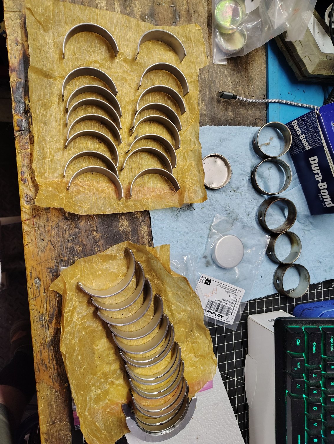

What is the point of having two holes() instead of just the one on the cam bearings? Specifically, the first two bearings, the rest are one hole.
Old bearings, all with one hole..........
New set with two holes on bearings one and two only..

They're camshaft bearings, smallest of the bunch and one piece.. Crankshaft bearings are much bigger and they are also split...
The bearings Familiga........

Maybe they are built to fit several different vehicles?

Its the brand. Pretty sure I remember seeing LS cam bearings that use only one oil feed also come with two holes in the bearings.
Line them up like the OEM came out. I marked the block with sharpie as well as cam bearings to help guide them in properly aligned.
If those are not pre finished you'll need to take the block to a machine shop for finishing before the cam can be installed.
If it's warm outside you can freeze the bearings and they'll drop in a little easier. Must be put in dry, block also needs to be extremely clean and degreased.
If you want to avoid machine work Turner engineering out of the UK sells pre finished cam bearings for a great price.

They're already to spec, I hit them with a micrometer just to be sure.
Wanted a second opinion on the holes before I started whacking em' in there, lol. Replacing the cam as well.
