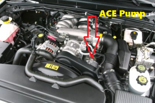

Can anyone tell me what this is... or if I broke it...

I’m not 100% sure but I took my intake out and when I was reinstalling the intakes I saw this but I can’t find any parts inside the Engine bay...

That is where the ACE pump would be if you had it fitted as an option(you probably dont)
There should be a plastic "cover" type thing that would float over that area that is about 10" long, and is concave to cover the belt if you had ACE installed, but a lot of those have been chucked at this point
