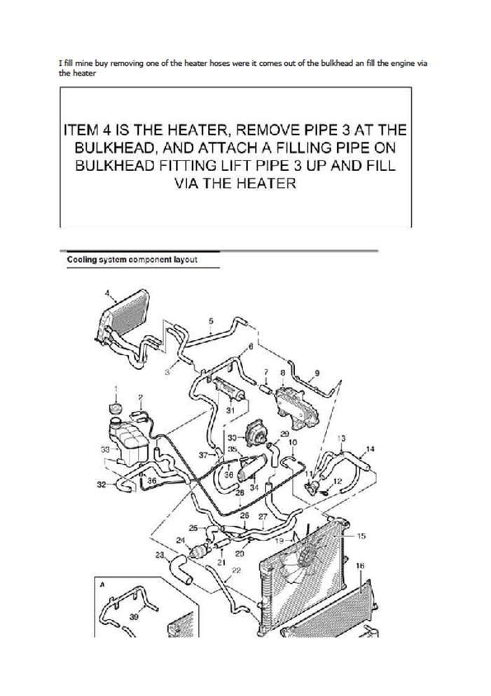

Old Jun 28, 2024 | 04:54 PM
frostythor's Avatar
Joined: Jan 2020
Posts: 374
Likes: 122
From: NEW FOREST, UK
Try this
