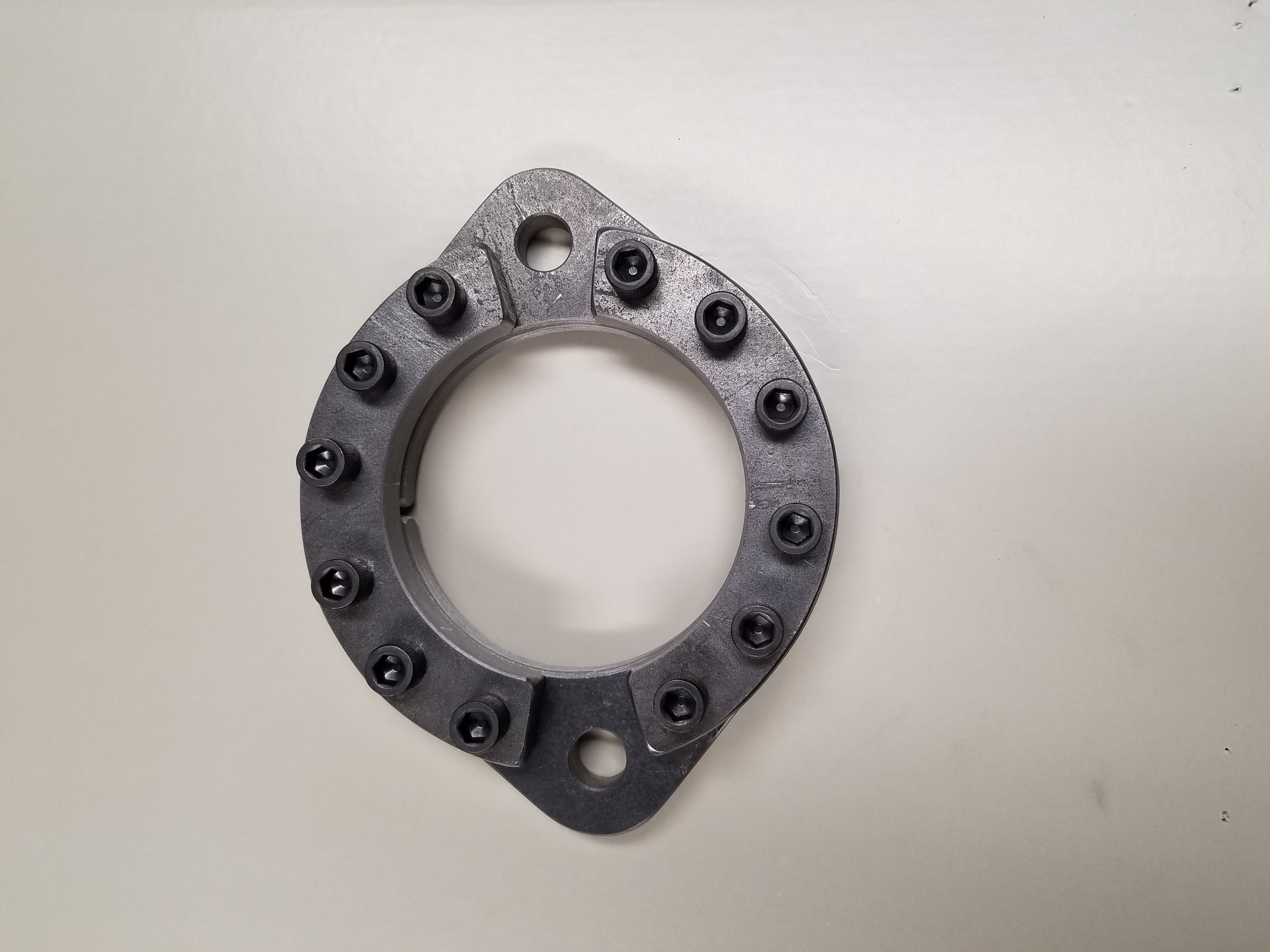

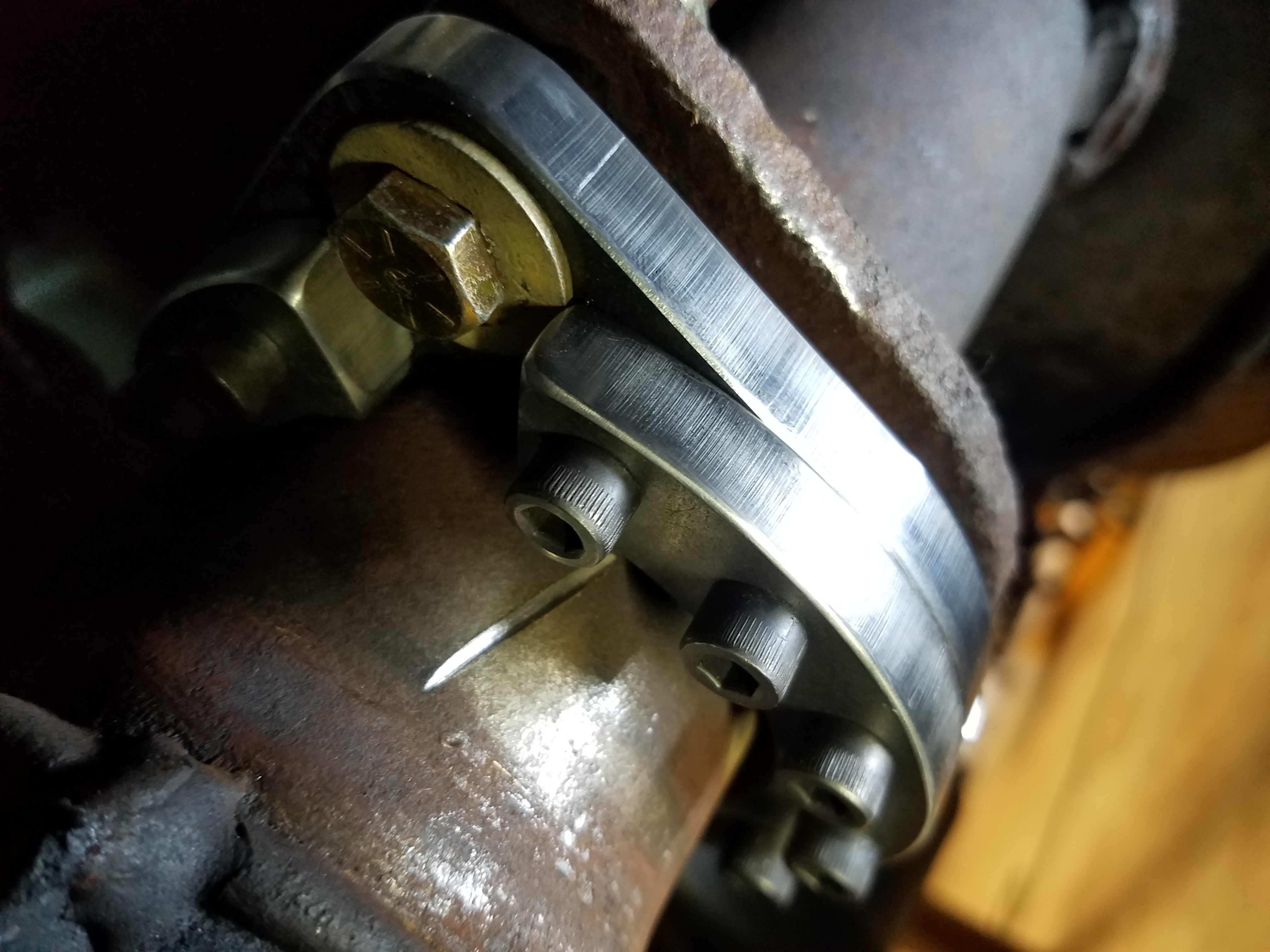

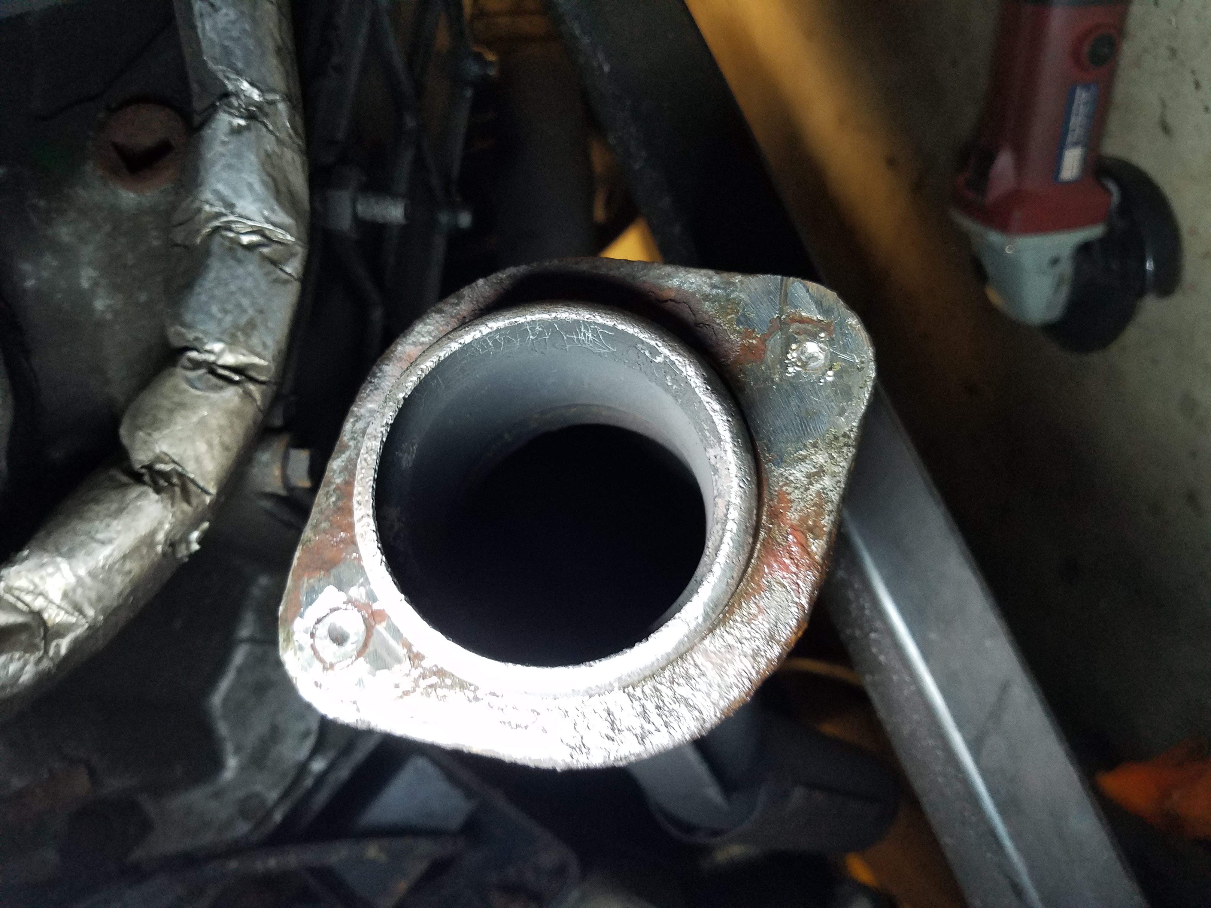

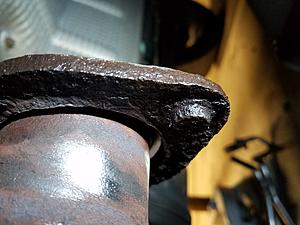

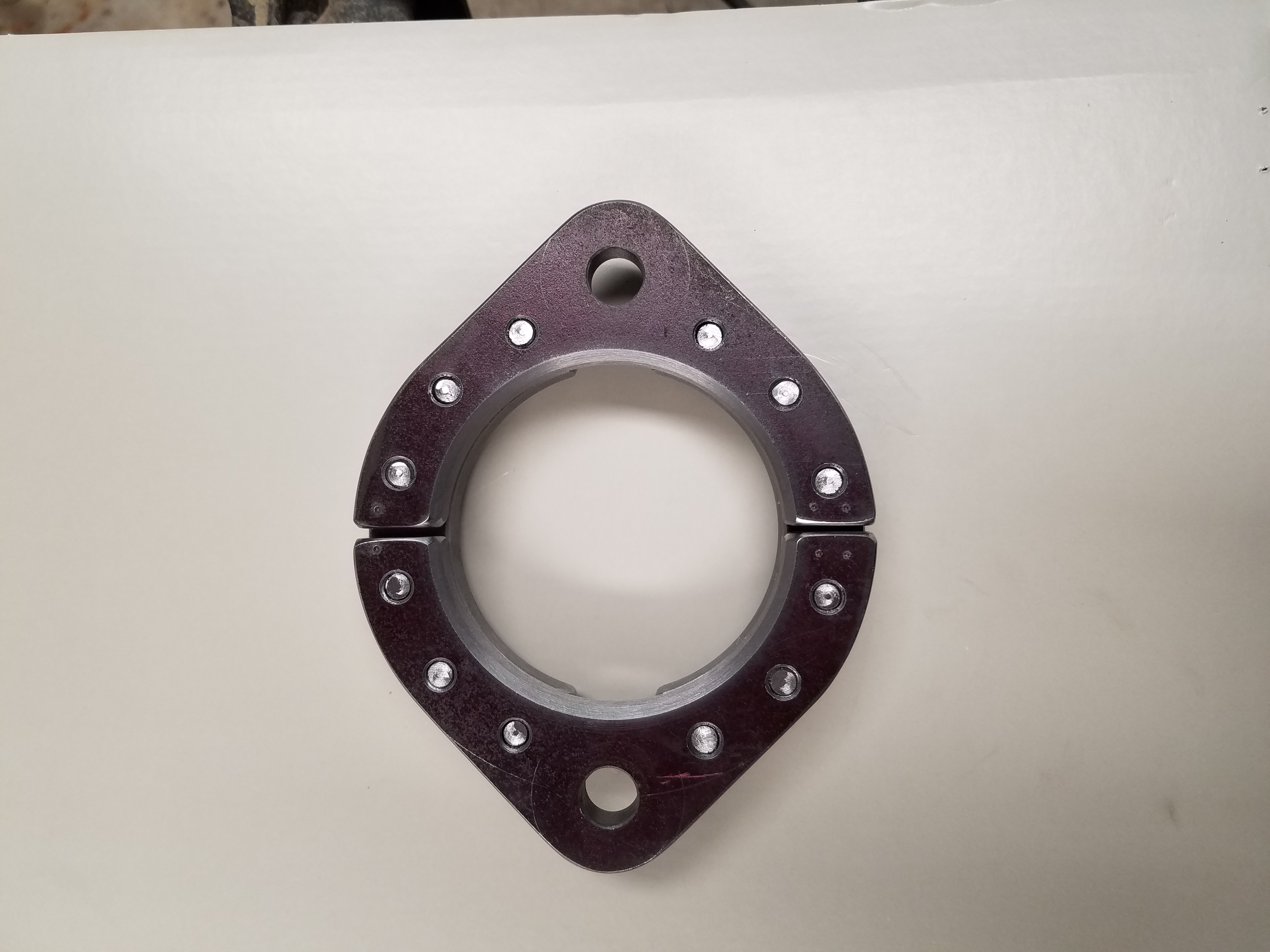

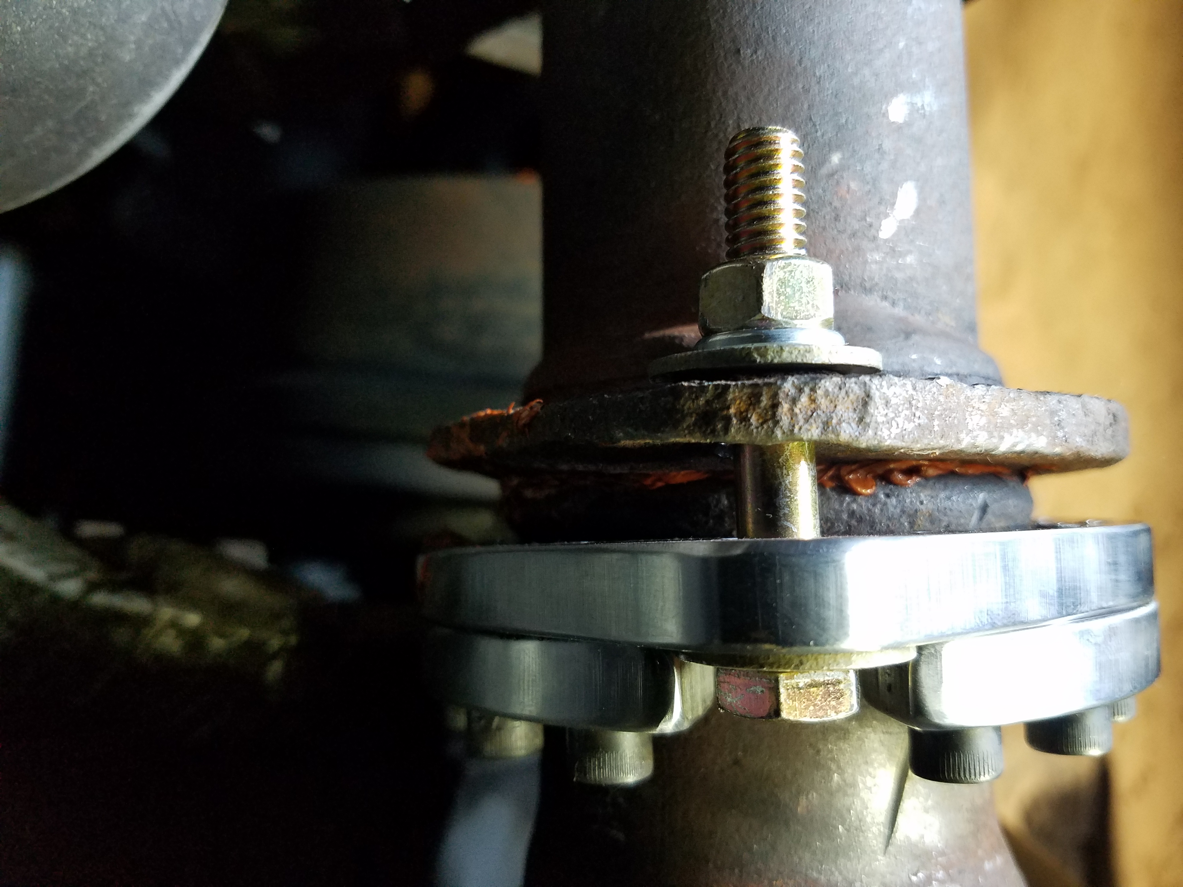

My exhaust was leaking at the coupling in front of the muffler (ball and socket joint, requires no gasket).
One of the bolts was corroded through. Or what I thought was a bolt. Turns out mine had studs.
Studs in the flange on the catalytic converter pipe, and they had to have been factory.
Every diagram I see, factory and aftermarket shows through holes for bolts in that flange, which is how it should be.
Does anyone else's D2 have studs there?
I tried cutting, grinding, drilling, and broke 2 carbide bits trying to get them out, to no avail.
My Dad is a retired engineer, and said he's never seen studs that hard. Long story short, cut off the old flange, and he made me a new bolt on one.
It'll last the remaining life of the 122k mile cats.
Easy bolt on and works great.

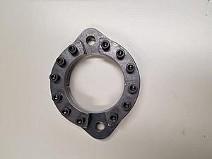

New flange
Bolts aren't tight in pictures

Sixpack, that was one of the hardest part I did. The rust welded the bolts in place. It was very hard to drill that part and I dulled a couple of bits and gave up. No PB Blaster soaking will do as well. At the end I bought somewhere about 7 inches of 5/8 bolt, torched the flange and hammer it out with the bolt I bought. Took few minutes to get it out.

The old man has helped me out of many a jam over the years. It's great having free engineering/machining services, lol!
I'm also happy to know that they did come with studs on that flange. And that I didn't get a Disco built on friday afternoon...at least not for that reason. So far so good everywhere else.
I have been working on bikes and cars since he started teaching me at 12, so 28 years. I worked for a couple dealerships after school before I realized I did not want to do that for a living!
In all that time, I have never seen the bolt on flanges like you posted. Hence, he made one.

Can confirm, that flange had press-in studs. Took me half a day to remove mine and replace with bolts, but I'm still left with a flange thats in ****ty condition. Thanks for the tip on aftermarket flanges
I think the key for me was grinding the heads off the stud, drilling out some of the stud to create a relief, and then tapping it out with a hammer. Torching did not work

After the failed effort of removing the studs from the threaded side, grinding the heads of the studs and hammering them through from the other side was next.
My Dad offered to make the new flange, and save me the trouble. I was quick to agree.
One stud was completely rusted through, causing a leak.
They looked like rotted bolt heads.
But, after Dad pointed out what should have been obvious to me, I realized they were studs.
Strange that all the diagrams I have found show flanges with holes for bolts. Oh well.
I appreciate everyone's input, and confirming that they are studs.
