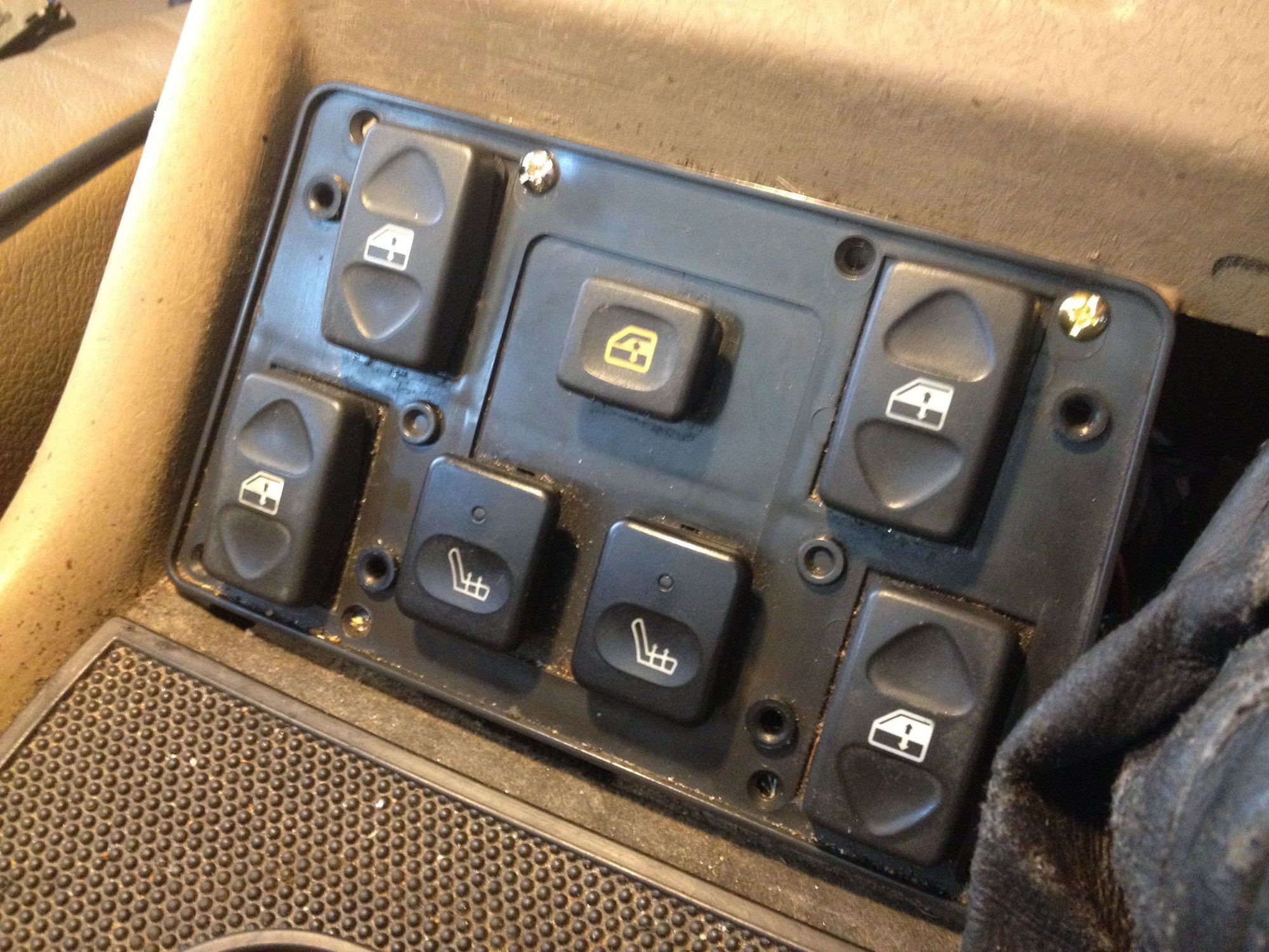

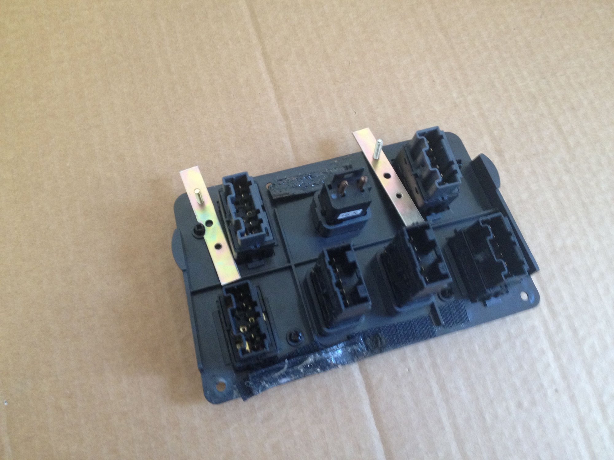

Here's what I did years ago to address the broken tabs on the console into which the window switch plate is supposed to be mounted with screws.
I had some leftover hardware lying around and used two pieces as clamps to hold the switch plate in place. This was nine years ago, and the hardware is years older than that. I think it was old picture framing hardware of some sort, for metal frames. The exact hardware isn't needed; something similar could be fabricated with similarly shaped metal strips, a drill and a tap to cut threads. It looks like I used Velcro to secure the bottom edge.
I hope the pics are self-explanatory. It's not a perfect setup, but it works pretty well and cost me $0.
