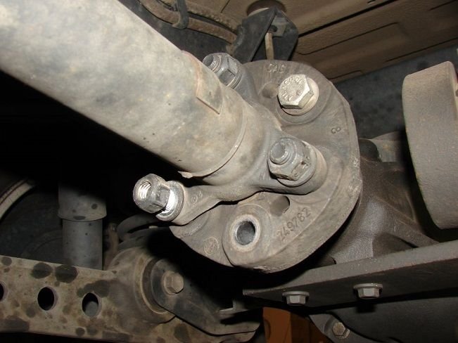

I hope you have a better outcome than I did. I still get pissed when I think about that Blue Bag with the $hitpart roto in it.
You probably already know this, and I don't remember if the cheap-o roto has the arrow markings for the bolts like the GKN does.... but anyway it mounts like in the pic

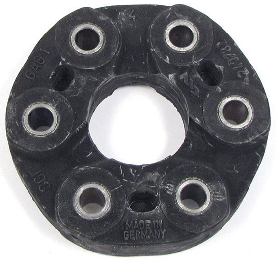

Cool you'll get it sorted. > RovahFarm for all your new Land Rover Parts and Accessories
Just for giggles, if you can tell, what brand was the old roto that you removed? Normally a GKN will stress crack with age and not really get "soft". Just curious to see what was in there.
The pic is what the markings on a GKN would look like.
