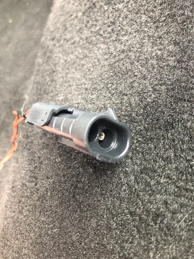

If a connector gives you an issue, you can replace yours with weather sealed Delphi connector (see 18-22GA on Ebay). These connectors require zero soldering and are way more durable than the stock Rover parts. Note, you'll have to use a crimping tool to connect the wire to the pins. Example from Ebay.
The female part of the connector is shown below:

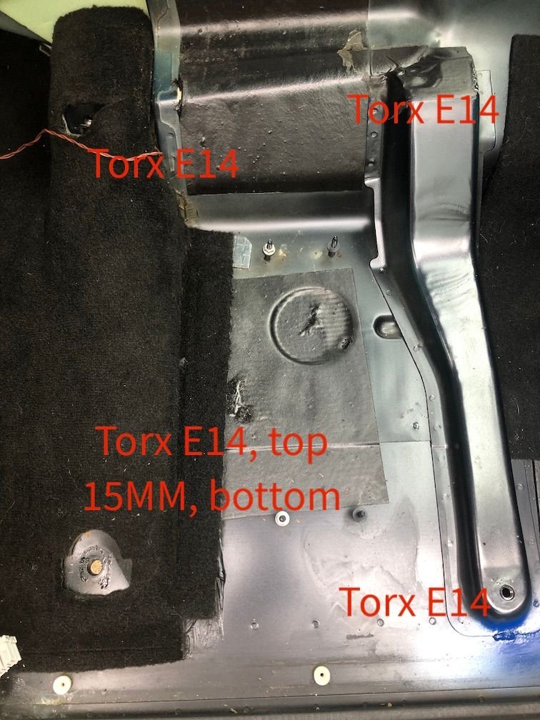

If you tensioner is bad, then you have to get new one and install it. Before you do it, obtain RAVE manual and read through the chapter on SRS maintenance. Look up SRS in the table of contents. Then:
1. Disconnect the battery
2. Remove the seat (torx e14, 15mm)
3. Remove the tensioner
Tensioner part #: EVB104990 (left), EVB104960 (right).
