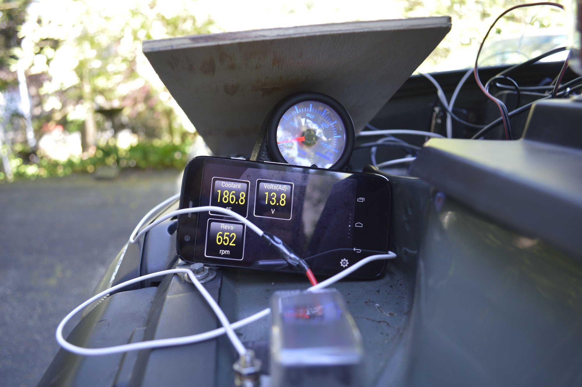

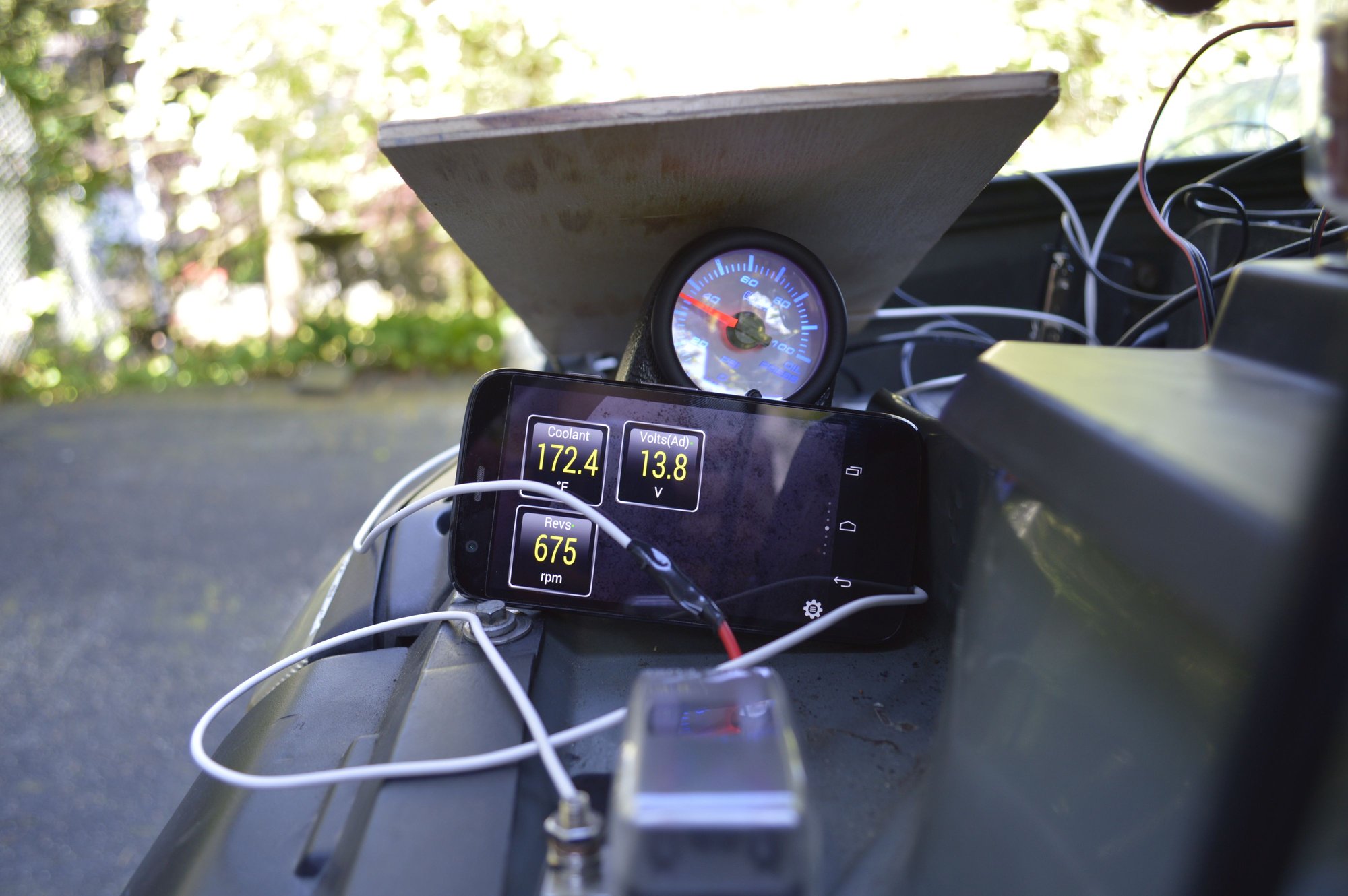

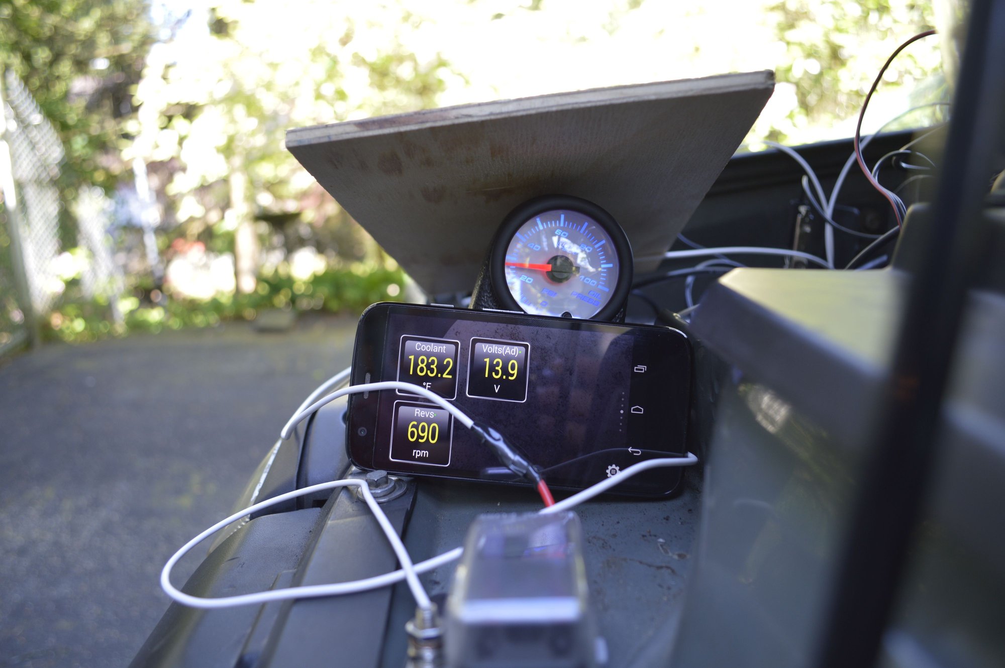

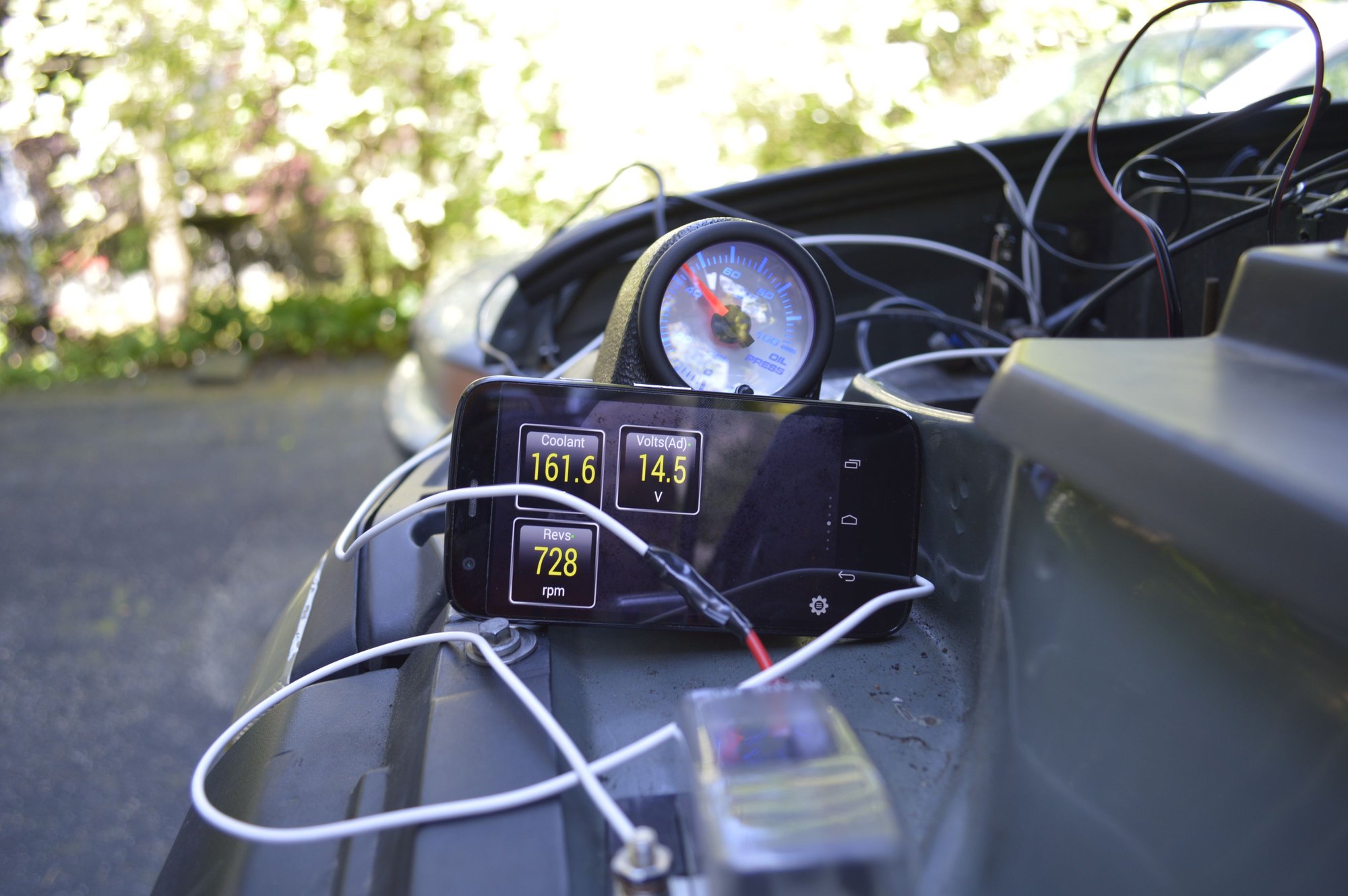

I checked my oil pressure the today,I have a gauge but the feed wire was too short so while I wait I setup up a temp solution.
Oil in use Mobil Vr1 10/30 Synthetic - it has better performance than the Rotella 15/40
Filter M301
I do have a tick hence the pressure testing
Seems good cold idle at 50 PSI idle at 188.6 ,normal hot idle, around 18 psi 680 RPM, Hot 2000 around 42 ish
For reference the RAVE 50 at cold idle and 10 minimum, it should run between 40 and 50 at 2000 + rpm hot
I have a few concerns related to hotter summer temps, so I may move up to AMSOIL 20/50 synthetic for the summer
Some Images

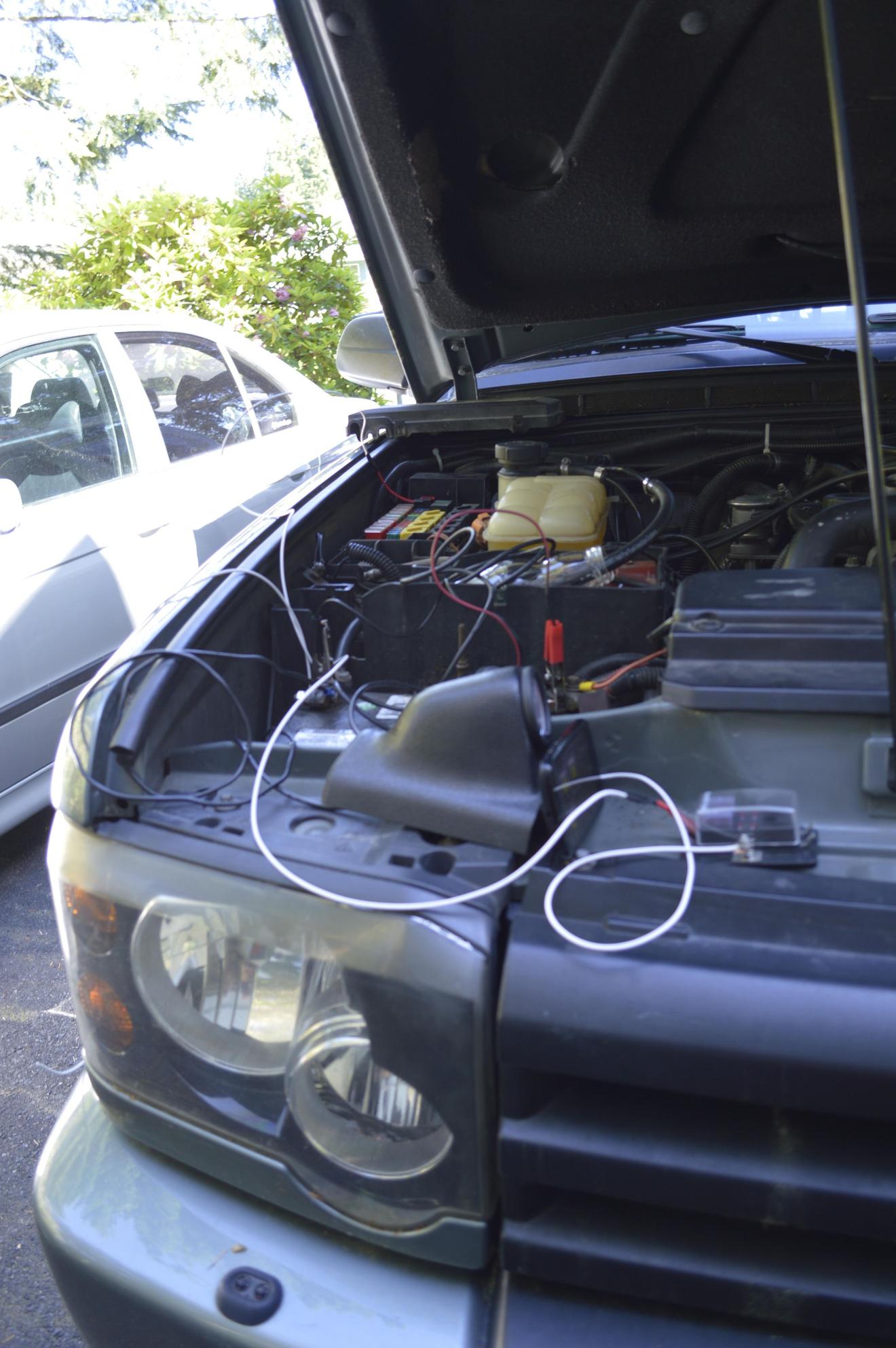

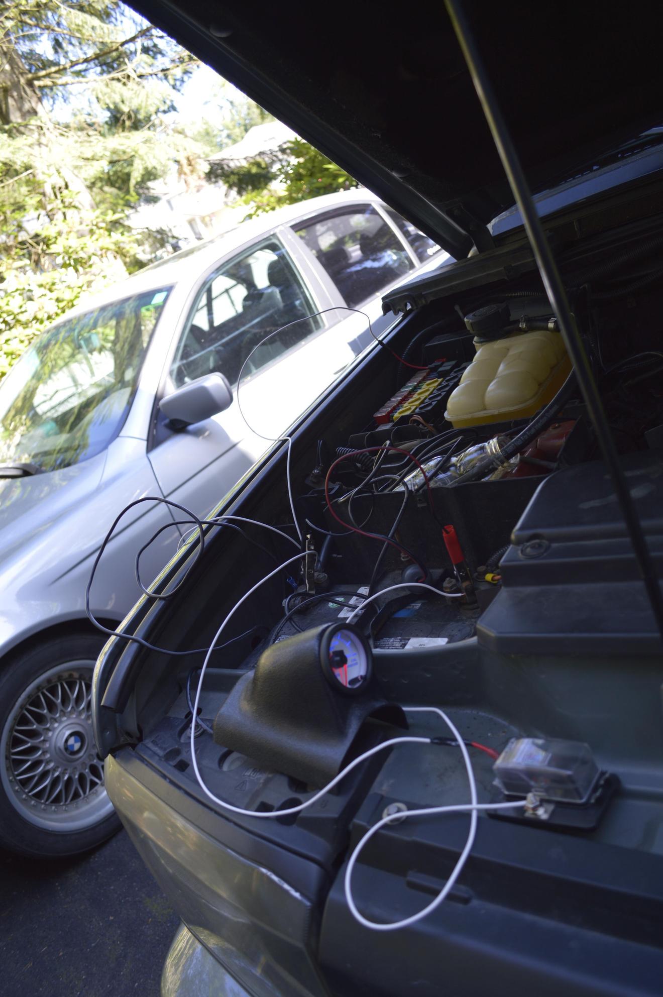

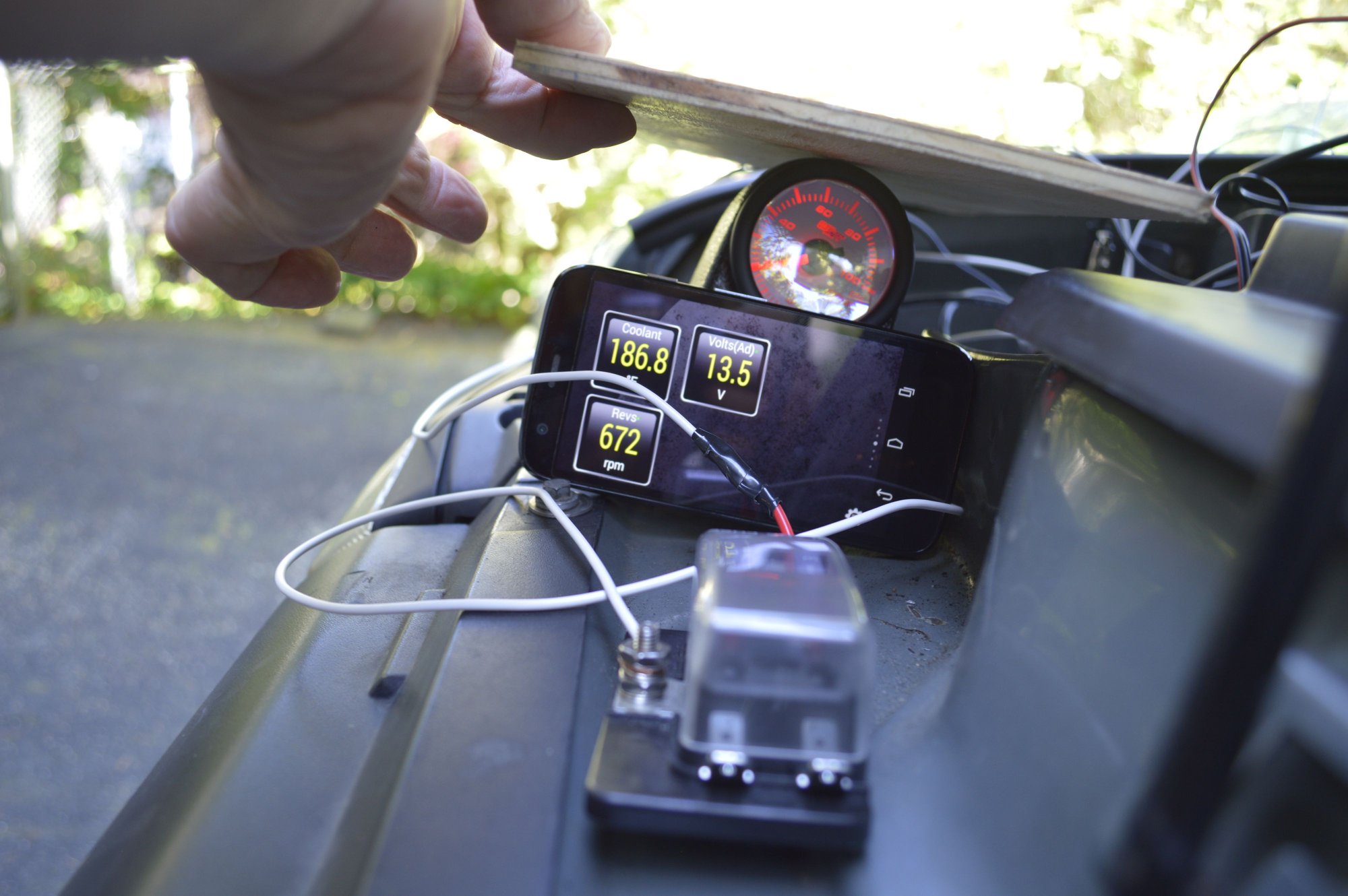

The test setup Glowshift Gauge and Sender, Switched lead to horn. Everything else to battery, connected by pressing wires to terminals via alligator clips. (Very High tech)
My monitoring cell phone leaned up against gauge
And the results over time for those interested, I have no issues with these numbers but I suspect they will be lower in very hot temps.
