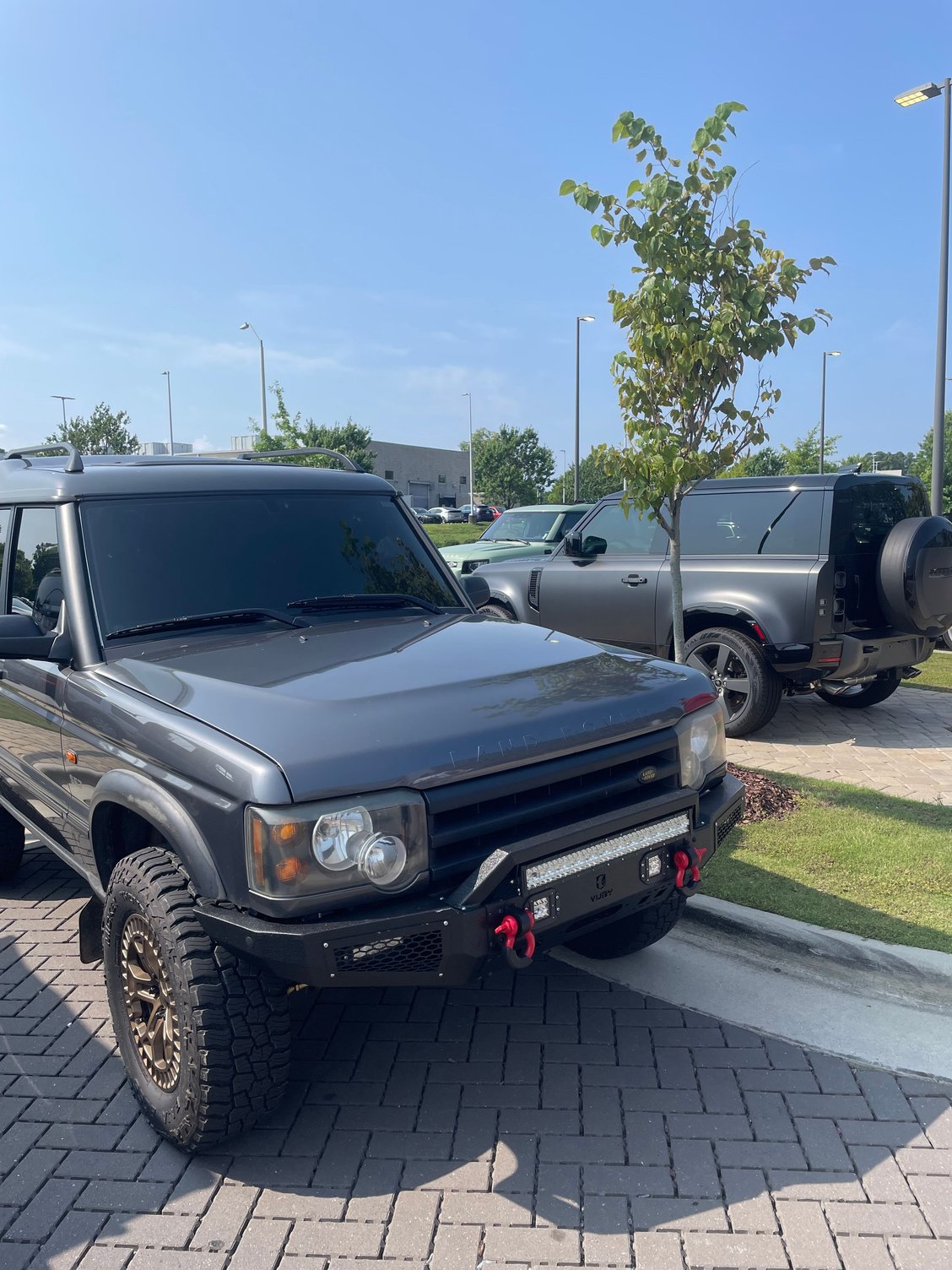

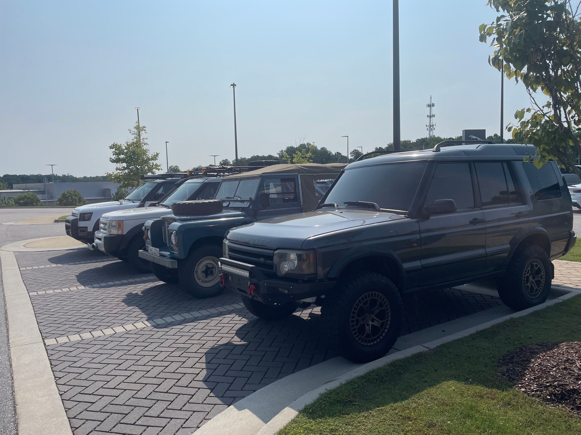

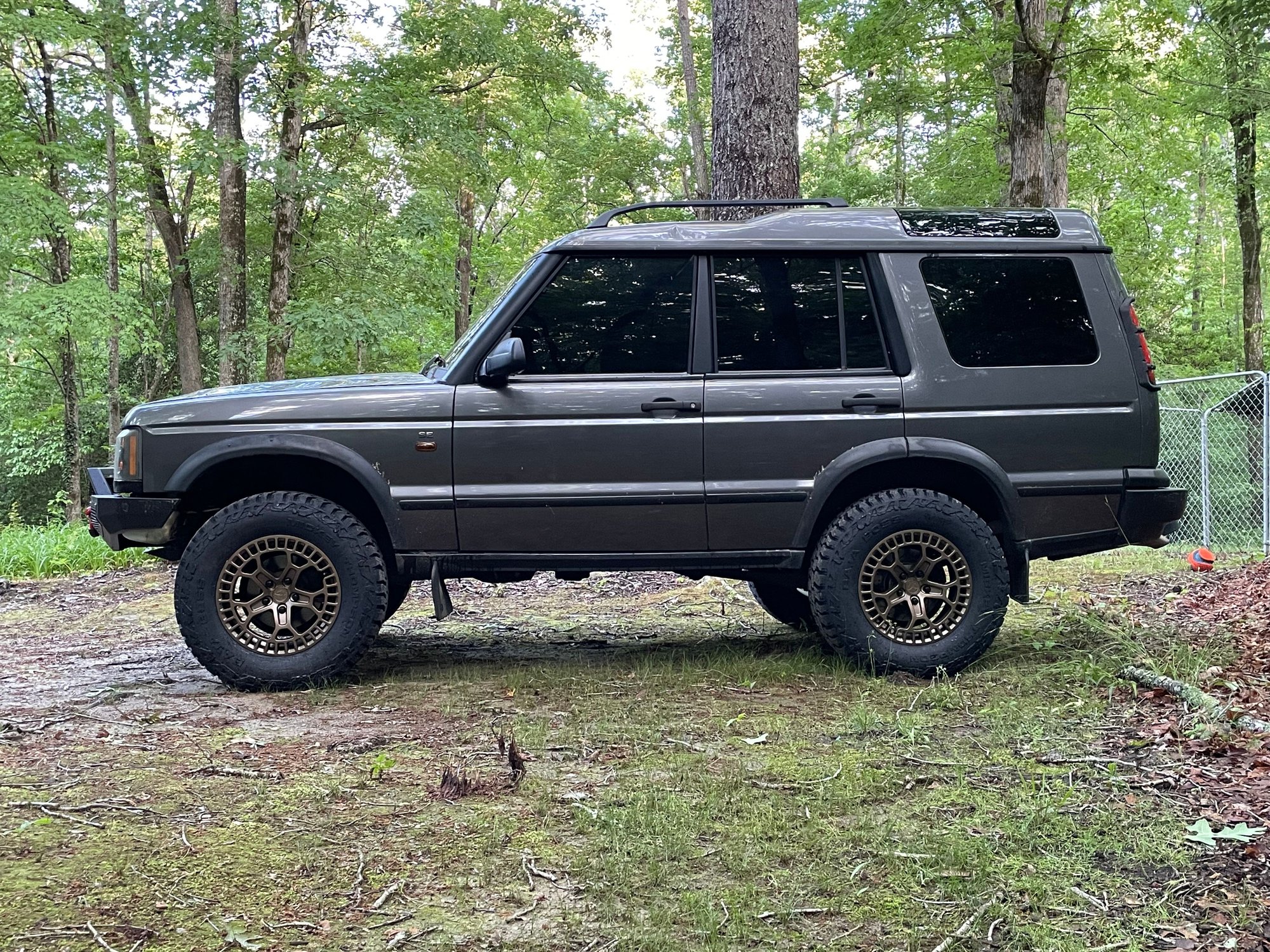

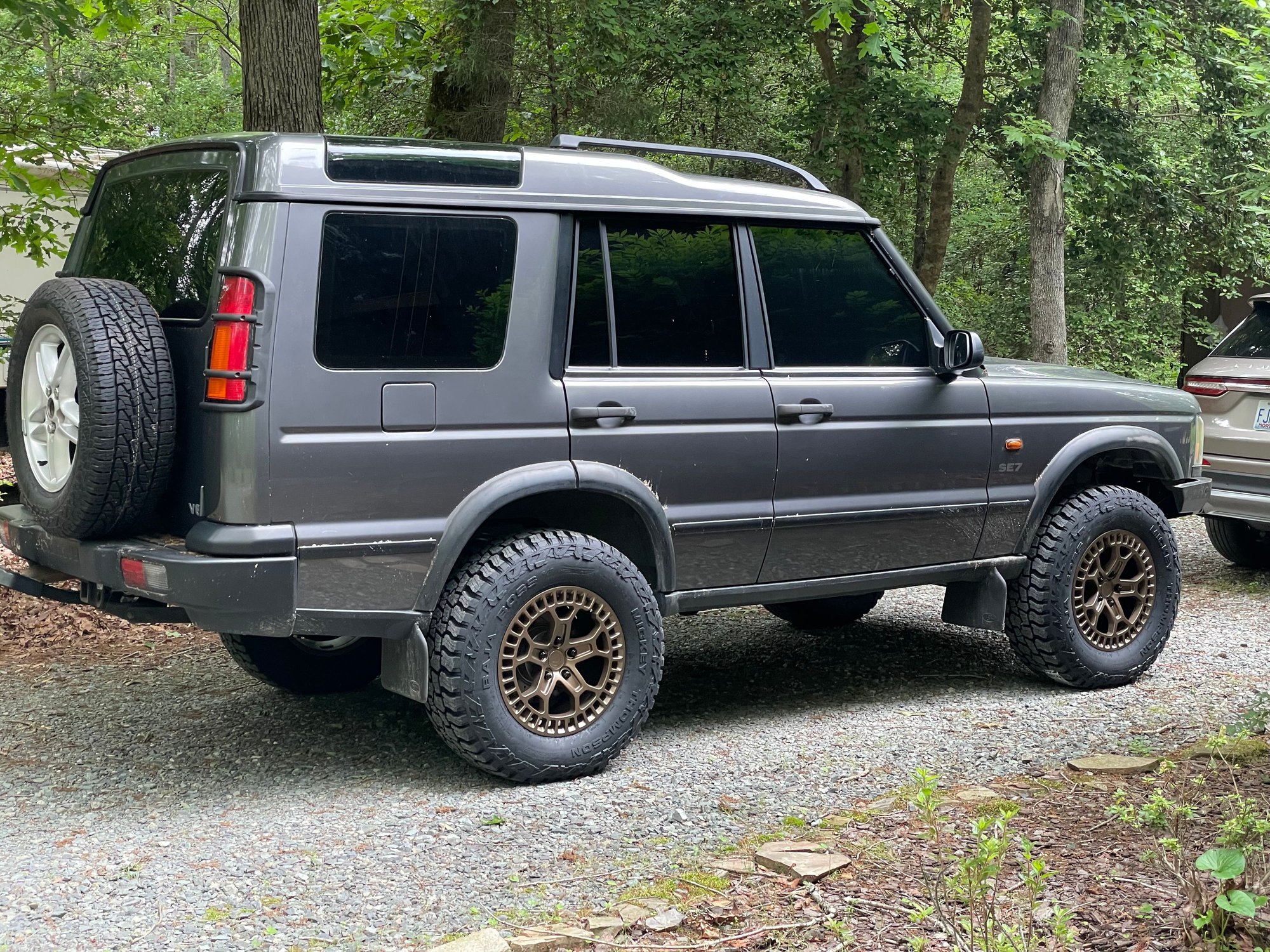

Sanford NC. If anyone is interested let me know. Crap ton of new parts in this rig. Will not part it out.
Old Dec 20, 2024 | 02:36 PM
  #36
Grum.man's Avatar
Joined: Apr 2024
Posts: 176
Likes: 72
Like new tires and wheels
New MAF
New Thermostat
All new radiator hoses
04 T-case
2" lift with disconnectable sway bar, extended brake lines and ABS looms
Ventilated brake rotors and one new caliper.
TF 4 way adjustable shocks with less than 1k miles
Rebuilt engine included:
Fresh machined block with top hat liners
Crank ground .010 under
All new bearings
New Oil pump
New performance cam from TWS with 30 minutes of run time
upgraded pushrods
upgraded hydraulic lifters
rebuilt rocker assemblies from TWS
Heads milled .015" for flatness
New Pistons pins and rings
New timing set
New flex plate
New rebuilt injectors
New O2 sensors
New Crank position sensor
New knock sensors
Upgraded greasable front drive shaft
cranked watts
HD steering rods and stabilizer
New black headliner
Interior in excellent shape.
No ABS or Check engine lights.
