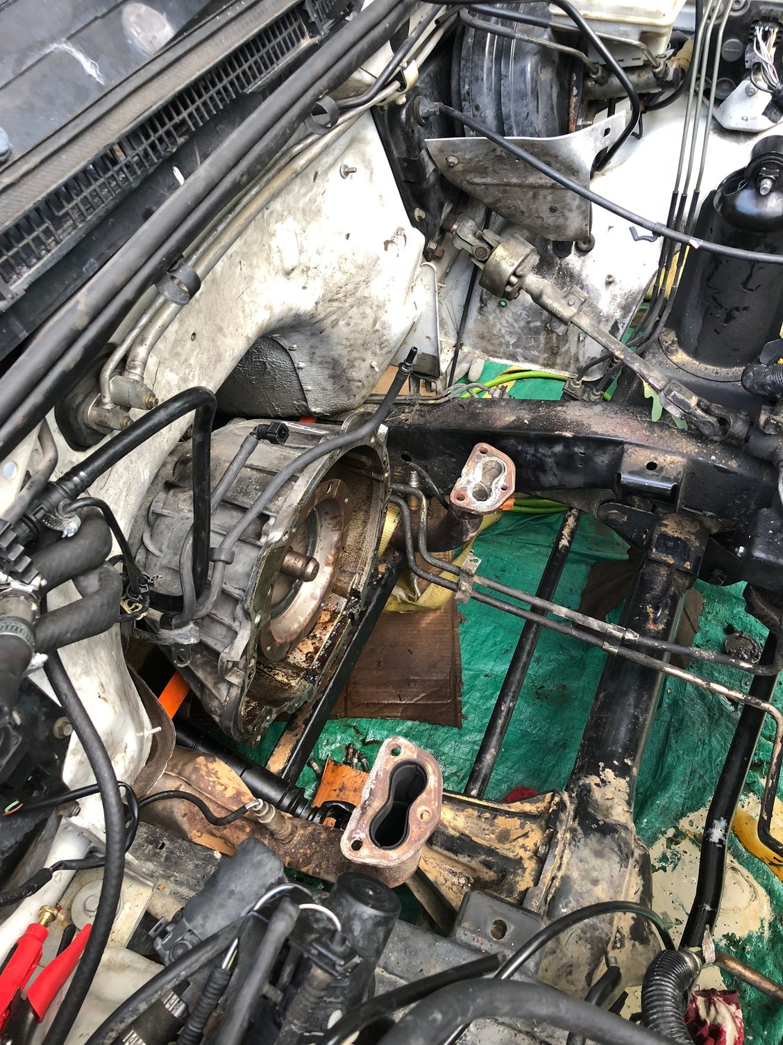

I pulled the engine from a 2000 DII over the weekend. For the most part it went smoothly. The new (used) engine that will be going in is basically complete. I would like to avoid taking the intake coils etc off on re installation but I realize that access to the bell housing bolts would be impossible.
Contemplated taking the transmission out.
Then had an idea:
What if we shift the tranny forward so all bell housing bolts are exposed drop engine in bolt it up and slide it all back in place.
Here is what we did last night:
Pulled the front drive shaft,
Unbolted the transfer case frame mounts on both sides,
Used a floor jack and piece of wood under the transfer case and lifted everything up and slid the transfer case and transmission forward a few inches.
Now thee appears to be enough room to access all the bell housing bolts and just enough space to drop the engine in without hitting the radiator.

It worked!!! Much better access to all bell housing bolts!!! They actually went on with ease.
Just enough clearance for the radiator. I put a piece of plywood in addition to cardboard to protect it.
I wish I had pulled the exhaust manifolds off it would have made it easier.
Also I used the last bottom bolts on the exhaust manifolds (7 & 8) to attach the chains and the brackets hit the firewall before it slid all the way back. That would have been a problem anyway even if I pulled the intake first. Obviously an easy fix to use cylinder 5 and 6 instead of 7 and 8 or use different brackets.
Clearance was fine
Transmission shifted forward
