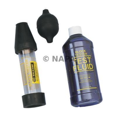

Yes for sure a pressure test, & co2 test, will tell you truth,

Also, where can you rent these testers at? I might go ahead and purchase them since it would be a good tool to have around. Would this tester work being that we don't have a traditional radiator cap? This would check for exhaust gases in the cooling system.
