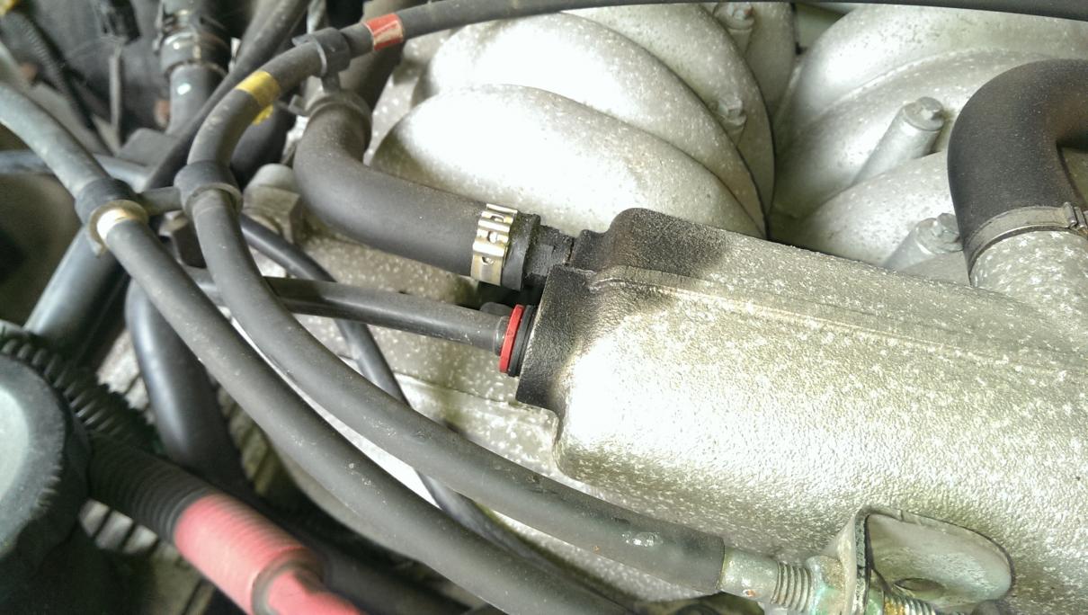

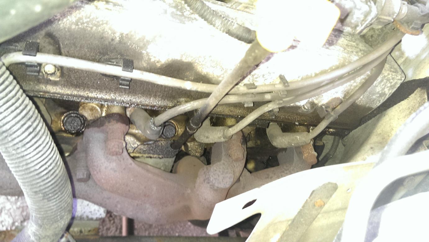

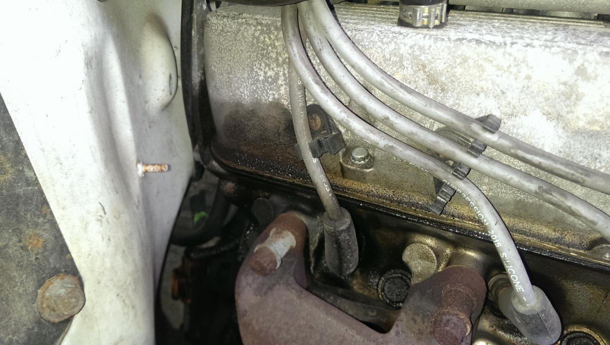

I was looking closely at the engine today, however, and noticed some gunk building up around the headbolts. I attached some pictures. Do you guys think I need to tighten them, or could it be something more serious?

Old Aug 9, 2014 | 08:25 PM
drowssap's Avatar
Posts: 9,298
Likes: 318
From: Boston Strong
tighten your valve covers bolts and clean your engine see if it stops
Old Aug 10, 2014 | 08:24 AM
james.martin1's Avatar
Joined: May 2013
Posts: 131
Likes: 7
From: Massachusetts
I agree, just looks like a valve cover leak to me.
If your oil is too full I would change it and add the correct amount soon. After you drain and change the filter add 6 qts, start and run about 30 secs to fill the filter, then top off a little at a time until full (about 1/2 qt).
Noticeable coolant loss after driving 2 miles should show up if it is an external leak, I would get your engine cleaned up if replacing your throttle body heater doesn't do the trick so you can look for leaks.
