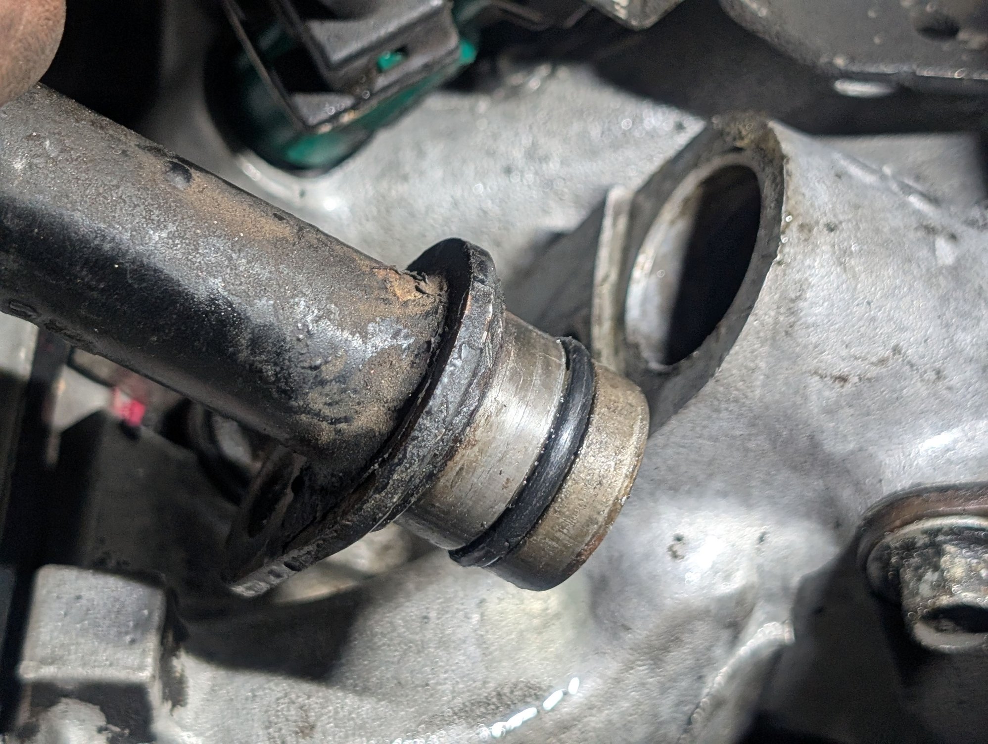

I think I found the source of the leak. The person suggesting the coolant pipe behind the alternator. You were correct. It had a tiny trickle that sat on front head bolt. Then went down the back near the transmission housing. I did have the o ring in place. Fresh from Atlantic British in the kit. It's been a few weeks now and I can't remember, but is it just one o ring or two? See picture. I ask because the front of the hole has a chamfer. As you can see I have just one.
Cheers everyone. John.

It's just one o ring. I always put a little permatex aviation sealer on o rings and hoses that are hard to access and i think might be a pita to go back into if they give me issues.

Originally Posted by PickleRick
The heater core line that feeds into the lower half of the intake manifold (black metal tube held in with 10mm head bolt)and the small hose behind the AC compressor could be the culprit. The metal tube takes an o ring that is easy to forget or damage on install.
You should be able to get a visual with light on them.
You were right!! Thank you. I did have a new o ring installed. It's been a few weeks but did it have two or just one? The hole looks chamfered. Also the attachment area has a slight step, I'm thinking it has another o ring at the shoulder of the mount plate. Or they sent the wrong I ring.
Cheers John
