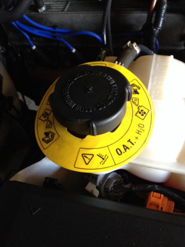

Old Oct 18, 2013 | 03:13 PM
shltn's Avatar
Joined: Sep 2013
Posts: 54
The coolant cap appears to be new. PO claims to have done it shortly before I bought it.
I just did a system flush of dex, replaced with Peak mixed to 50/50, switched to 180 stat ~2wks ago.
Old Oct 18, 2013 | 03:20 PM
dusty1's Avatar
Joined: Jul 2013
Posts: 5,794
Likes: 211
From: dallas texas
could you see if it was forcing out the overflow tube? should have seen green in there, if so.

Old Oct 18, 2013 | 03:47 PM
dusty1's Avatar
Joined: Jul 2013
Posts: 5,794
Likes: 211
From: dallas texas
i'd just keep an eye on it, next few outings. fwiw, both my d2 have their preferred fill level lines, neither are the factory line, but about a 1/2" low. when too full, it forces coolant out the overflow till it gets to that spot.
if it happens agian and if you suspect the overflow, you can stick paper towel in tube to see results

Old Oct 18, 2013 | 05:04 PM
OffroadFrance's Avatar
Posts: 5,845
Likes: 368
From: Near Bordeaux, France
I agree with Dusty1. The reservoir levels seem to be a 'rough' guide. If I fill mine to the max cold level after a couple of trips out the level has always reduced by 1/2" and always the same - never more and never less. I've checked the reservoir pressure cap and that's fine. The fluid just expands when hot and disappears out of the overflow pipe. Put some hand wipe tissue paper on the end of the overflow pipe held with an elastic band or thin wire and check whether it's wet after a trip out. That will tell you where the fluid is disappearing to at least. (that tip was, I believe, from Savannah Buzz who I thank for the idea)
