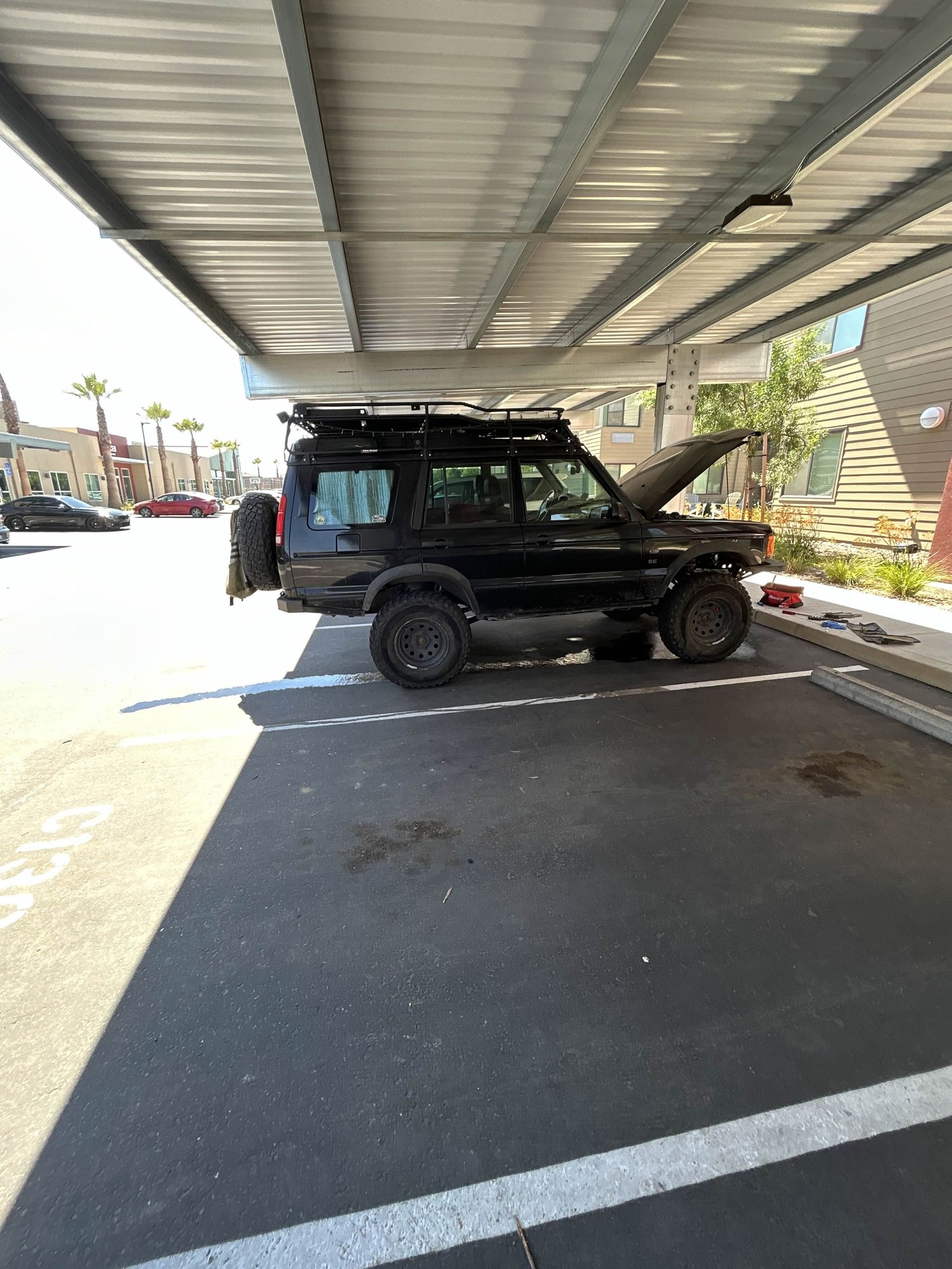

Going to install the inline thermostat this weekend and need to flush my coolant. I'll be doing this at an apartment complex without a hose so I can't make too much of a mess. Any tips or ideas on how to drain and flush the coolant system in a tiny way? I will have 1-2 5 gallon buckets from HF. I assume use distilled water to flush? Also what coolant do people run and like the most? I know it can be a heated topic (ha ha). The PO had Evans coolant which states it can be combined with water. Not sure if its worth ordering again. at $50 a gallon I would like to switch to something else that can be put in in a pinch and not be over 5x the price of a gallon of gas

Unfortunately this is the only space I can work in Its a covered parking spot at the complex I live at. Management has mixed feelings with me. Property manager is also a car guy and will chat me up while I'm working on it but some of the leasing agents will give me a hard time, I'm moving out soon so not terribly worried about reputation but need to minimized the mess .With it being 107F tomorrow and high 90s low 100s through the week I would prefer to work under something, Its also my only car I have with me. I have a buddy who is willing to help me get parts but with both of us in summer school its going to be tricky! I would usually push this off until I have the right place and equipment but the temps will only get hotter where I am until September.

Well I couldn't find the engine drain port so I just pulled off the lower radiator hose. RIGHT as the property manager showed up behind me. As y'all mentioned it makes a mess. A huge mess. Luckily he was understanding and just told me to clean up the mess. I asked if he had a hose but he didn't so I've got to try and figure out how to wash the coolant off without running water. My plan right now is to carry tap water down from my sink (3 flights of stairs + 200 ft walk). I've tried using kitty litter but it just became a sloppy paste.
