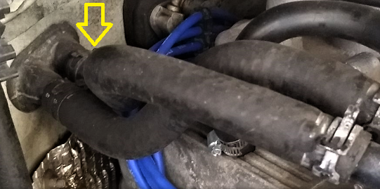

Zuke, definitely back-flush the heater core. And consider changing the molded hoses to the straight bulk hoses as Best has suggested.
I had a similar problem with a semi blocked heater core. As the truck would come to temp the hose (like in your pic) would collapse on itself at the bend. It was slight, but with an already compromised flow in the core =
I back-flushed the heater core a few times, replaced the molded hoses, burped the beast and it was back to Happy Town!

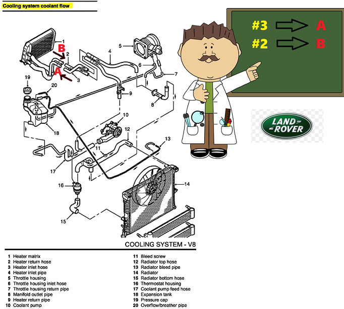

And just for Giggles, here is the coolant flow according to RAVE.....OMG way too much free time today!

The Rovers North site describes the pipe labeled 9 above as the feeder. If that is the case your arrows are backwards.

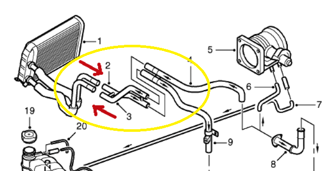

The arrows that I added are just in the same direction as the small black arrows that you can see in the pic from RAVE.
Not that it matters, but here is the description page from RAVE

Actually it is at the Rimmer site https://rimmerbros.com/Item--i-GRID800039
I am now confused about which to trust. The RAVE has so many errors. Case in point - the brake bleeding sequence.

The routing of the heater core lines is totally irrelevant in/out of the heater core. It’s a closed loop nothing more. As a matter of fact look up any older RRC or 94-95 D1 with the 3.9L V8 and they are routed straight in/out vs crossed.
All it really does on a D2 = required you to buy the fancy one piece OEM hose vs some 5/8 heater hose cut to fit.
Also the Rave flow directions are correct. When my core finally clogged hose #4/#3 was hot while hose #9/#2 was cold. So I knew I had flow to the core & nothing coming out. Back flushed it & then routed my new hoses in/out straight vs crossed and it works flawless.
