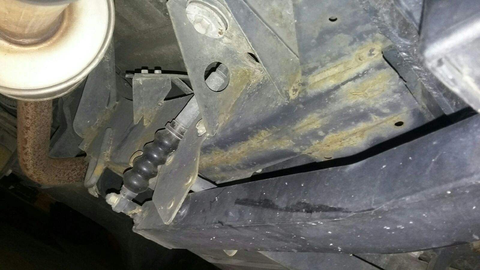

04 se7 seems to be in good shape. Curious what tye group thinks of these frame pictures. No rust but looking for evidence of collision damage. Also how can you tell leather from vinyl seats?

Seats are easy, discovery 2 was never sold with vinyl seats in American markets.
Don't see any evidence of damage, for collisions you would look for metal deformation with more rust in that area if old accident, brighter metal if it just happened. If the steel bumper (under the plastic) looks much newer than frame you can assume something happened. Same with front bumper.

Thanks. Always nice to have a second set of eyes. It supposedly has a fully rebuilt motor with tophatt liners but waiting on documentation to confirm. Little odd since I know if I was the seller I'd have that document ready to share.
