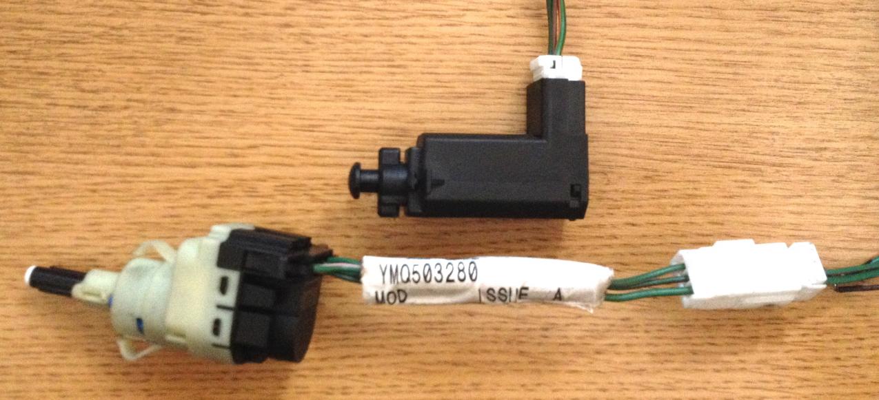

The brake pedal switch fitted to my car is part number XKB100170 which, according to Rimmer Brothers website, is the one used on early Range Rover 2s (up to 1998) and early Freelanders.
However, the website says that my car should have had either XKB000010 (early cars) or more likely the later car's XKB500120 (with YMQ503280 wiring adaptor).
Does anyone know the system well enough to tell me if the early one would work or if I need to invest the necessary £35/$50 in the correct items? My suspicion is that the wrong switch being fitted means that the system thinks that my foot is on the brake pedal and is preventing it from engaging.

I have pulled many XKB100170 switches from the hundreds of DII's and P38's I've parted. I have seldom seen either XKB000010/YQM503280 or the updated XKB500210/YQM503280 switch in any of them. I would say you could use whichever one you can find.
The picture below is of the early style XKB100170 and the newest version XKB500210/YQM503280.
I've also provided a link to the XKB000010 available from Atlantic British just for reference. You would also need the expensive part, the cable YQM503280.
Brake Light Switch & Wiring Assembly Kit (Genuine Part # XKB500120 ) - Land Rover switches from Atlantic British
