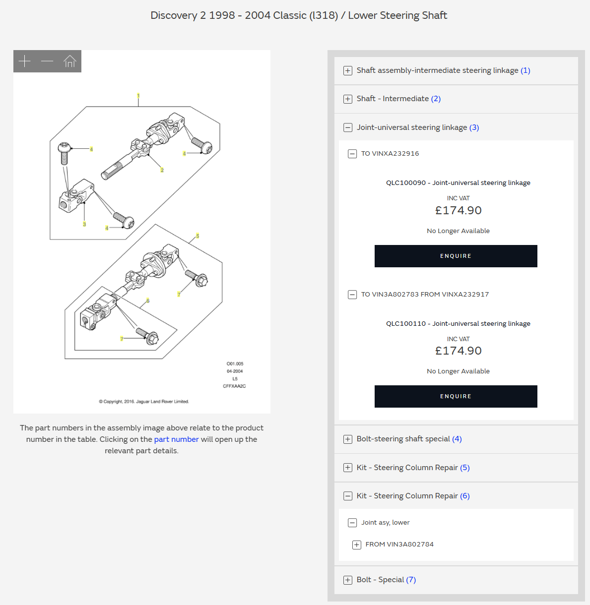

So I checked the lower universal join on the steering shaft it its completely rusted over. I'll take a picture of it tomorrw but that will be getting replaced first then can troubleshoot if theres still more steering issues. from the comments above, it sounds like I might need some caster corrected radius arms as the ones that are on it look stock but its got a fair lift on it.

So looks like this will need replacing first:
Lower Steering Shaft Universal Joint Linkage
Has anyone replaced this on their D2? there seems to be a gap for the parts for a 2002 Discovery 2 (pre-facelift).
There is this kit:
https://www.jgs4x4.co.uk/discovery-2...nt-repair-kit/
but in the notes it says: Discovery 2 L318, 2003-2004 from VIN 3A802784 - I'm looking for a 2002 variant.
The official Land Rover site says the linkage i'm looking for is QLC100090 but they don't seem to sell that.
They do sell a Kit - Steering Column Repair which is the same kit (at least the same parts) I linked on the jgs4x4 site, but its only from VIN3A802780 (facelifted disco 2):
anyone know if this will fit onto my D2? has anyone here replaced their steering UJ? if so which parts did you use?
Thanks.

You should troubleshoot stuff before you start replacing stuff. That u joint could be toast, but it could be fine too. Doing things like disconnecting the steering link then seeing if the wheels turn easily or not will isolate the problem either to the axle area or to the steering box area. You might save yourself a bunch of money doing this sort of investigating first.
