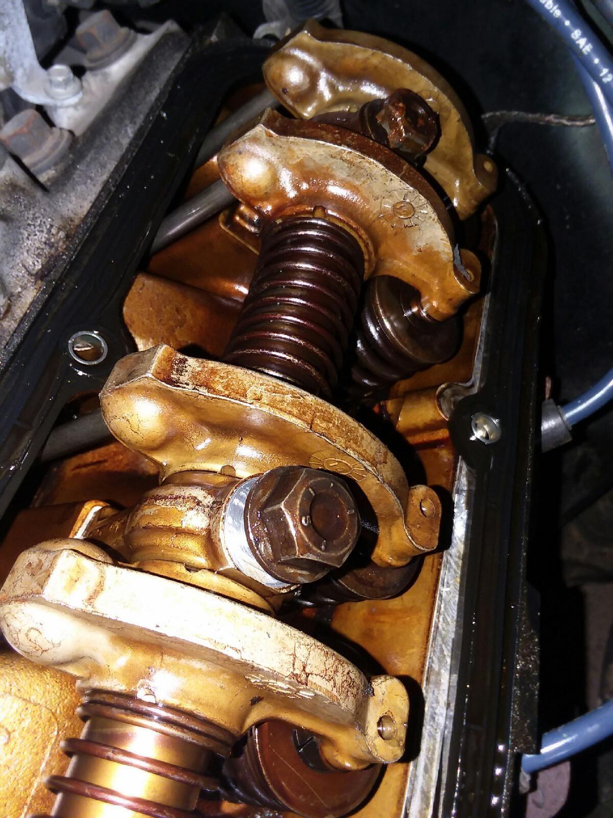

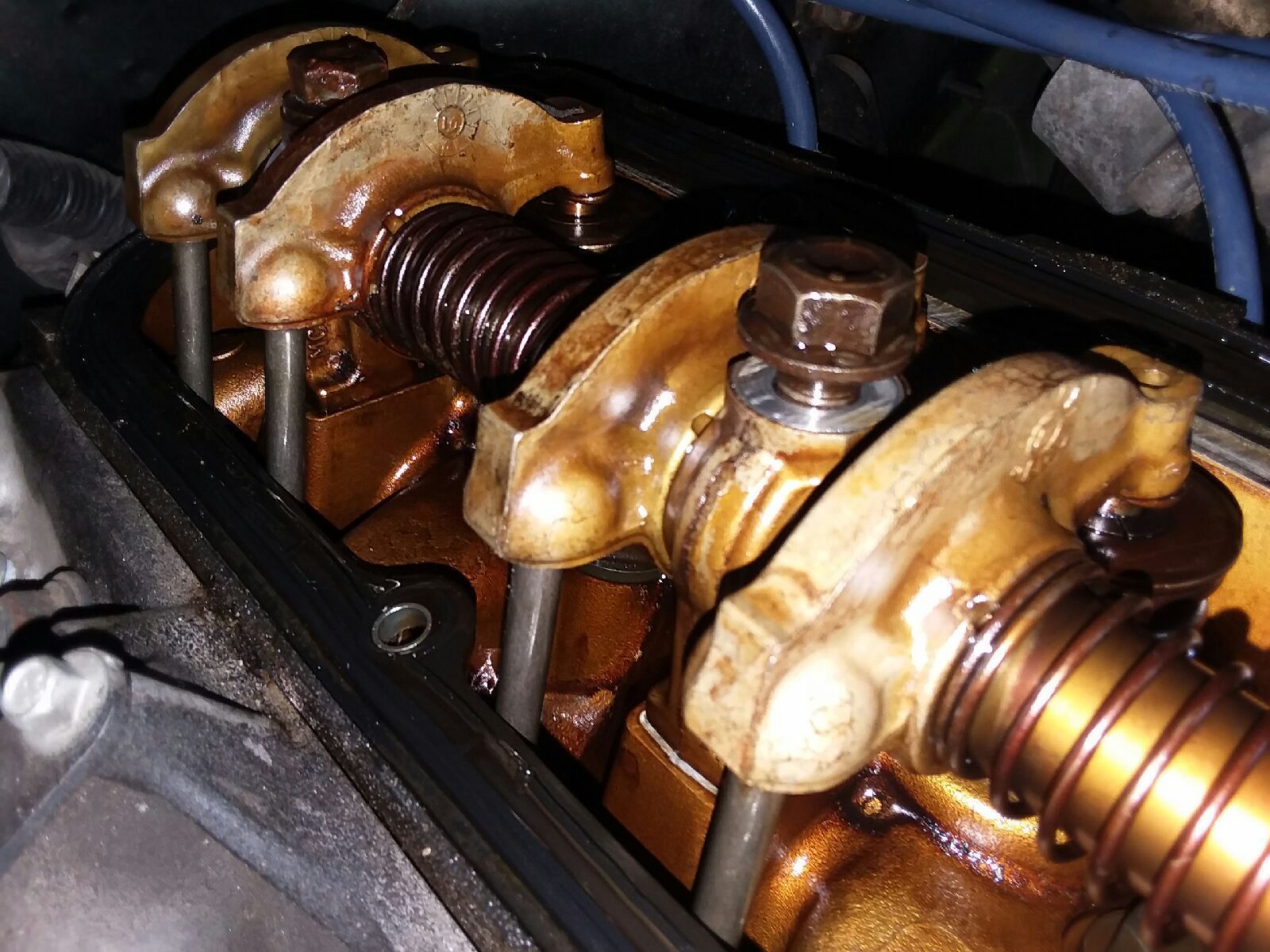

Ok. So I finally had time to pull it apart. This is what I found. But how does this happen. Not just loose, this is how that bolt was when I pulled the cover off.
1) Is that semi-normal? 2) It is #5 so am I correct that this should be the cause of the misfire code and all the noise? Or is there an underlying issue I need to look into?
Anything else I should do other than just re-torque all of them? (Besides clean it up while its open)
What about gaskets? Any parts store intake and valve cover gaskets worth using?

Well I'd look around for any broken stuff, knicks etc, take the bolt out, make sure the threads are ok, then run it in, put it back together and drive it.

Pulled it out. Looks Fine. Thread lock of any sort on these bolts?

Nope. I never have...

One thing I would do before I put that back together...
You said you had low miles, pull the shafts and look for the little oil holes, make sure they are open and not gummed shut. Lisa Bunch has a thread here about it. I opened my rocker shafts up by cleaning them and my tick disappeared.

Also...if you look at your valve cover gaskets, theres a little steel circle where the bolt goes through. Make sure you have those before you put it back together.
