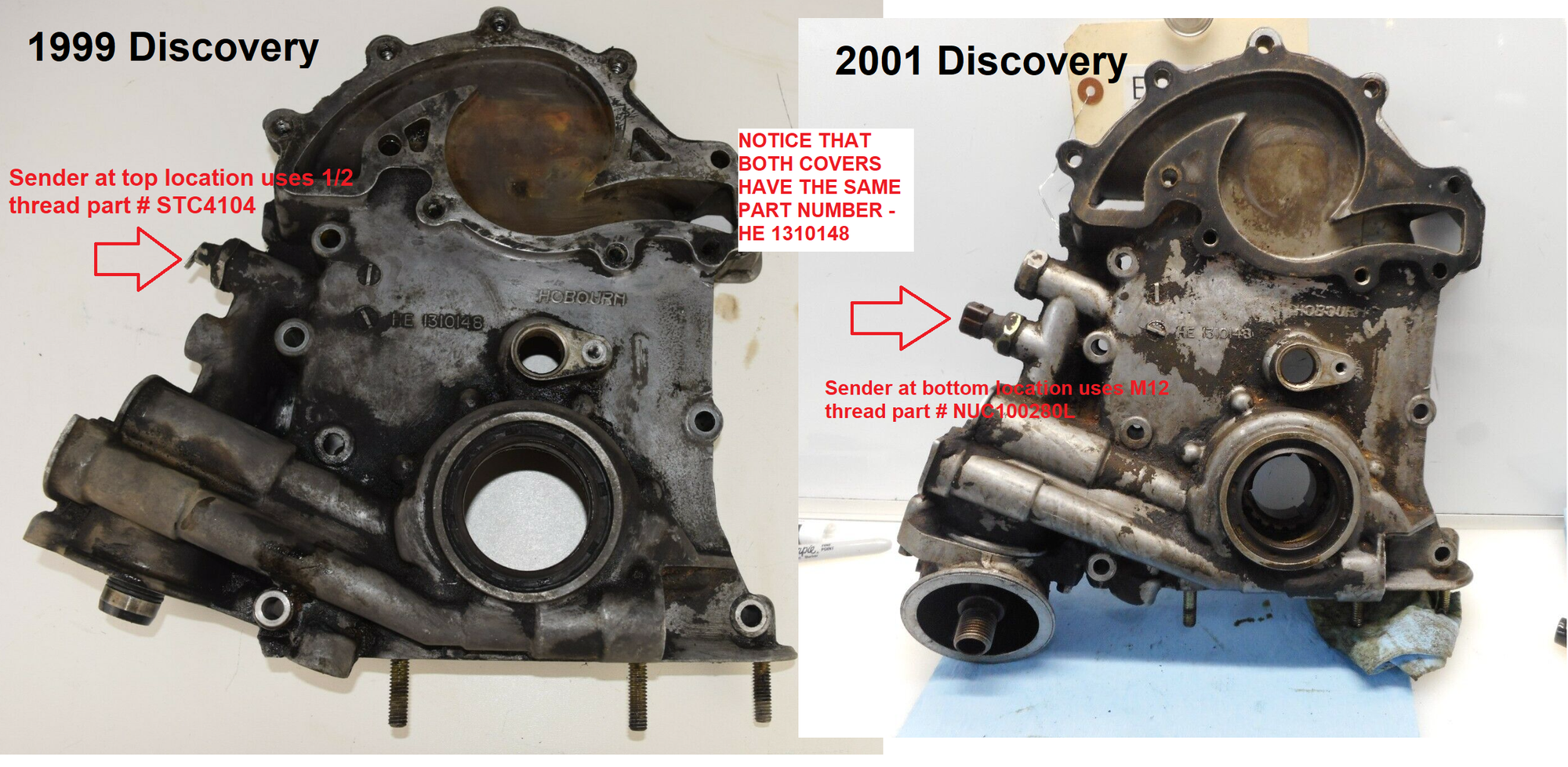

I'm just looking to post some info that I could not find. Maybe I am missing something obvious to others. I replaced the timing cover on my 2000 discovery with one from a 2001. The part was listed with a VIN number and mileage. Everything fit up but the sender leaked badly. I bought another sender at Napa for a 2000 discovery and it was also the same metric thread with female plug.
Regardless of year or anything else, the covers with a sender on the top use the male plug with 1/2" thread and the covers with a bottom plug use the M12 with female connector.

So will the 02-04 front cover fit the 01 D2 ? They look the exact same but I can’t find one that specifically says 01 timing cover
Old Aug 19, 2023 | 01:22 PM
Discorama's Avatar
Joined: Jun 2018
Posts: 1,235
Likes: 509
From: CA
It will not work, because the relief valve for the oil cooler is open all the time. You don't get oil flow through the cooler in a '01.
Front cover for a '01 D2: https://www.roverparts.com/engine/fr...ers/LJR105040/
