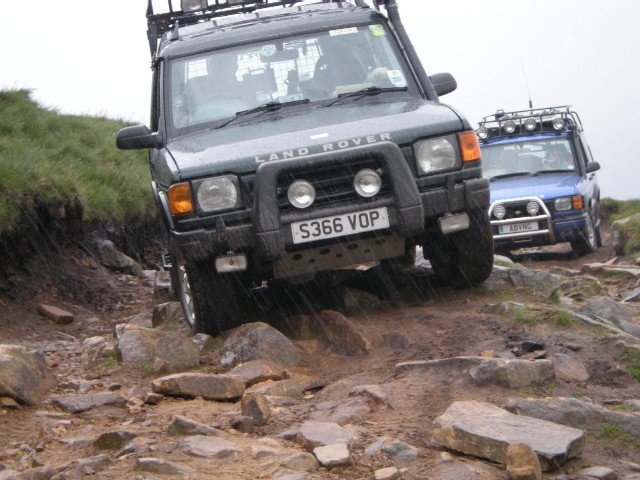

D1's have a shorter Indicator lamp, so to fit 03-04 D2 lights you will have to cut the wings as well as the headlight reinforcing panel behind the lamps.
Another cheaper option is to fit pre-facelift D2 lamps into a D1, they go straight in with no mods and look much better and give a better light performance to.
heres a Friends D1 with D2 lamps in it...
