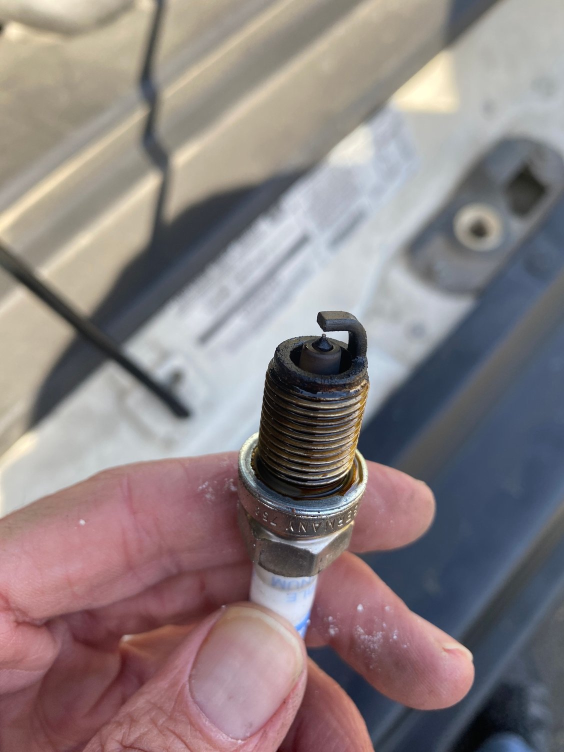

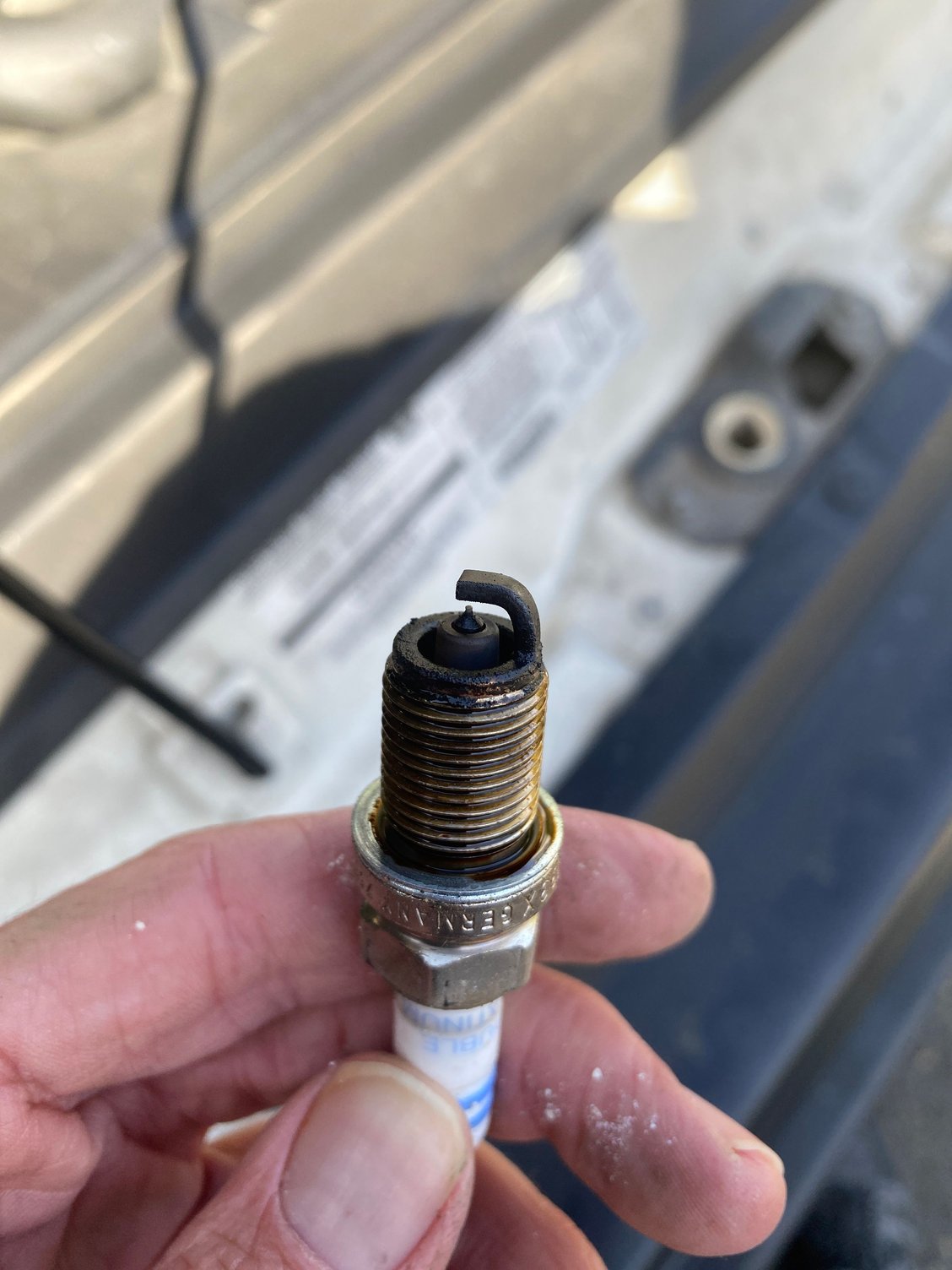

Pulled the #8 plug

Maybe try the next higher heat range next time. Does the engine burn some oil?

My theory is that the plug is fouled as a result of the issue causing the misfire... It also hasn't had a highway speed drive in months. I also lean towards the coil pack as the culprit. I don't really have the ability to swap the wires around even to check the coils right now, but I'll test when I get it into the garage before I tear it down just to have as much knowledge as possible.
In response to your question JohnZo... she does burn some oil. If I had to guess I'd say it's about 2/3 quart every 1000 miles, no more than five years ago though.

I don’t think 2/3 qt in 1000 miles is a worrisome amount.

Not terrible, but could make the plugs turn black and oily, especially if the valve stem seals leak a bit.
