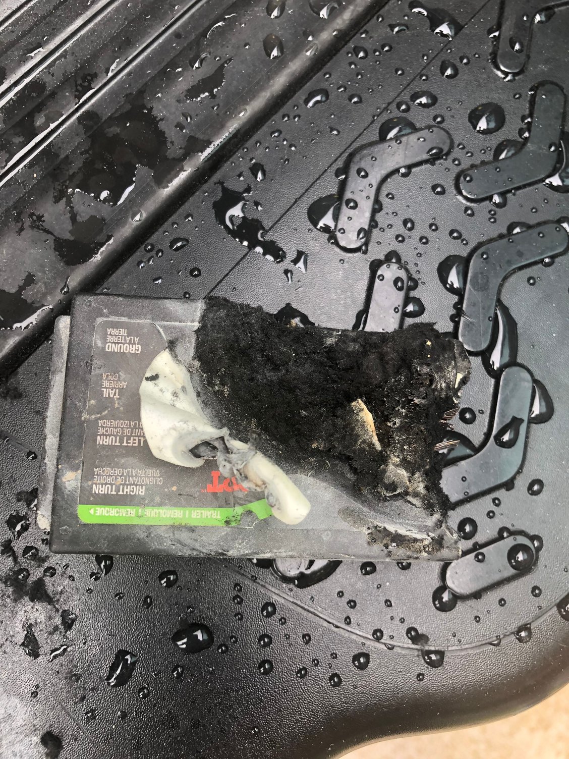

That’s why I ended up to tinting mine because water got in the cracks and dropped out of the hole I drilled right into my trailer harness causing it to burst into flames

I’ve never seen that be a problem with the OEM trailer wiring unit. It’s very sealed, but I have seen a few aftermarket units on LR’s in the past (like a UHAUL or generic unit) which I didn’t trust so I removed it. Water will still seep behind the tail lamp assembly and run down regardless if you drill a small hole on the 03-04 assembly or not because they don’t seal up to the body.
Glad you caught that sucker before it went downhill quickly!

Are the earlier lights a direct bolt in? And the fire looks scary! Good catch!
