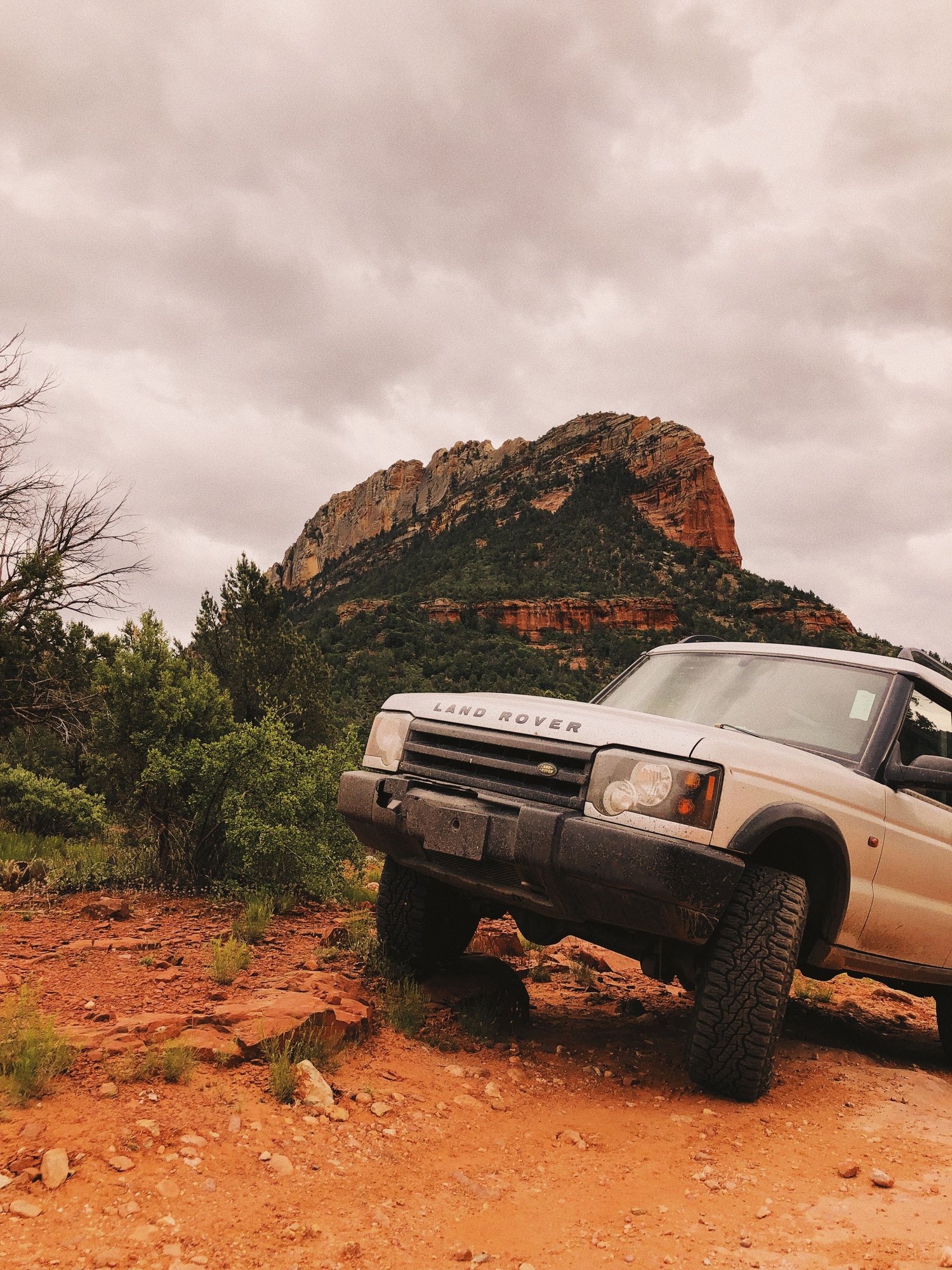

Default Disco II
So, long story short I use my 03 Disco as an everyday driver and trail runner, and far it’s been great; until about an Hour ago when I’m pretty sure the tranny just went. Well $#/% So join me as I try and diagnose what the hell is going on and if I have to replace the tranny god forbid as I swap it out. Never done something this in depth but I feel like it’s something I need to learn to do considering I want to keep this car. I freakin love it man. So if you got any advice or just wanna laugh at me go for it! I’ll read through all and reply as I can, plus lots of photos. So yeah first thing tomorrow morning I’m getting a started so, wish me luck
-R
This is the Bastard
