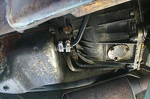

And there is my way :
Discovery I transmission dipstick into Discovery II
From a 2" long; 3/8" NPT nipple as pipe material ( I used brass), one of its threaded ends chased with a M16 x 1.5 metric die (not an easy find, but friendly guys at a Kubota shop had it), fits the oil pan thread....Then a 2" piece of oil duty 5/8" hose section in place, accepts a $5 boneyard Discovery I dipstick tube with 1/8" of its flare end sliced off barely remaining any flare signs left (and collar nut removed),. ....Two clamps on the hose and NOT done yet :
The huge nightmare of putting a screw and nut to hold the support bracket were it belongs rear of block was by far the sweatiest part, taking only that over one hour to accomplish.
Has not leaked a drop in 3 years so far.

It looks quite crude but in fact is quite ingenius and forward thinking. If it works OK why change it as paying for the privilege is pointless at your prices.
