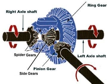

The sound of a failing front or rear differential will be a loud low-tone whine / grumble as you drive before it fails. When it's broken to the point of not transmitting drive to the wheels it'll either make horrible metal cracking sounds or possibly no noise at all. To check, you can chock the wheels, put the car in drive and look underneath to see if your driveshafts are spinning. If either your front or rear driveshafts are spinning but the vehicle isn't going anywhere, it's probably a broken front or rear diff. If the one of the driveshafts is spinning and you have a CDL, lock it and put it in drive and see if you move forward (if one diff is broken, all the power goes there, if you lock it, the power is distributed evenly front-to-rear). It'll probably make terrible noises. When the center diff is failing, it will whine for quite a while before it fails. It would probably also make terrible sounds. You can check the fluid and look for metal parts, but what you describe sounds a lot more like the forward clutch pack. If a diff is broken / failed, it'll be broken for both directions of drive so you won't have reverse or forward. To check the fluid level, take off the fill plug and see if fluid seeps out. If it seeps out, it indicates that the fluid is full. If you want to check for metal, first remove the fill plug (Always remove the fill plug first in case you can't get it off at all. If you can't get it off and the diff is drained, you're in trouble) and then remove the drain plug. Inspect the plug for metal shavings (it's magnetic and some extremely fine shavings are normal) and look for glitter in the fluid that comes out. In catastrophic failure you'll see large chunks of metal. Don't forget to refill if everything is fine.
The picture below is an example of what's inside a differential. The front and rear diffs are pretty much the same. There are no clutches or anything like that in them, just meshed gears. If it's broken so badly that it won't go forward, it's extremely unlikely it'll go backwards. The most likely cause of your failure is the forward clutch in the transmission.
