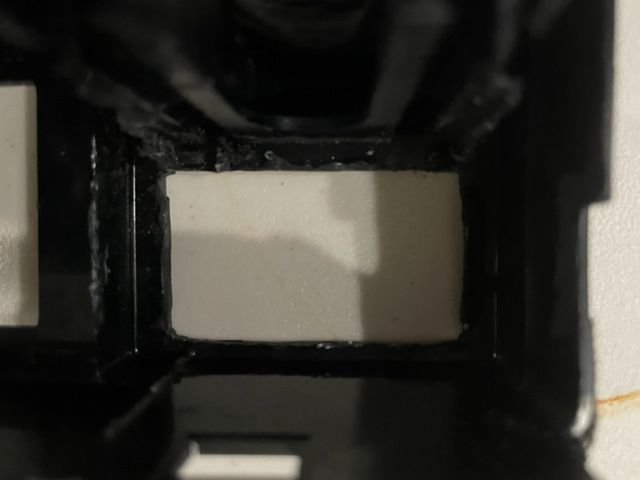

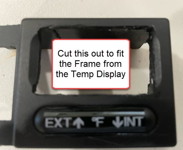

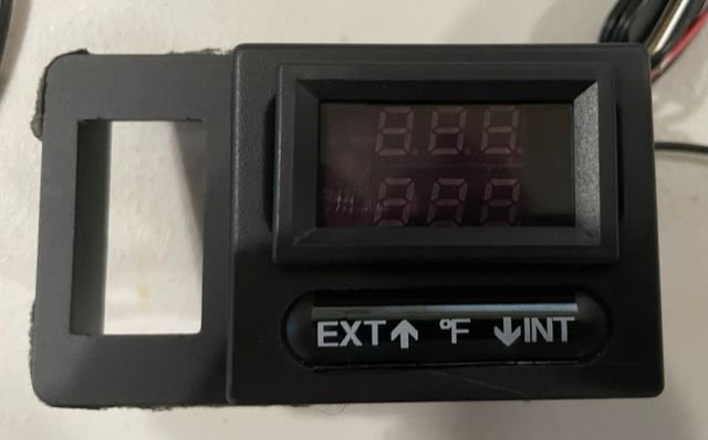

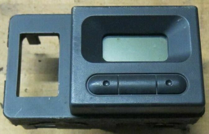

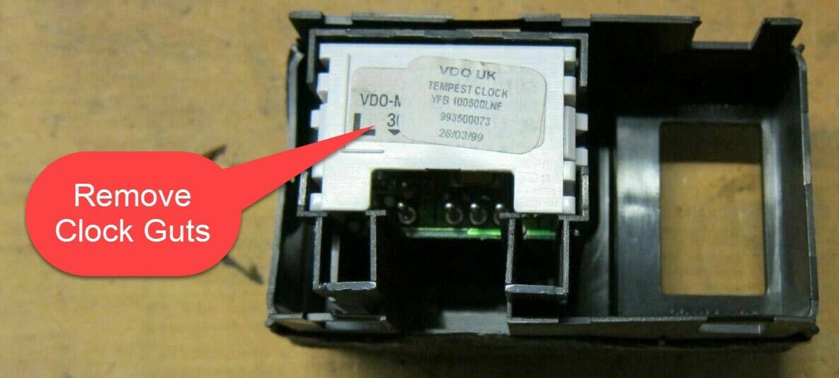

I then removed the clock, which is redundant since both my radio and my navigation unit display the time (as well as my phone, watch, etc.), and began modifying it to hold the new display.
Once I got the display to fit, I used a label maker for the legend and then began wiring things up.
I put the interior probe in the factory location, left of the steering wheel.

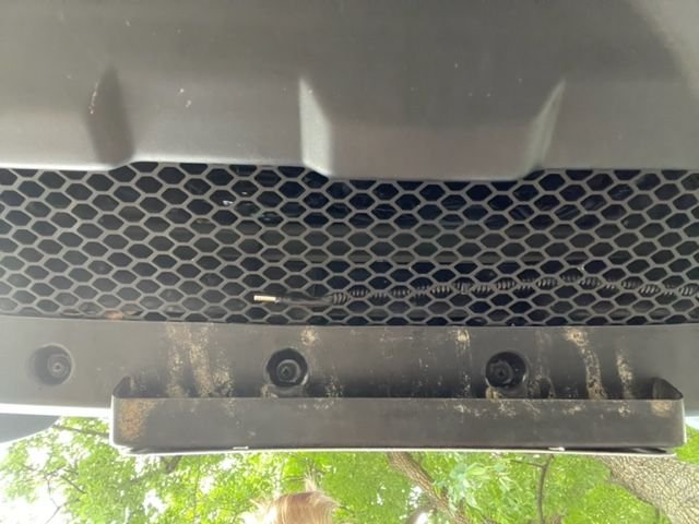

I put the exterior probe in the lower grill area under the bumper.
I ran the probe wire through the firewall on the passenger side. I tapped power and ground from the climate control, so it's only on with the ignition.
Here is the final result:
