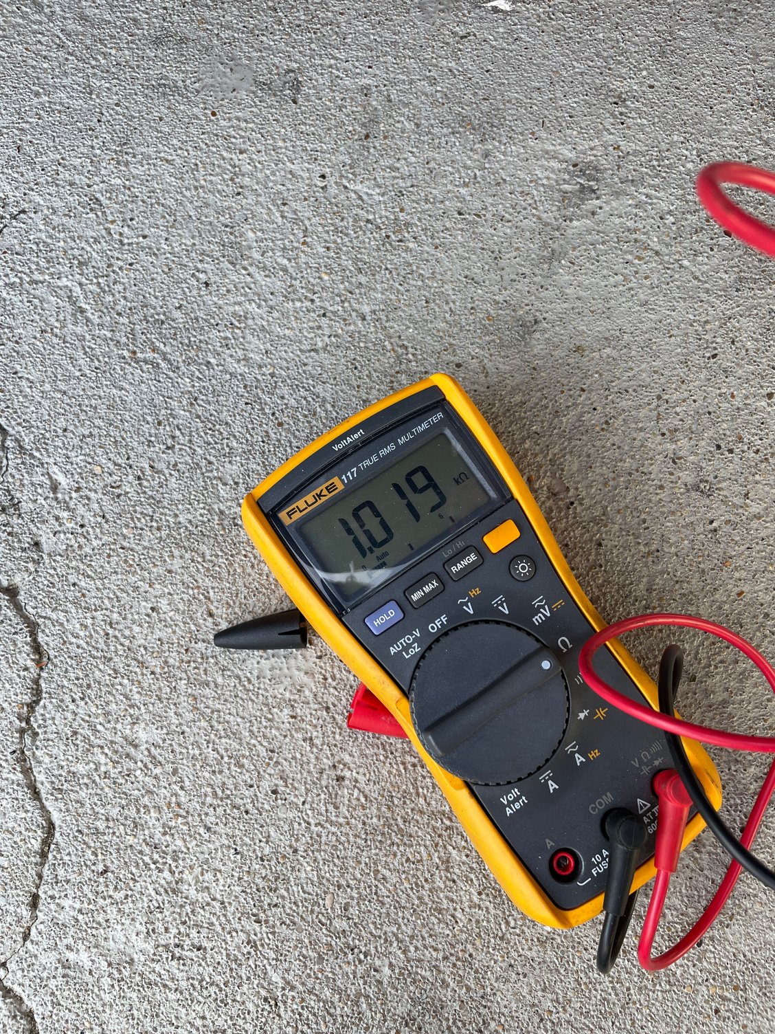

What do you all think? Three amigos, Nanocom points to abs sensor on back-left wheel. I tested the resistance on both sides of the connector and both have the same ohm reading. Experience tells me this means the sensor is good and that the hub is probably toast.

Where did you measure the resistance ? If at the connector near the sensor; it tells the sensor is in good compliance. But it does not matter a bit.
The reading of the produced sinewave signal has to be at the input pin of the SLABS computer. Takes an oscilloscope and contorsions to reach the connector to probe for the signal there. If the signal entering the computer is good and still fails, the computer is not seeing such or processing such.

I measured it by probing the end that connects to the sensor, but also the end that runs back to SLABS. Both were the same.

What I found is a "bad sensor" error does not mean the sensor is bad; means its signal is not being read by the computer. ( The sensor may be perfectly healthy )
