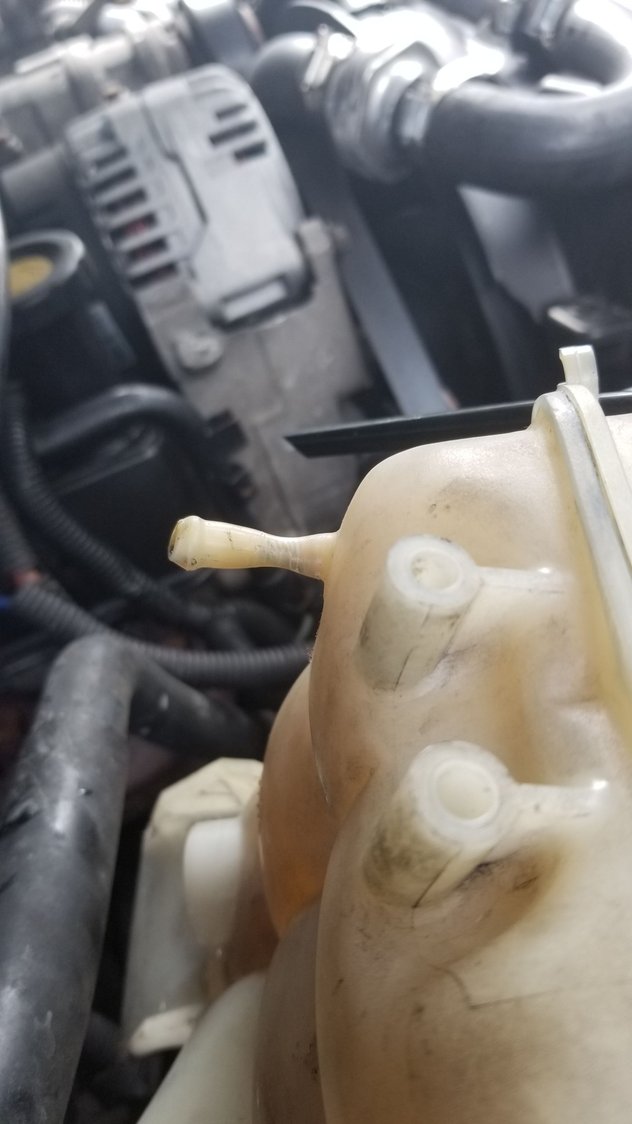

So I was seeing a little leak and found this...
looks like that might need replacing .

Not sure how you tighten a hose clamp that tight with a screwdriver. One reason I am a fan of the spring clamps.

I would suggest to do something like this and its a permanent fix. Hope it helps.
Drill hole slightly smaller than the threaded end of the barb.
JB weld the fix.
Force the tread into the plastic reservoir.
Drill a hole on the threaded part to reach the lowest level of the coolant.

What type of plastic is it? Does JB Weld bond correctly? I just noticed mine starting to weep last week, going to need to either buy a new tank or do some type of repair like this.

The reservoir was new when I did that. I know that part is weak and broke on me plenty times. Jb weld red n black or yellow n black

Or, if you're okay running without the throttle body heater you can carefully cut off the nipple and plug the hole with a short sheet metal or all-purpose screw, wrapped with Teflon tape. The only thing that line does is return coolant from the throttle body heater.

nice work Gerry. I was thinking of something along those lines.

You can buy a new OEM reservoir for as low as 20.00.

Agreed. Why try to repair a part that's so cheap and critical to the cooling system? Having owned many BMWs and Audis, the coolant reservoir is a part that you usually replace every 60k miles preventitively. They all get brittle from age and heat.
