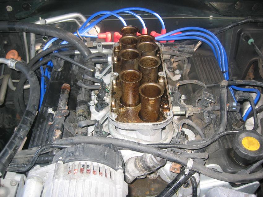

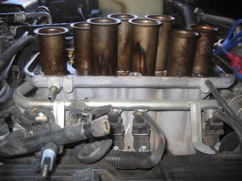

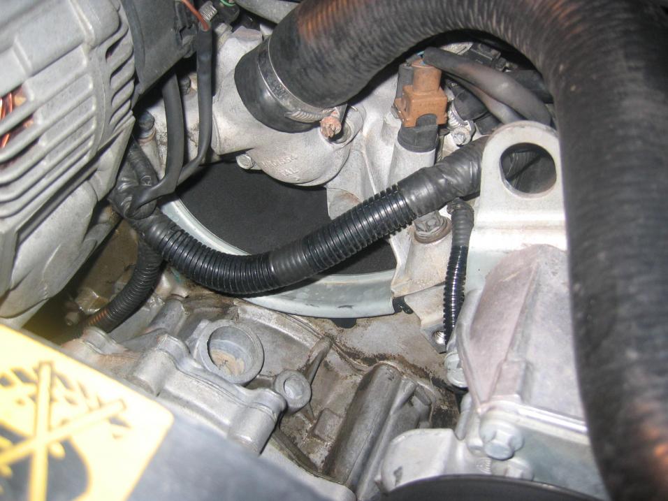

Just order the kit from AB, it will have everything you need including new head bolts and all the gaskets you will need and under $200. I did my headgaskets a few months ago. My left was leaking coolant in the front. When I pulled the right I could tell it would be leaking in the front in the near future. I wish I would have taken a picture of the right to show the weak area. I also replaced the thermostat while I had it apart. Get several cans of carb cleaner to clean your intake out as mine was very dirty even after an induction cleaning with seafoam. See my pics.
You will need impact swivel sockets and impact extensions to get the rear headbolts out. An 8pt 12mm socket for the exaust manifold bolts and an 8pt 6mm for the rocker cover bolts. If you have any questions let me know. Do you have the RAVE manual?
