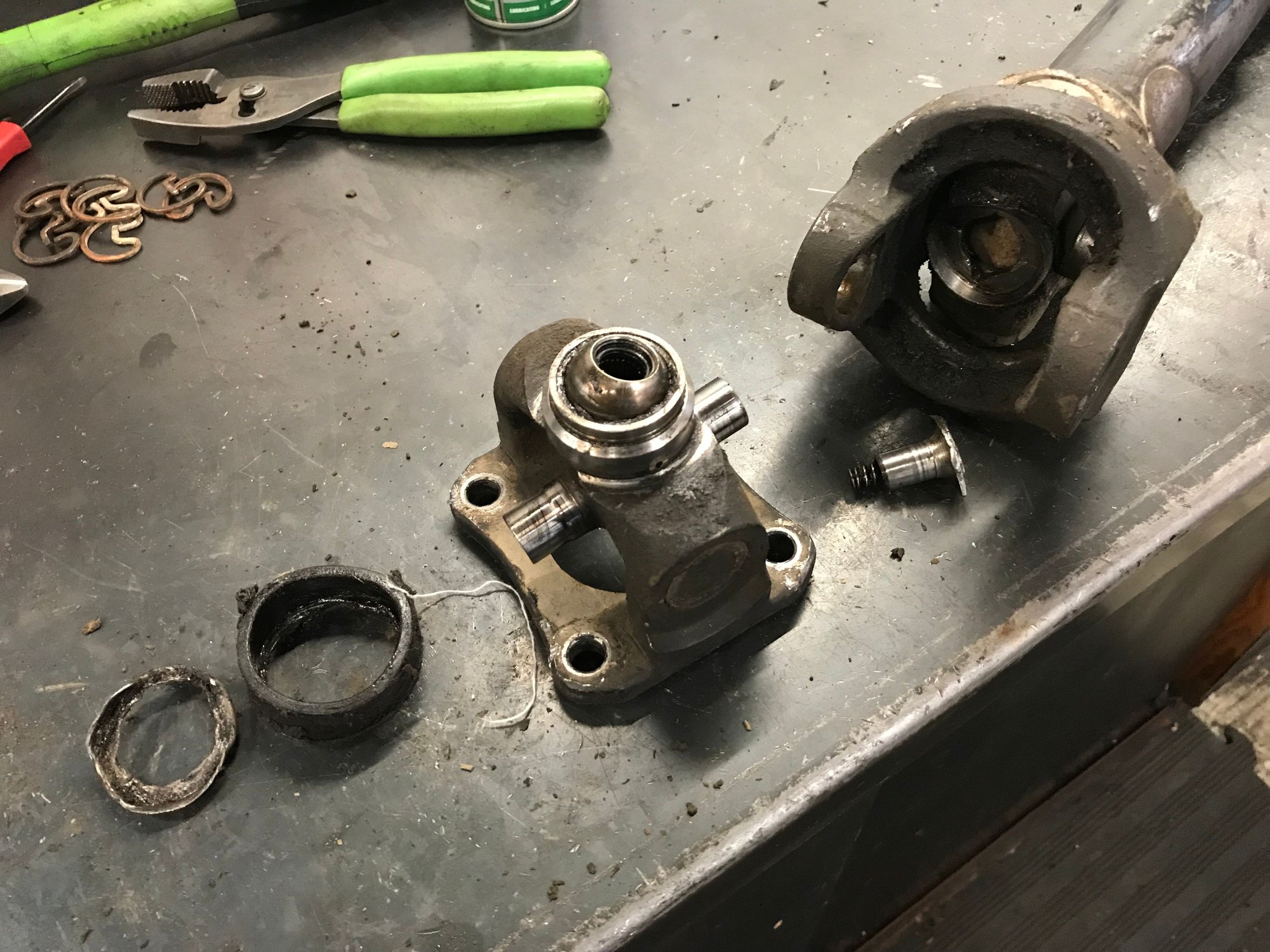

I've been greasing my front drive shaft regularly but wasn't aware that the centering ball needed lube as well. This weekend I was about 600 miles form home and the front DS started screaming like a banshee. I had just changed the oil and greased the zerks the night before, so I was plenty confused. Once I got the shaft out the double cardone was pretty stiff and it was making an awful racket even flexing it by hand. I did my best to get some grease on the shiny thing about the size of a pingpong ball and worked it back and fourth. It loosened up considerably and the noise got way better, but didn't go away so I threw it in the back and locked the center diff to enable me to drive home. Here's the state of the joint now, is this saveable or should this be rebuilt? I don't think I have a rubber cover (and don't see a grease fitting) so some spray chain lube is probably the best I can do on my own. There is zero play or slop in the joints and it's been balanced so I'd kind of like to try to save it, despite being a cheap aftermarket version.

This happened to my Tom Woods a few years ago. The independent LR shop was surprised by this as the shaft was only a couple of years old and greased religiously.

OK, so what I'm seeing here is a tear in the metal? The red arrow is pointing towards what looks like a sheared surface, and it came out of the piece that the green arrow is pointing at? Or did it break away from the dust cap thing in the red circle? Or, was it originally its own piece that just wore out?

Good eye Ahab. I am not sure. The pic came from the shop when they removed it. It was a few years ago. It does look like metal shearing off and maybe any sort of lubrication may not have helped at all.
