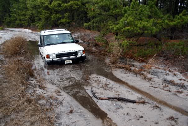

I know from experience that if you stop you'll get water in, but as long as you keep moving you should be ok for a while.
Experience:
I still haven't gotten around to getting a new CD player [:@]

hazlett,
doesnt the next picture in that set involve you getting your shoes muddy attaching a tow strap?

You mean these ones?
