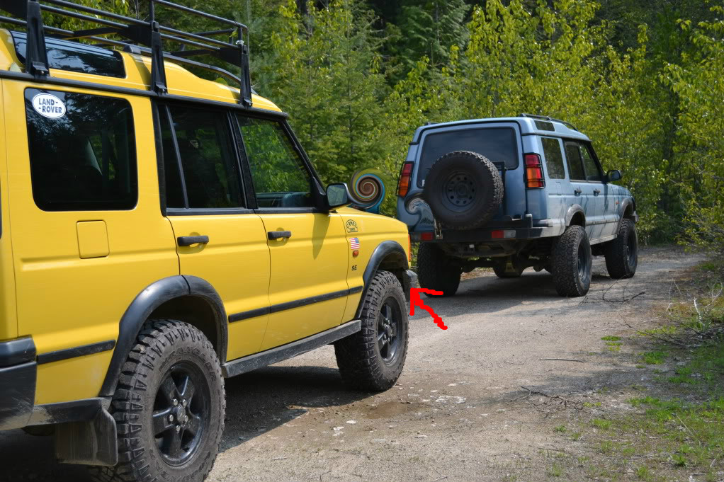

Those size will rub without the lift for sure, and probably rub pretty badly. I put my 2" OME on, and had the tires installed a day later and still had rubbing issues with my Saudi spec bumper (basically a trimmed version of the standard plastic bumper).
This is my Disco with 2" OME lift and 265/75 R16 Duratracs, the Red Arrow shows where I got some rubbing initially on tight left hand turns. Basically the inner splash guard inside the wheel well is what gets caught on the tread and it makes a racket like a son-of-a-B. I just unscrewed the panel, trimmed it with some beefy scissors, and tucked it behind the lower bumper piece that it was originally secured to.

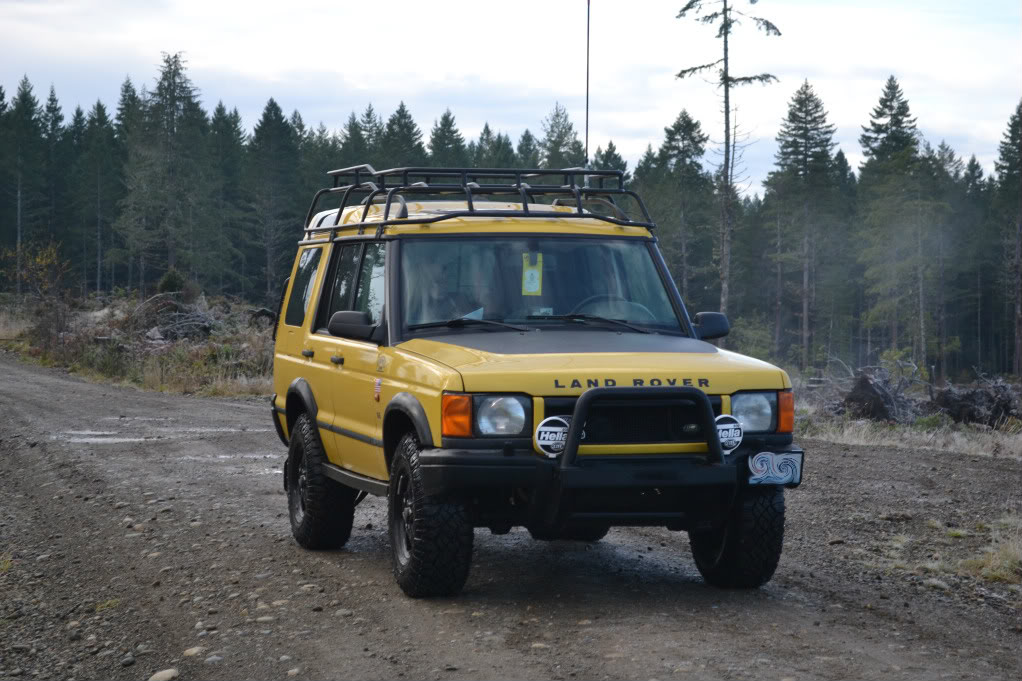

Here's a good shot to show you the stance with the 2" OME + 265/75 Duratracs, but I mostly did it because I enjoy posting pictures of my truck

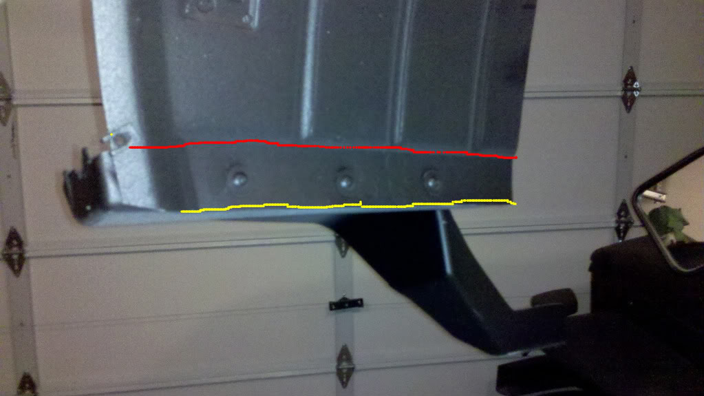

No, it was literally just the inner wheel well. I was only getting rubbing on the passenger side, but for illustration purposes this is the driver's side that is 100% intact. The yellow line is where the tire was catching, the red line is where I cut.
