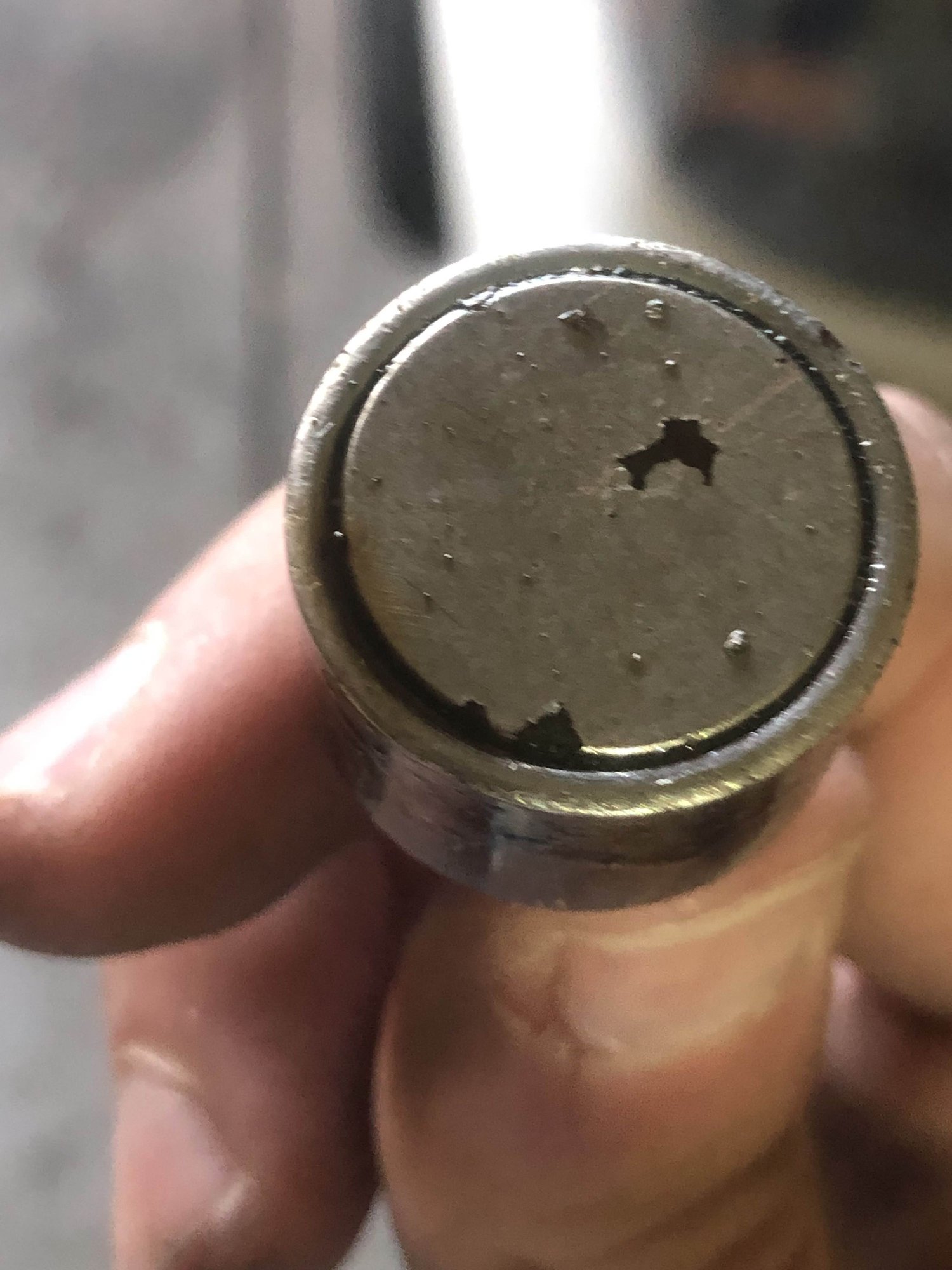

I took off the drivers side rocker cover, the arm on the very end moves side to side (towards front and rear of car not with rods and valves) and makes a noise. It is stiff with in the direction where it makes contact with the valve and pushrod. The arm on the other side does it a little bit, and the rest are dont.

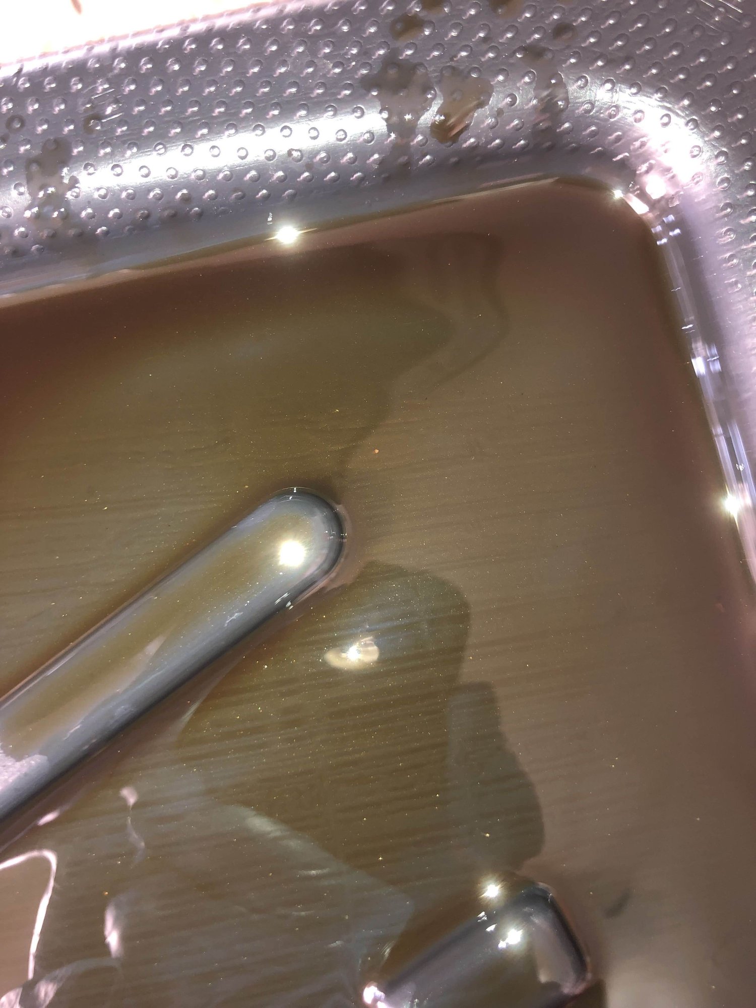

I drained some oil by taking off the filter when I replaced a seal today and noticed the oil was a little glittery. Is this normal since I just rebuilt the engine, or is it eating itself from the inside? Note the oil was already changed once since the rebuild.

Sounds like a classic slipped liner noise, but it could be something else. To rule out other issues check the oil pressure, low at idle can cause the top end to tick and will go away with revs. Also get that exhaust leak fixed, shop vac or leaf blower in the tailpipe.

Sounds like a slipped liner to me as well.

The sound is deeper that a lifter, but silver in the oil is a bad sign.
Do the slipped liners also make noise when cold? I hear knocking when cold, but it seems louder when warm. Maybe its just easier to hear when warm since the exhaust leaks seal up.
Can the silver in my oil just be there because things are still breaking in since my recent rebuild?
Could be, a bit unusual but I have heard them tick stone cold.
Could be
