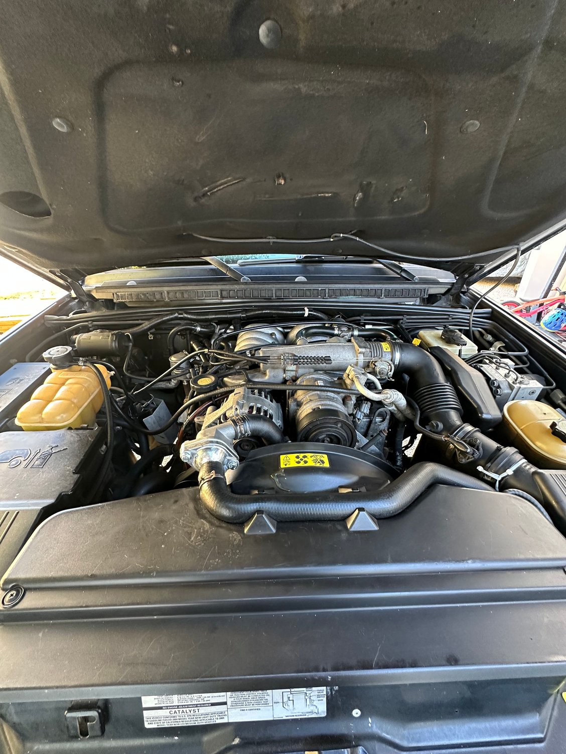

Hello everyone. I have what sounds like a knock coming from the engine of my 04 Discovery. It only happens after driving it around town for 30+ minutes. Noise is only at idle, and if I leave it idling for a while, the noise randomly stops and starts again. Coolant temperature doesn’t go over 198 on scan gauge and the truck runs completely normal. I changed the oil just to inspect the oil for any evidence of metal/bearing failure and the oil came out clean. I also installed an oil pressure gauge to verify that it isn’t low oil pressure and the readings are within spec. Below are the cold and warm pressures.
Cold idle - 51psi
Cold 2000 RPM - 52 psi
Hot 2000 RPM - 49/50psi
Hot idle - 18/19 psi (194 coolant temp, 102 ambient temp)
Could this be a slipped liner? The previous owner told me he had the head gaskets replaced. I unfortunately don’t know how much it was overheated. Just odd that it didn’t make this noise when I test drove it for 45+ minutes before buying it. Any input would be greatly appreciated.

Because you checked the oil pressure and it checked good I'm going to say it likely as a slipped ladder, however all is not lost, many times the slip liner problem can be corrected by getting the engine to run cooler. Suggest you switch to the inline thermostat with a 180° thermostat and it likely will never get as hot as 198 again. If you want it definitive answer be sure to notice at what exact temperature it starts knocking

Just wanted to thank everyone and provide a quick update. I installed the inline thermostat with a 170° thermostat and the sound is gone for the time being. I know most people recommend the 180° but with me living in Florida and for troubleshooting purposes, I figured I’d try the 170°. Temps have stayed consistently under 190° and the truck runs great. I knew going with the 170° that the truck would throw a code, but I don’t mind.
