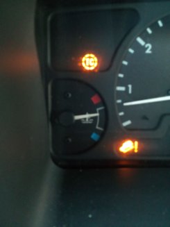

Here's what happened to my 2000 Disco 2 with 182K miles: first, have a look at the pic of my normal operating temperature, as indicated by the temp gauge.

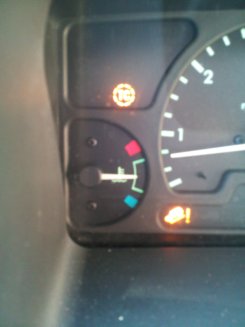

1. After driving for a bit, I came to a red traffic light. After sitting at the light for a few minutes, the temp increased noticeably. See "temp after sitting.jpg".

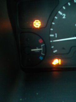

2. In response, I turned the heat on. NOTE: the heat was hot for about two minutes, before it began to blow cool air. That brought the temp down some. See "temp after turning heat on.jpg".

1. Is my normal operating temp "normal"?
2. What would cause my temperature to fluctuate like that?
3. Is or could the loss of heat be related?

It got hot because there is not enough coolant in it to keep the engine cool.
There was no heat because there is not enough coolant in it to carry heat to the heater core.
Add coolant, find your leak.
