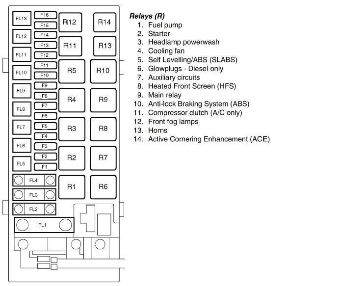

Try the relay for the starter. Found in the engine bay fuse box.
See attached picture. #2 is for the starter. You can unplug #3 and put it into #2 spot.
Thanks! Sadly, that didn't do it. It's a bit dark out at the moment, but I'll grab a friend tomorrow and see if I'm getting 12v at the relay. I know my Ultraguage is getting 12.45V and the headlights don't dim when you try and start the car, so I think the battery can be ruled out.

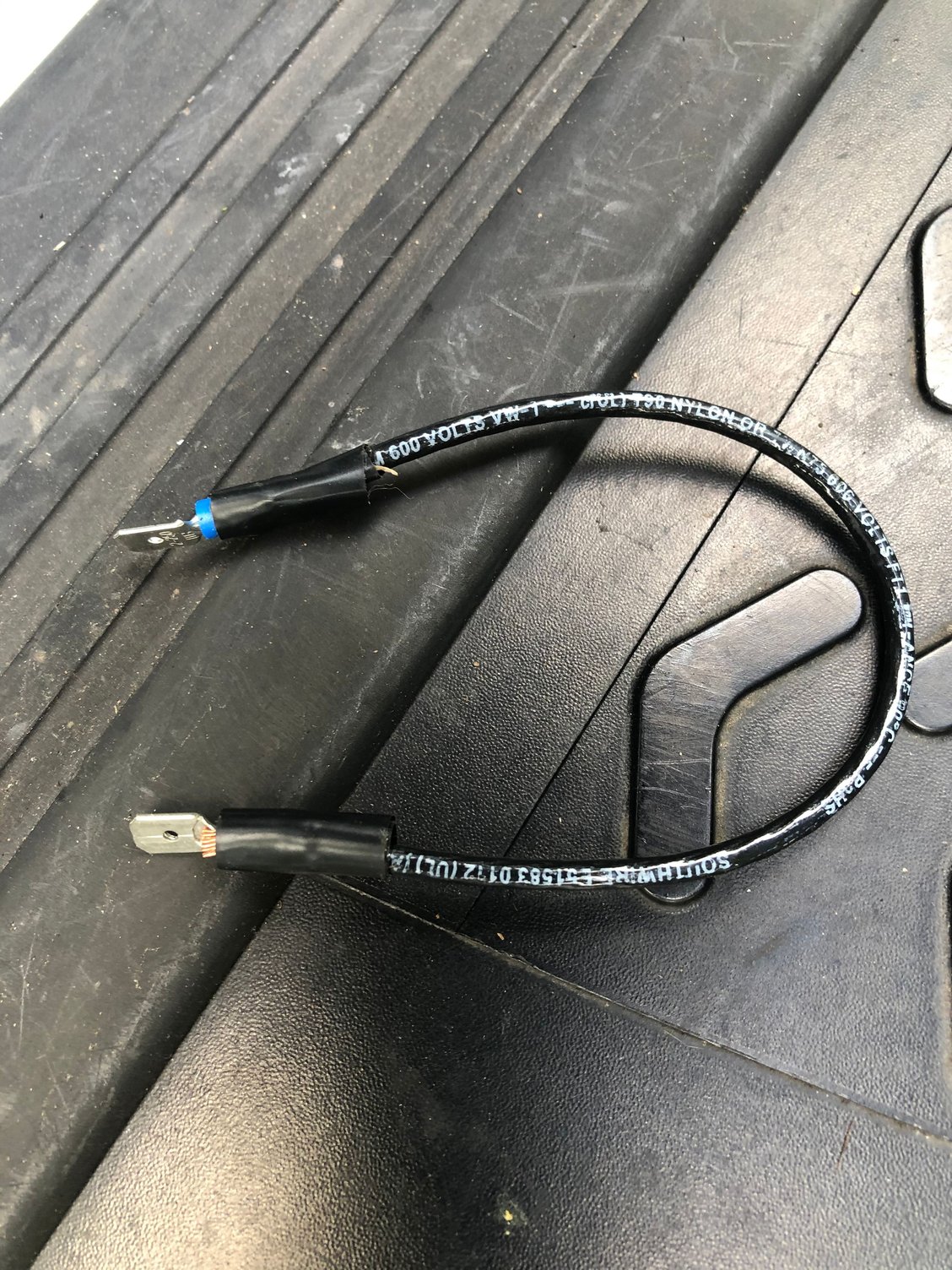

30 and 87 are the ones to jump. You can do this with a wire with two male ends that fit down into the fuse box's relay connections (see picture). If you have swapped relays this may not be worth doing since the probability of 2 relays going out is slim.

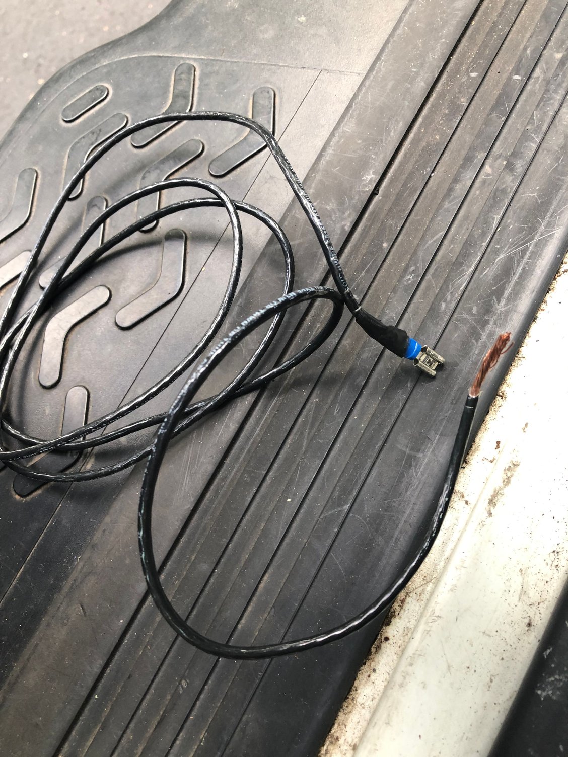

2. Create a wire with a female connector and unplug the "S" connection wire from the starter and connect your wire with the female connector to the starter. Then hold the wire to the positive connection to the battery. (see picture)
Important thing for both methods is having the key in the II position. This is the same position as when you are driving. You don't need the key turned all the way so this is a one man operation.
