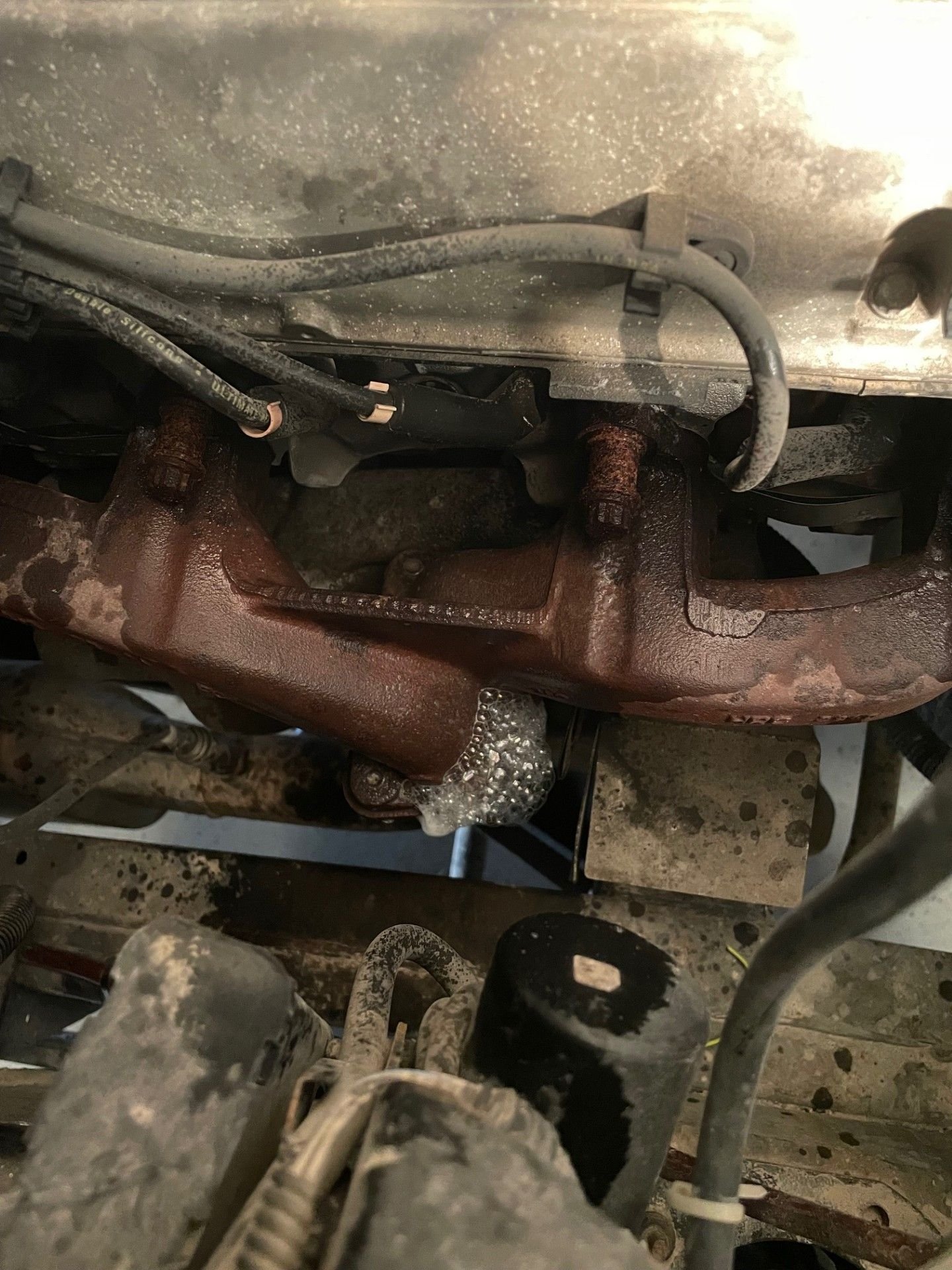

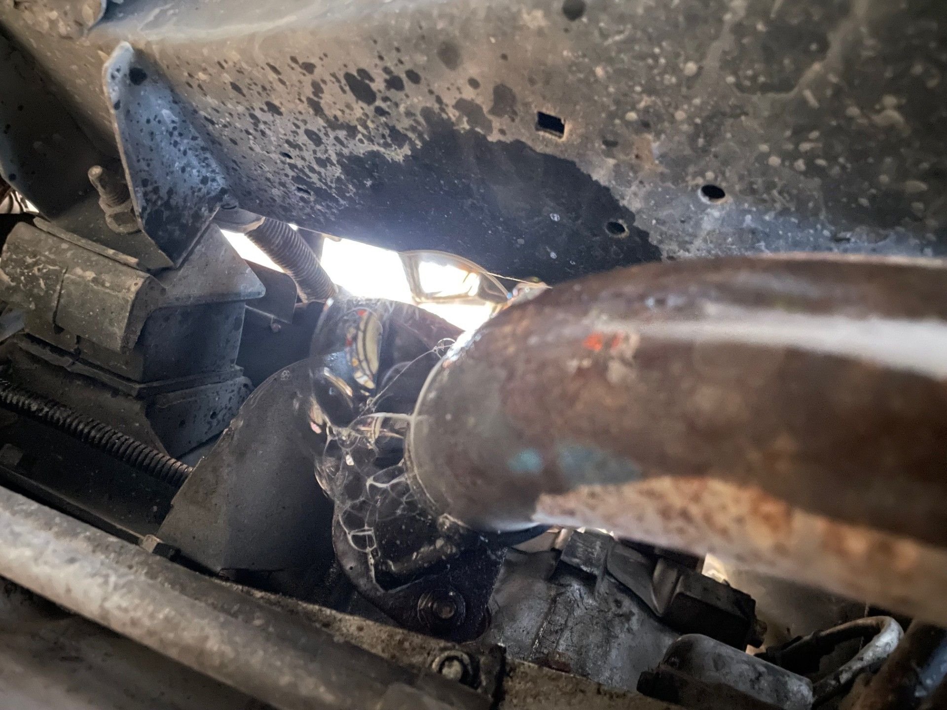

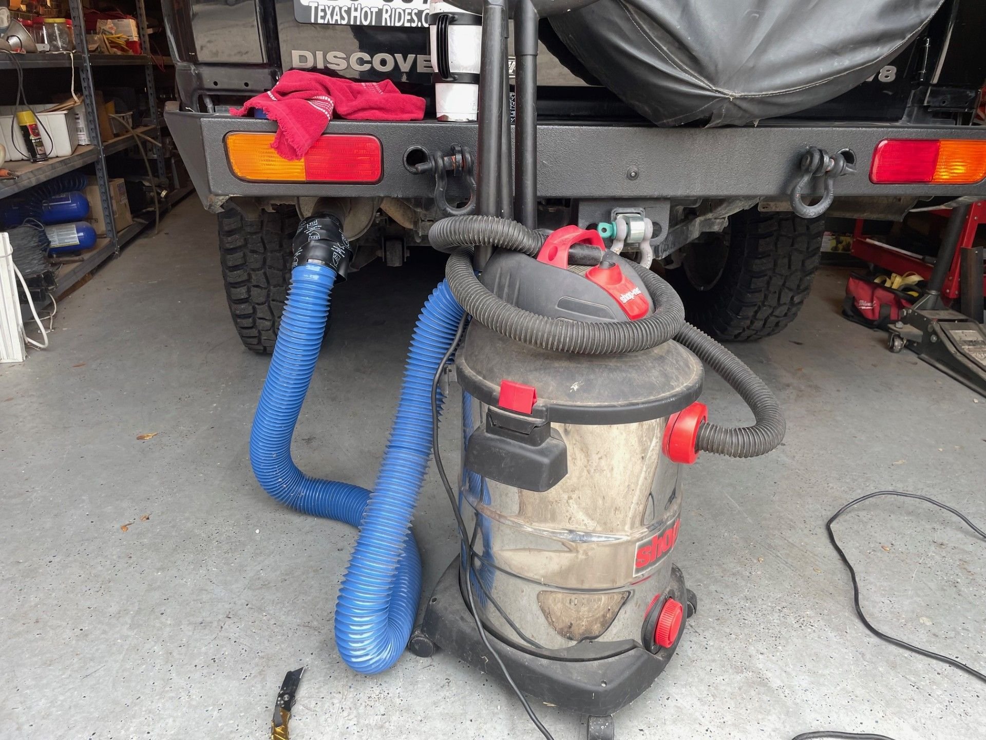

I've had an annoying exhaust leak for some time. I finally decided to do the reverse vacuum in the tailpipe and spray the exhaust down with soapy water. The culprits appear to be the gaskets between the exhaust manifolds and the Y-pipe. Is there a better aftermarket gasket for this area or is OEM the way to go? Thanks.
