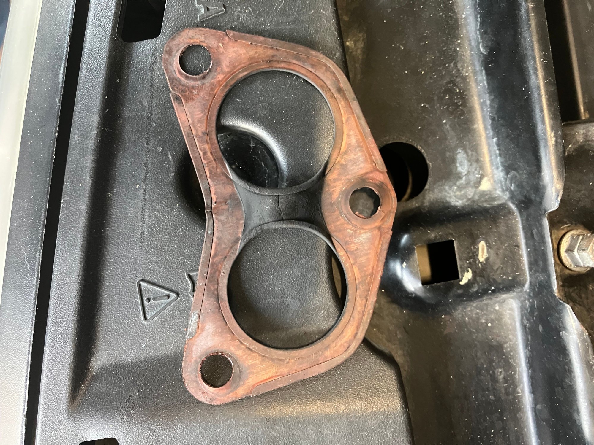

Hi all,
Strong exhaust smell In cabin and my inlet air temp raises over 170 when idle. I have no oil leaks (knock on wood). This is not the “all D2 smell funny” I’m getting light headed while driving, it’s a problem.

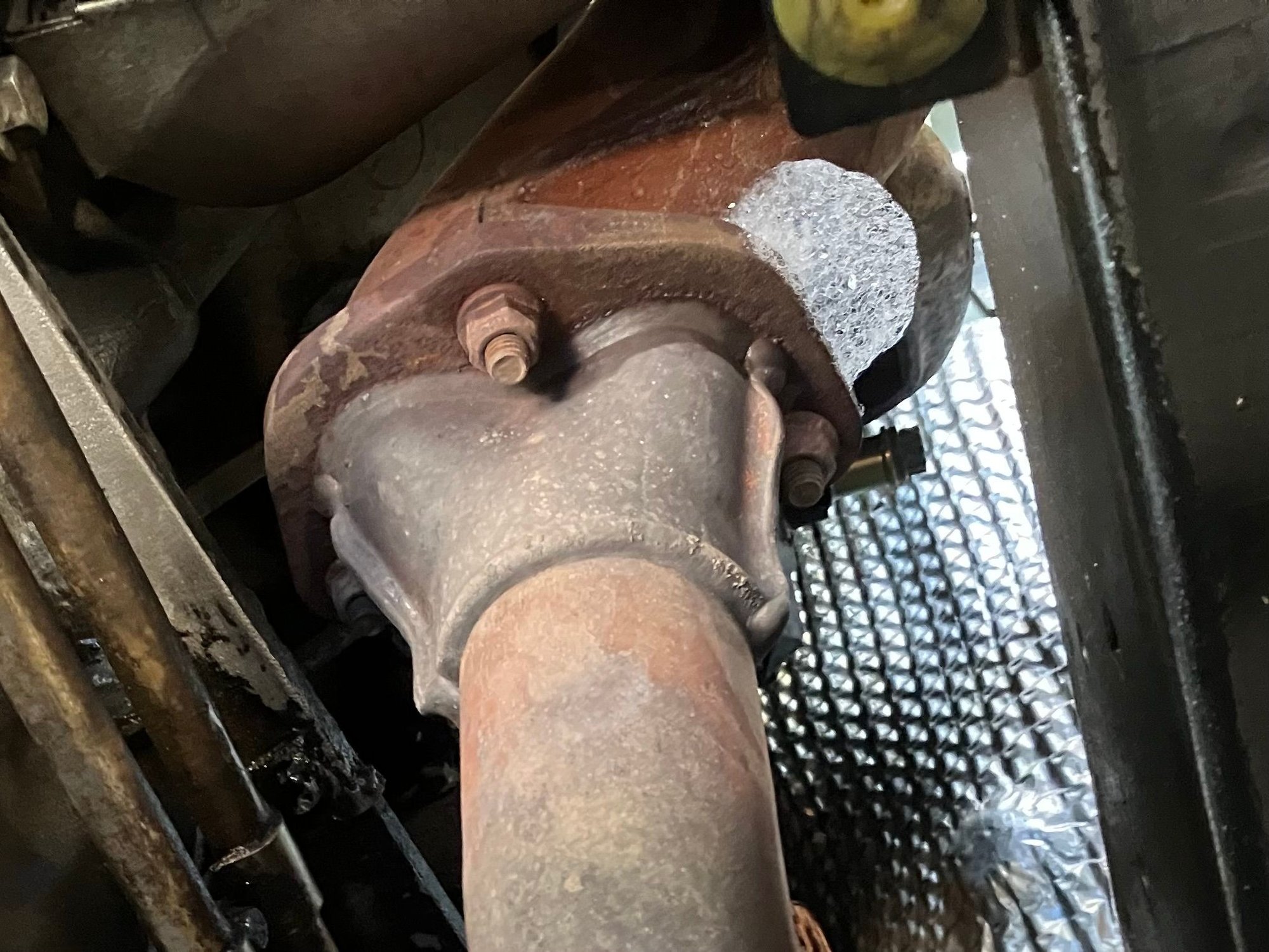

I did connect a leaf blower in the tail pipe and sprayed soapy water all over exhaust system, I only saw bubbles in the manifold y-pipe connection (see picture) in both sides. Leak is small enough to not create a ticking sound.
I have taken the nuts from stud on both sides and replaced y-pipe gaskets, retightened to 22-24 lb-ft. I didn’t remove studs as nuts came off easily and studs seemed to be just fine. The leak persisted as if I had done nothing .
i tried copper gasket maker on the outside of the flange and it held for couple days until the gasket came off, during those days the smell disappeared which sort of confirmed the leak location. I disassembled the connection again and used the gasket maker on top of the metal gasket, that was a terrible idea, the gasket maker pulverized away and left a bigger leak of course. I removed the gaskets again and cleaned the mess (lucky cat didn’t go kaboom) and reassembled, I’m back to square one. Smell is there.
I did replace the moulding cawl since it was broken, I was hoping it would minimize the smell but it didn’t. I have also checked carefully for cracks in the y-pipe flange and there is none.
today I decided to taken it to a muffler shop, the said he couldn’t find a leak, I showed him the picture (after he tried to diagnose the problem to avoid bias) and he said that leak was very small and that I should check the AC vents as they might not be closing for proper recirculation.
im guessing y-pipe connection is warped or somehow defective and I need to replace the entire exhaust system, but I don’t want to spend that amount of money without checking all options.
can someone share any suggestions on how to fix this issue?
thanks!
Old gasket

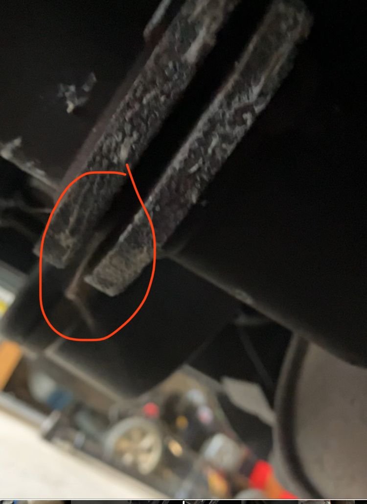

It makes sense, thanks for taking the time. I spent 3 hours this weekend trying to figure this out. Connected a leaf blower to the tailpipe and sprayed exhaust and SAI. Couldn’t really see any bubbles on SAI. The exhaust had the usual small leak in y-pipe and something new to me was the leak in the muffler connection to the pipe (see video). I don’t know if that leak is designed to be (muffler breather to drain condensation) or is a genuine leak. The fact I don’t hear any rambling sound makes me think is a small leak but not sure if that would cause the smell in the cabin? Perhaps when idle fumes would get in? Not sure. It is definitively not the cause of rising inlet air temps.

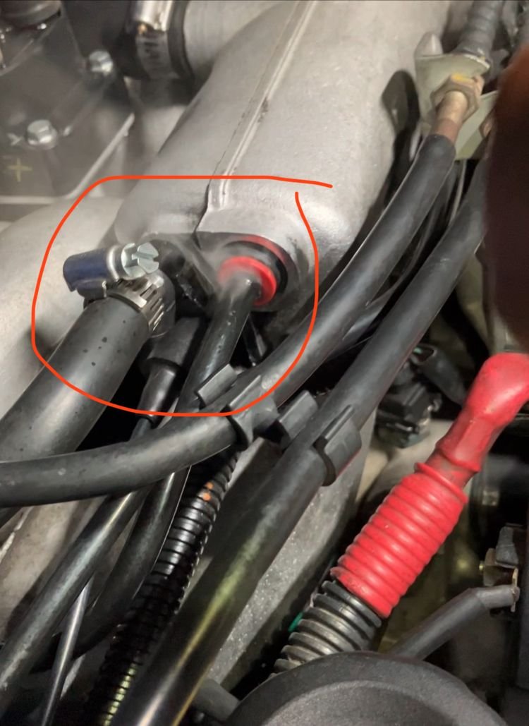

@The Deputy I ran the smoke test, first time I do such a thing so I will describe what I did for process scrutiny.
I disconnected the MAF sensor bracket from air intake hose and plugged the smoke machine (SM) to the inlet, stuck the throttle body valve open and pumped the smoke. Smoke immediately leaked from brake servo hose and breather hose on top of inlet manifold (see picture), leak was big. I sealed it with some RTV and retested, leaks are gone and no smoke leaked from inlet manifold or valley and nothing on SAI pipes or valves.
I then proceeded to disconnect RH oxygen sensor and plugged the SM, plugged tailpipe and pumped smoke. To my surprise there was no leaks, just a mini leak in cat to muffler connection (see pic). I know the system was pressurized because the rubber glove I used to plug the tail pipe was inflated holding the smoke.

Follow up:
sealed upper manifold leaks and the smell subsided substantially, I think you were right @The Deputy, the air inlet temperature increase also slowed down but still gets pretty hot (150 deg) it just takes longer to get there.

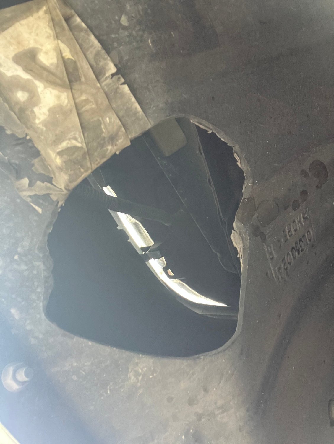

i think I can deal with smell but want to focus the discussion on the raising AIT, I found something new I hadn’t identified. Look at this hole on the back of the passenger side bumper
I have no idea why that is there, hole was made during Prior ownership.
2 questions:
- any clue why someone would cut a hole there?
- would the hole have any impact on raising AIT?
@Extinct
