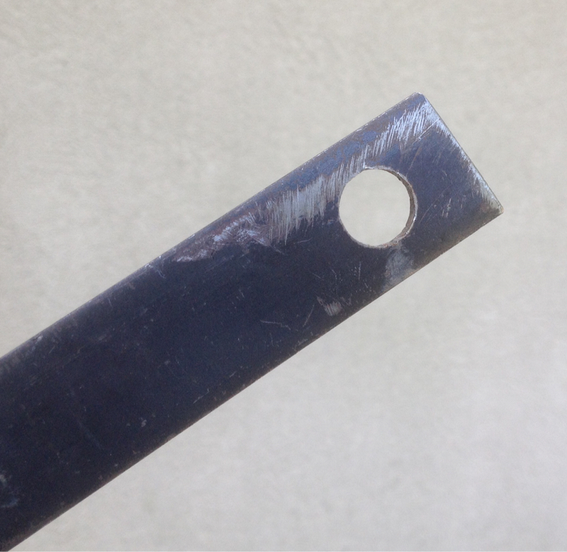

I went to Lowe's and bought a 3 foot piece of 1 inch wide steel bar that is probably about an eighth of an inch thick. I cut it in half to end up with two 18 inch pieces, and then drilled a hole near one end of one of the bars just large enough to slip over one of the pulley bolt heads (3/8" ?).
I set the bar in place with the hole over one of the pulley bolts at roughly the 7 o'clock position on the pulley and the right edge of the bar (facing the engine) against the outside of the next bolt on the pulley that is in roughly the 10 or 11 o'clock position. That keeps the pulley from rotating counter clockwise while trying to remove the fan.
I know that explanation may not be the clearest ever but this solution essentially does what the tool pictured above does and costs about $5 instead of over $40.
