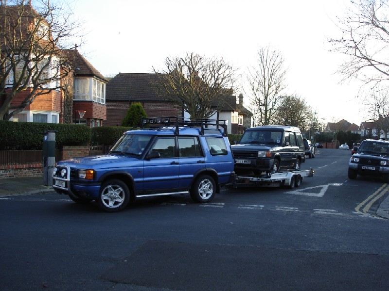

5. I've seen where the towing capacity is listed as 5,500 lbs...is this a realistic number?
Well, heres mine when i picked up my new toy a D1 v8. that weighs 4375 lbs, the trailer weighed approx 800 lbs, so Id say its pretty realistc

Urban, from that pic it doesn't looked weighed down at all so I confident I would not have a prob pulling my jeep.
