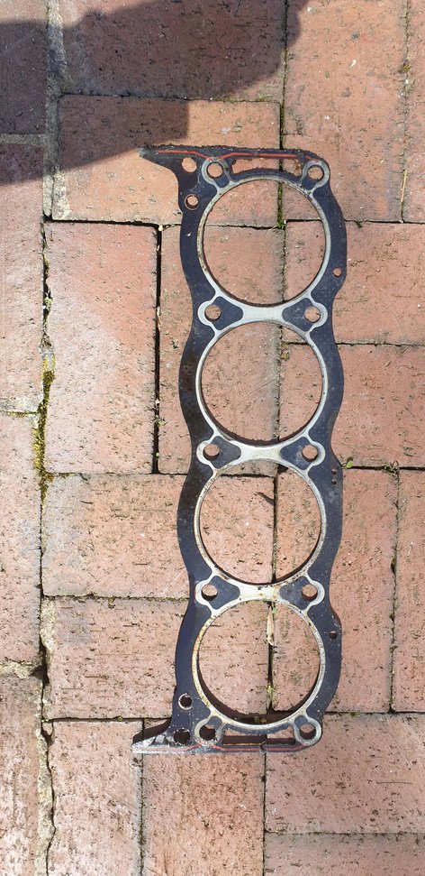

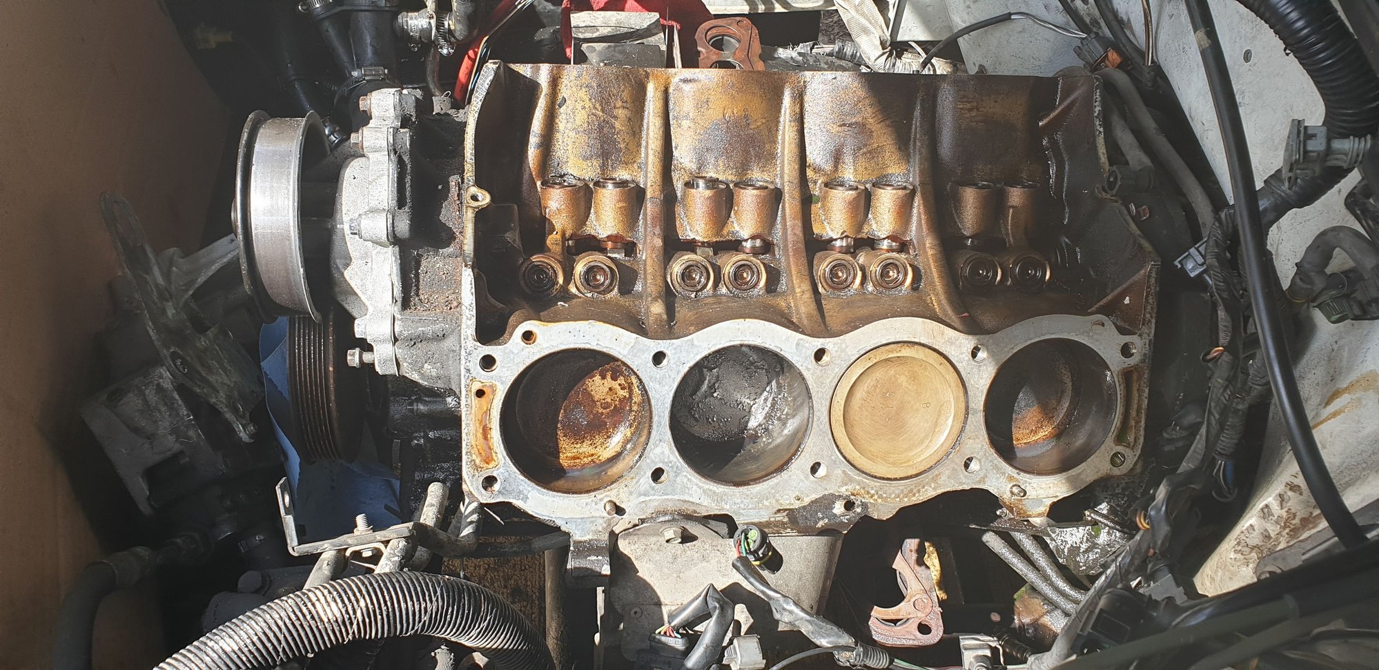

Pulled the heads this weekend.
I'm no gasket whisperer, but they didn't look obviously blown to me.
The 2 impossible lower rear head bolts were not Nearly as hard to break as the rest, for whatever that's worth.
No obvious steaming in the combustion chambers... Piston 5 looks quite clean though.
Also, no obvious signs of sleeve slippage.
Any thoughts... Should I flush the rad and heater core while it's all opened up to make sure that flow is good?
What else can I look for if the heads don't seem to be problematic. Taking the heads today for hot tanking and pressure testing and surfacing... Should I have them fluxed to see if there is a crack, or will the pressure test reveal this?

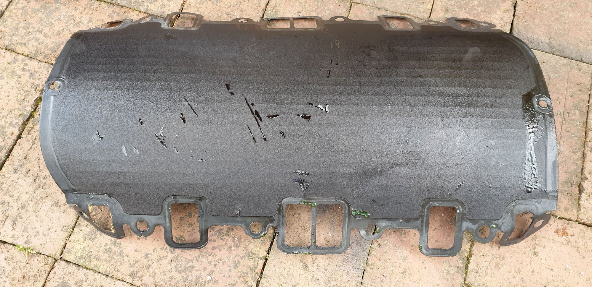

Pics below.
Thanks much!

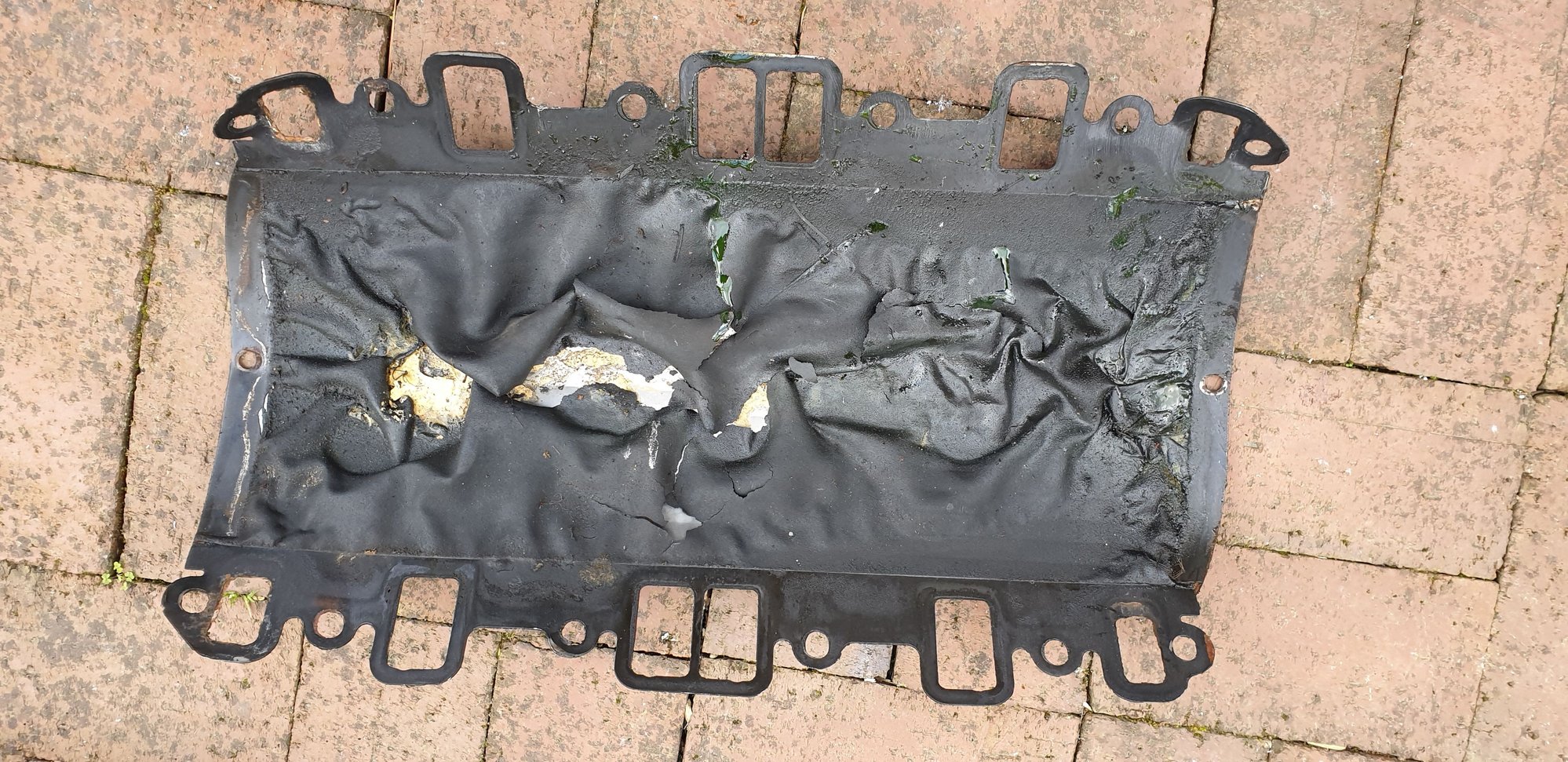

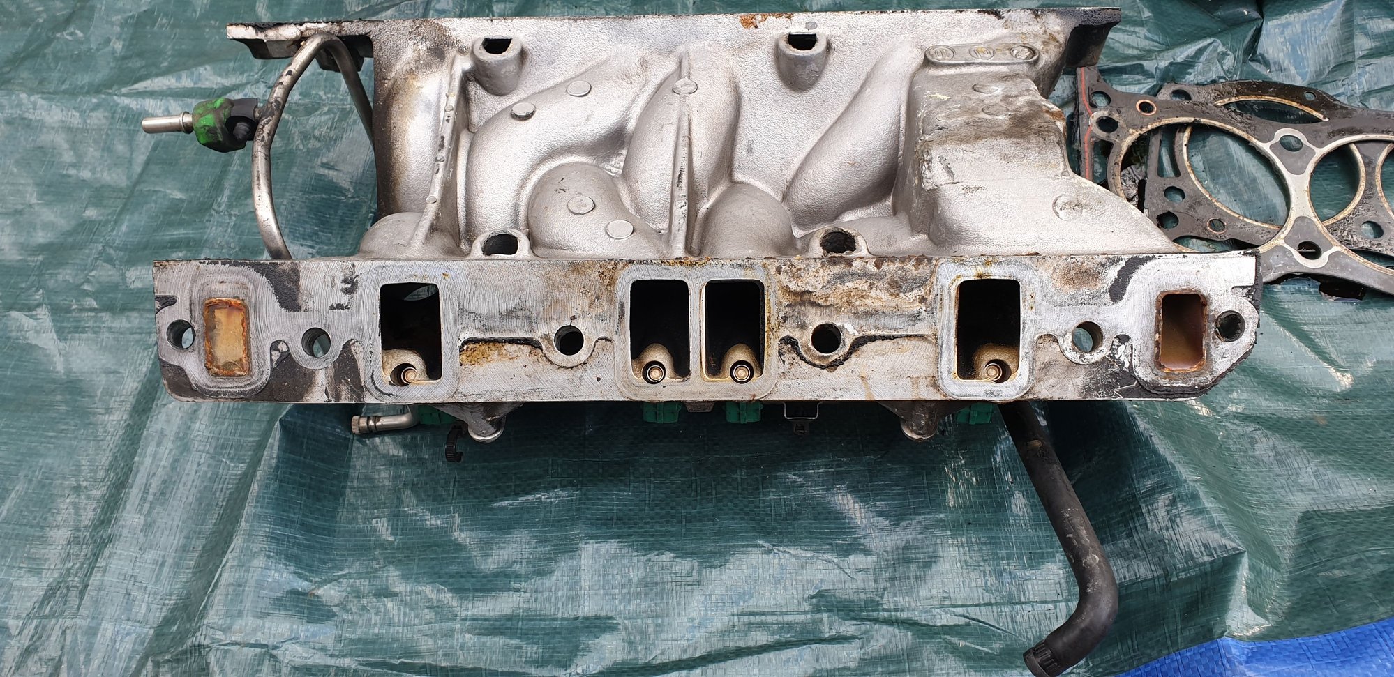

Left bank looks weird to me...can you post pics of the intake gasket & ports?

The 3rd cylinder from the front left side is way too clean compare to the rest. My bet is that is where your problem was/is

Yeah, thought it was strange that #5 was so clean, but the combustion chamber shows plenty of buildup... Although the valve heads look a bit clean as well.
Additional pics attached as requested.
