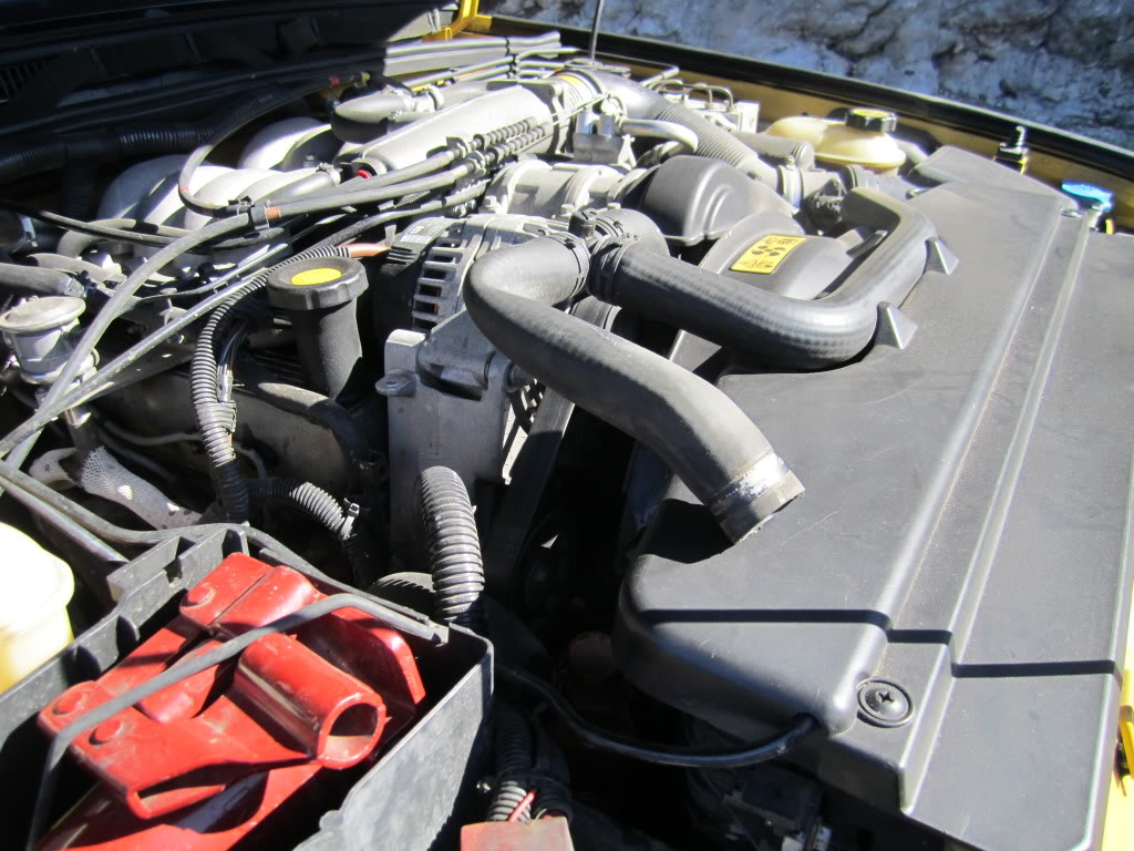

I can post pics later, but here's how it failed-->The top lip if the vertical portion of the thermo was crumbling, and broke off, so that combined with a failing clamp and a pothole strewn rode, caused the hose to work it's way off the top of the thermo. Driving back down I could see my trail of fluid in the gravel road
Admittedly, I'm not positive when the thermo was last changed, as it isn't documented in the service records I got from the PO. Ironically, I getting ready for a coolant system overhaul this summer since it has finally started to warm u here. I have had a coolant leak for the past year and have replaced all of the coolant through topping off.
I had added some AC Delco coolant system seal tabs recently and my coolant leak finally stopped, and I wonder if this played a role in the thermostat failing??? I am not able to begin tearing into it until tomorrow as this weekend is jam packed, and I will update when I can pop the thermostat open to inspect it.

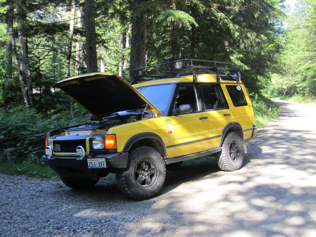

Not going to lie, it was a pretty great spot for a break down MUCH prettier than the side of the highway.

Here is the detached hose....

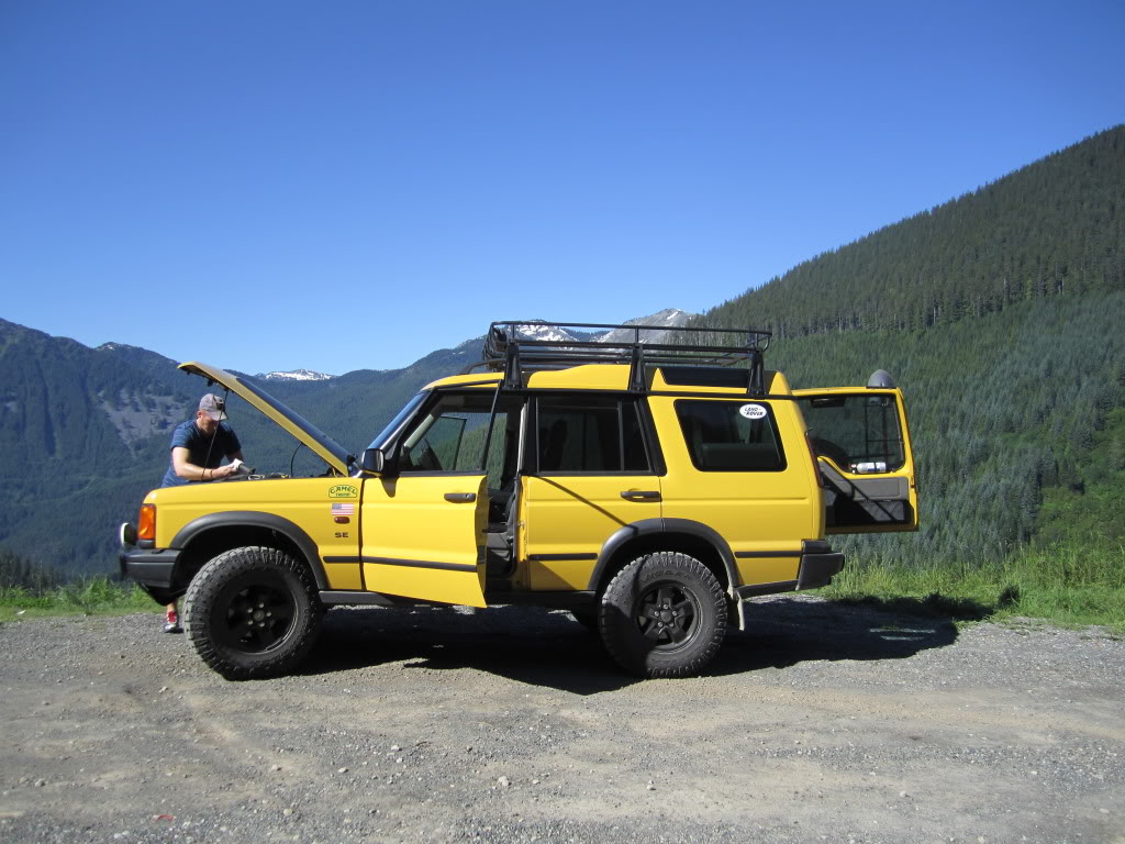

Stopping to get water from some campers...Land Rover with it's hood up and flashers on, how cliche'...
