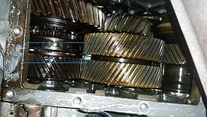

My last thread went stale so now all I want to know is if there is any way to manually lock the collar over the dog teeth? Is there a spot from the inside or outside that I can push on it to get it fully locked in?? The lever itself doesnt seem to push it far enough.. Even with the cable disconnected..
From the bottom, I can see that my collar seems a bit loose and will not go all the way into locked position against the gear. I am reluctant to really force it, but if you guys have any advice, I will try it. could I crow bar the thing without damaging anything?? I have had the truck 10 years and never once shifted out of 4HI and I don't plan to either..

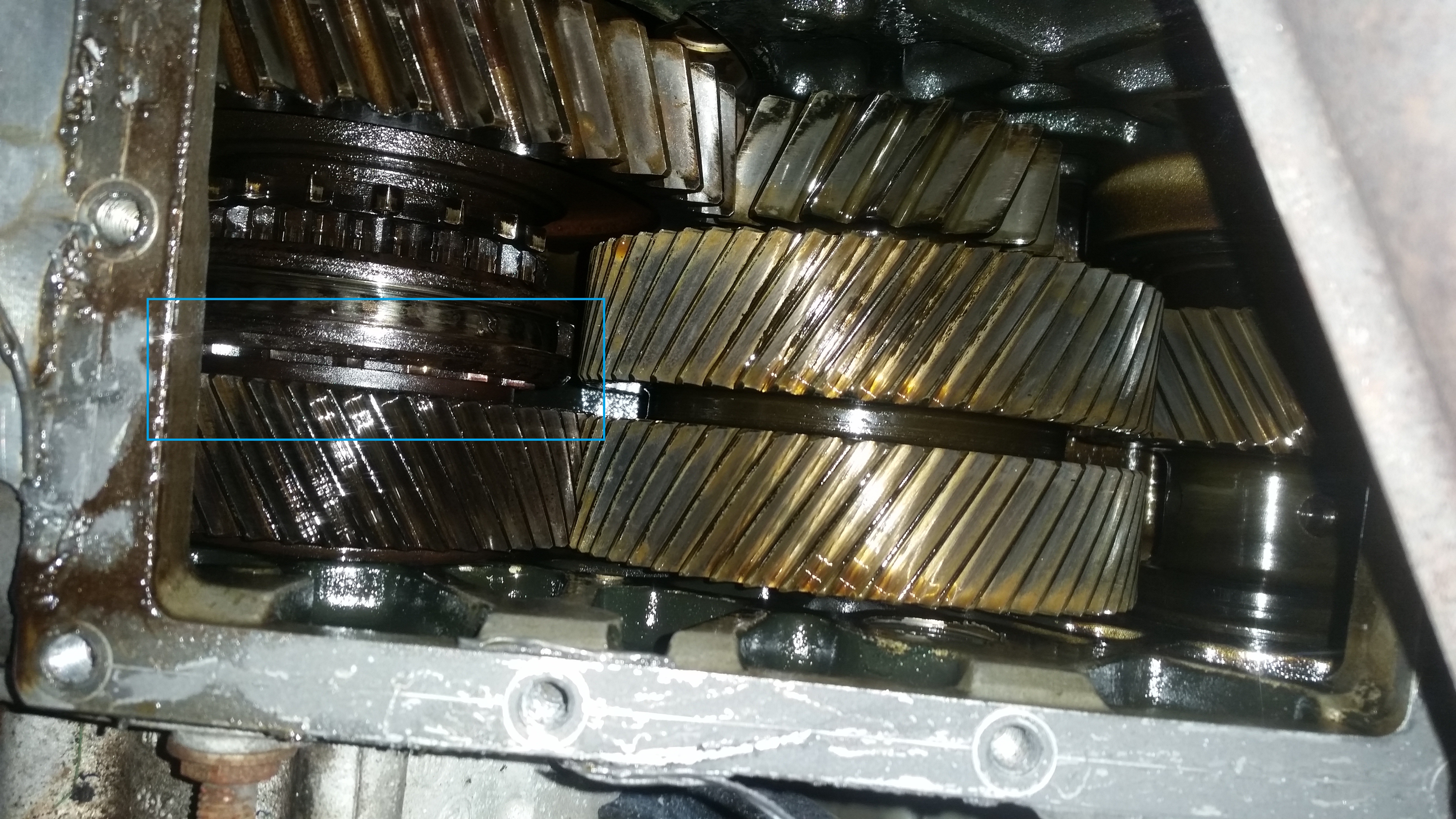

So I dug around today and pulled out my detent screws and springs and found out I forgot to put the detent ***** back in it. The ***** are back in it now and it seems to engage the H-gear a bit better but not fully. I can still see about 1/32 of an inch of teech that are still slightly exposed in front of the dog clutch. Could the detent ***** have been causing the transfer case to want to slip out of 4H while driving? I put them back in and got the screws flush with the case and it didn't seem like there was a lot of load on the the screw when I was turning it.

Figured it out... When putting the T-case back together, the dog collar shaft was not lining up correctly. So I held the collar in 4 High with a pry bar while we installed it.. now it works just fine... so far
