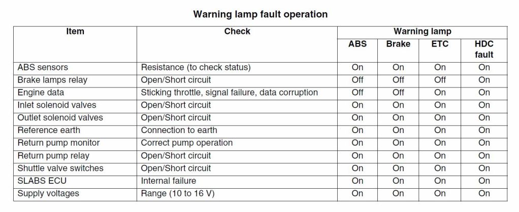

'Hill descent', 'ABS', 'Traction control' and 'Brake' showed while smoothly running, a mile after replacing rear brake pads.
Is this a new one or a known one ?

Get or rent the scanner, I did and am glad I did cause it could be any number of these things
