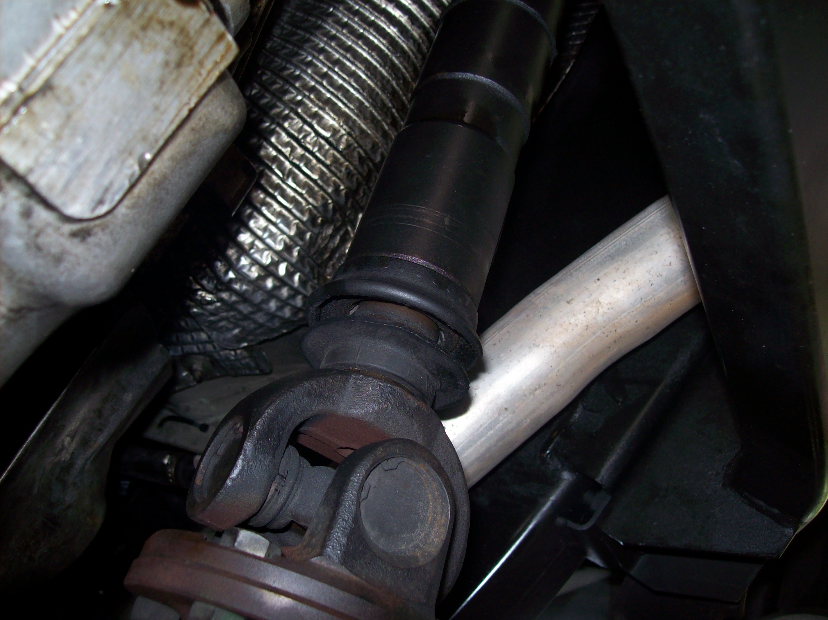

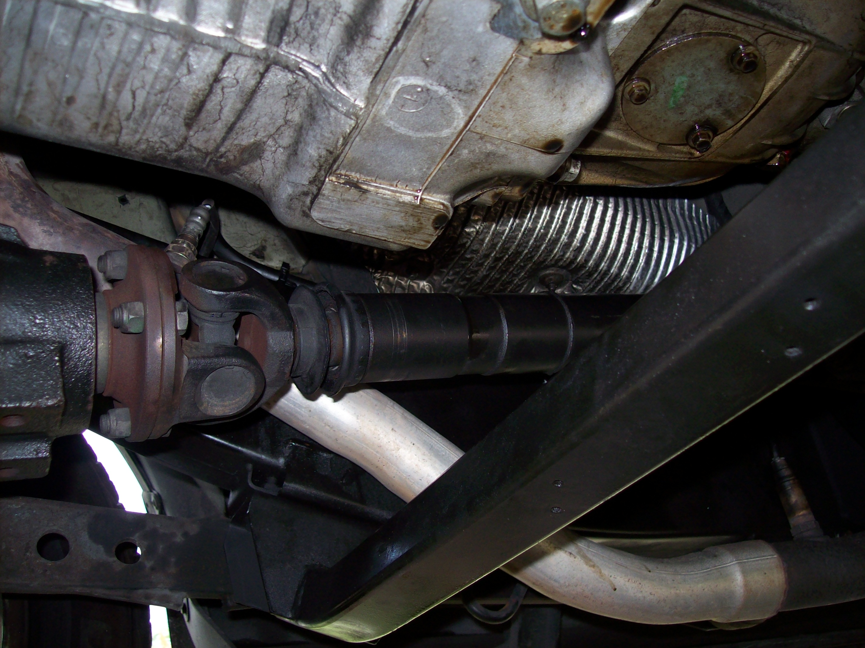

My 2004 D2 with 99000 miles has a broken boot on the front drive shaft. If this is anything like a cv joint i would assume rain and dirt entering there damages this. Could any one with experience with these drive shafts tell me a proper way to processed. Thanks

Here are pictures:

Those are your U-joints. Common failure. Replace before destruction !

If there are no grease fittings on each u-joint, it needs to be rebuilt or replaced before it fails and tales out your tranny.
How mechanical are you, you can rebuild it or buy a better designed one with the proper fittings from Bill Davis at Great Basins Rovers in Salt Lake City.

I'm pretty mechanical, but if the rebuild requires a machine to centerize it then I'm screwed. Although I do have a leigh available to me. I will look and feel soon although from looking at the picture it does look kind of dry. The truck is no vibrating or anything. I just saw this while changing the oxygen sensor. Some people sent links to the Gaiter Propshaft. From the post I'm guessing packing new grease and sealing it is a bad idea??? Great Basin Rovers has the reman serviceable drive shafts. The word serviceable catches my eye. They are $375. Couldn't you make the factory ones serviceable by drilling, tapping and adding the grease gun fitting?
