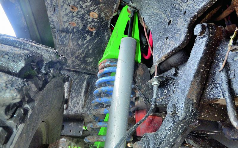

I've emailed RAC in the last few weeks asking for pics or install instructions but haven't heard back. Maybe I'll try again and reference this thread. I did find a bad video and a pic of one installed online, and it did allow me to see that it moves the front shock to the outside and rear of the coil spring, seems it should work fine? My other option is to look further at a P38, and see if the shock mounts can be removed and transferred to the Disco. Either way, the fact that the P38 did it inspires me to believe I can do it too
Not a great photo, but its slim pickins out there, lol
Not a great photo, but it's slim pickins out there, lol
Bad video:
https://images.app.goo.gl/5pRKJrCS48VvAdk2A
